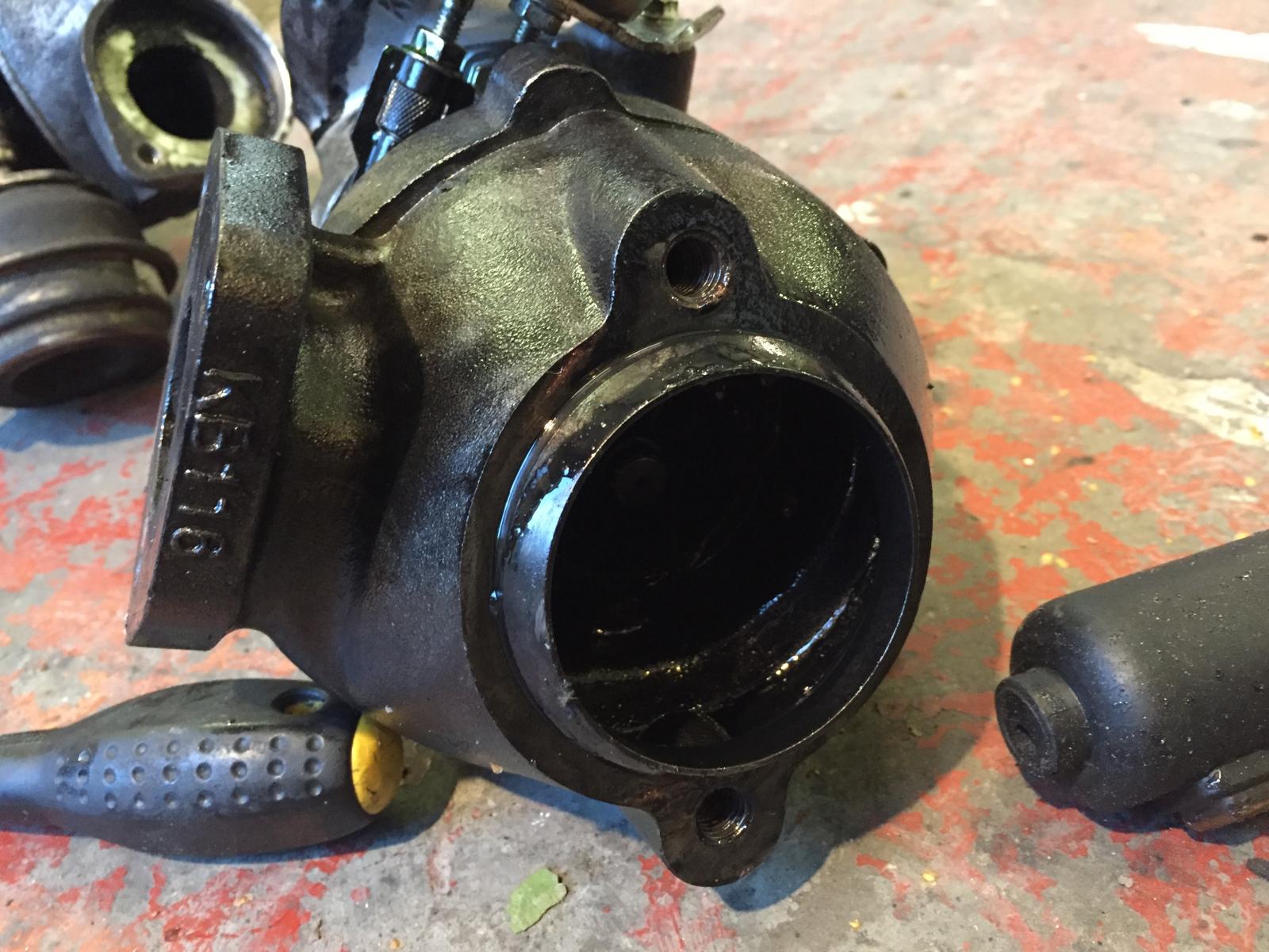

But deciding the continuation of white smoke may not be burn off but actually more seal leakage I took the down pipe off to see oil pissing out still.
I don't think the turbo is at fault and thinking its maybe oil pressure or something else?

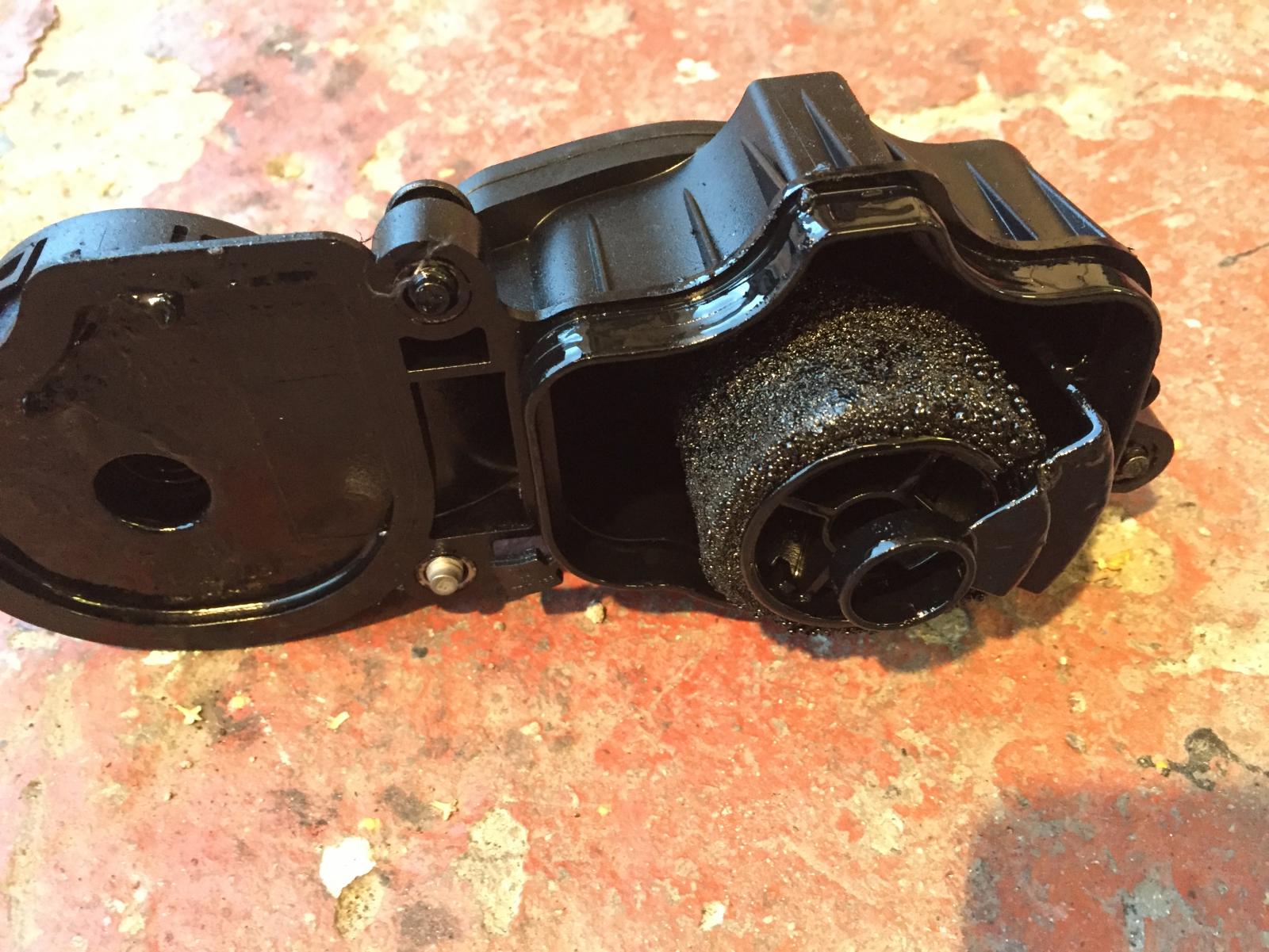

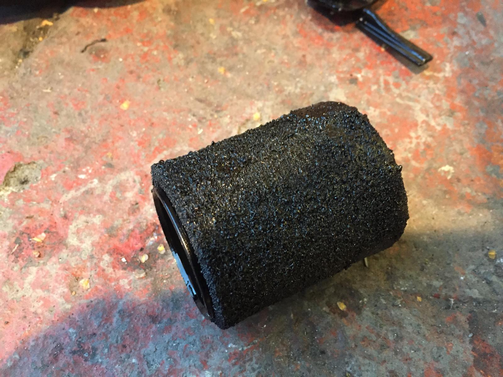

My high miles 530d was smoking like buggery on boost and leaking oil from the top of the dipstick tube, changing the breather filter stopped the oil climbing up the dipstick tube but didn't make a toss of difference to the smoke. Doesn't use oil at all.
Yeah that breather looks pretty bad.

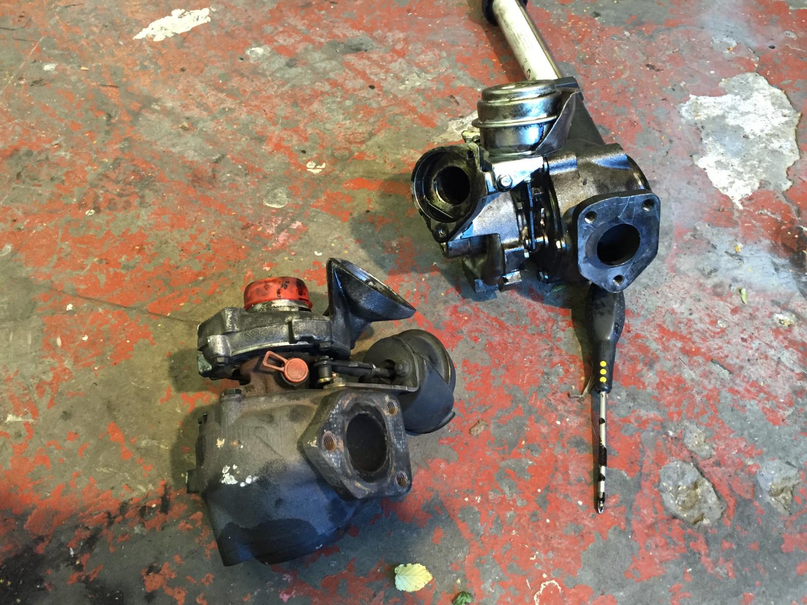

Has whatever killed the old turbo now killed the new turbo?
I've just done a Octavian for a customer.
I took the sump off, cleaned it,new oil supply and return pipe and I'm sure new turbo is now dead
Think he paid £78 for a cartridge off eBay too which doesn't help
No I don't think so, I think I might be right and there was nothing wrong with the original turbo and the whole thing was just pressurised and pushing oil past the seal.
The seal in a turbo is stainless steel not rubber.
Swap the turbos back over, quick blast with brake cleaner, cheeky refund?
Someone else said but if there is minimal play in the old turbo its probably fine, should at least get you a few quid back on eBay.

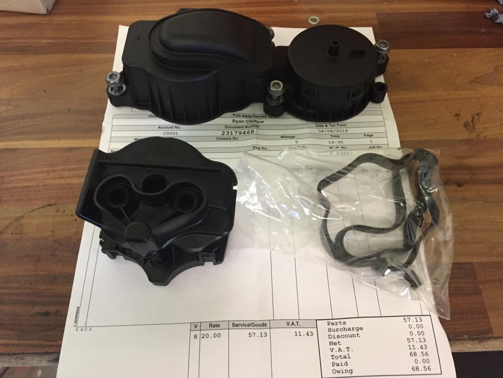

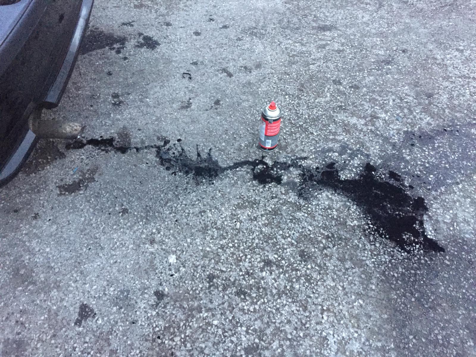

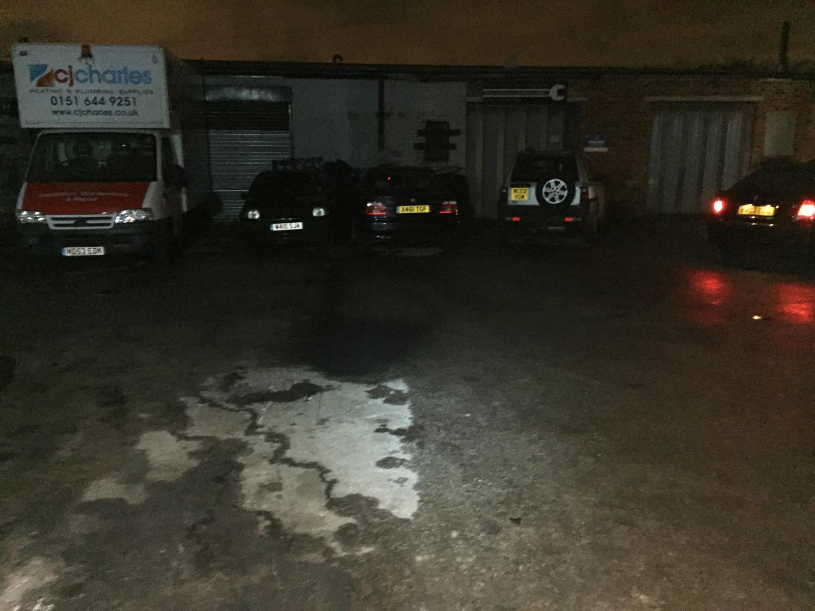

After leaving the dealership clutching my sore anus and hurried home, put the new turbo on and then put this new improved vortex separator on, I think it worked, as the symptoms had gone - but a blast up the road once the engine and exhaust system was red hot produced so much smoke I thought the car was on fire. Switching off I got out of the car shaking. Let it run for a bit more and took it again up the back road and frigging hell, I've NEVER seen so much smoke.
Parked the car as I was a bit worried. Went in other car to go to McDonald's and in the way back a thin mist hung over my garage area.

Reluctantly went back today, wipped off the daft aluminium under tray and unbolted the down pipe from turbo. It was bone dry and not filled with oil.

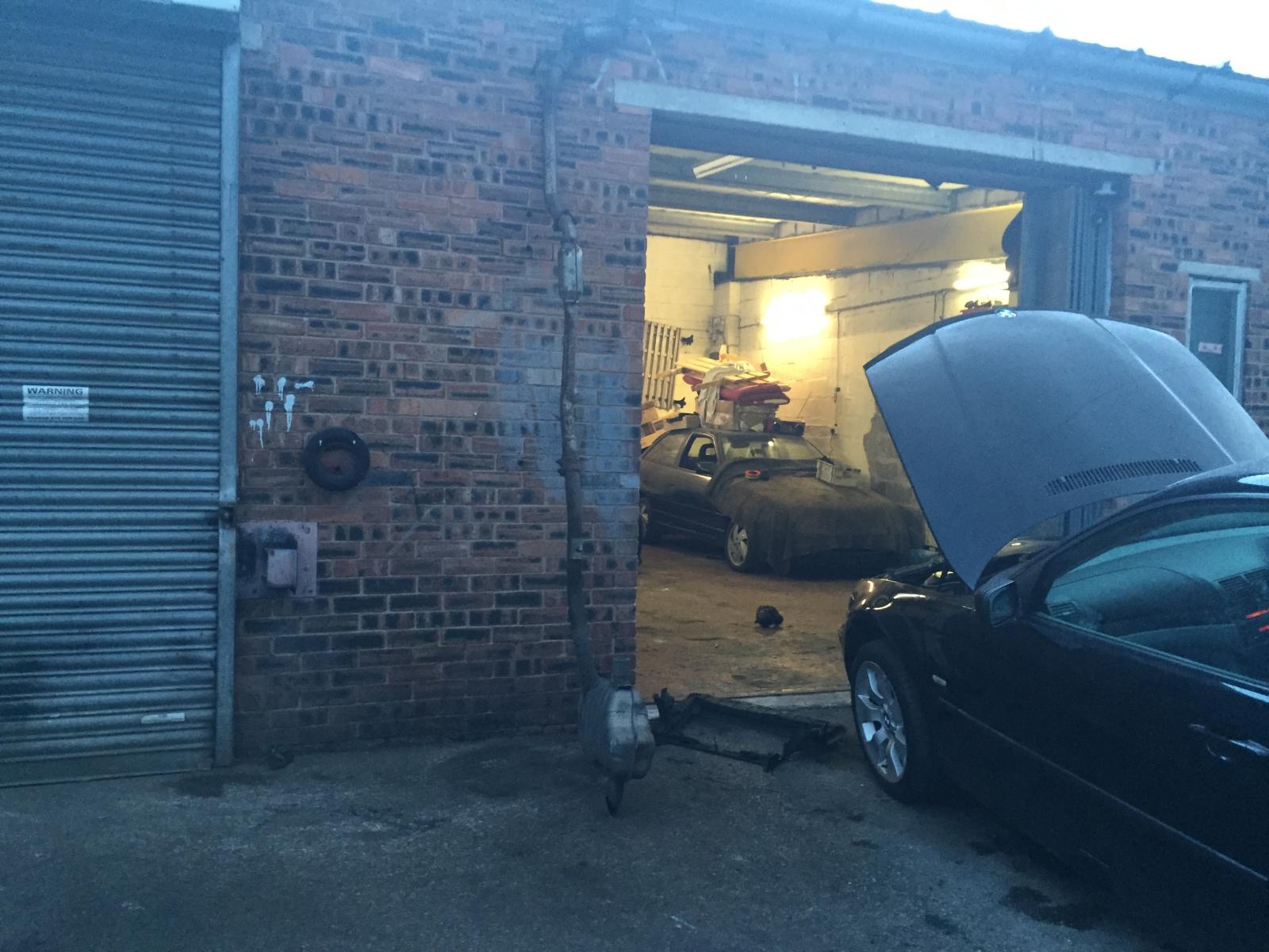

Took the whole exhaust system off (5 minute job!) and jet washed it through, no oil in it just tonnes of soot. Last nights exercise must've just slowly cooked the oil in the exhaust.
How long are exhausts? They're taller than a house!
Flushed the intercooler and put everything back together and apart from a load of black soot all over the floor and air it looks like the crankcase filter was the culprit. Not sure if the original turbo was knackered though.
Good news. The exhausts can really hide the oil in baffles etc though so don't worry if you get a bit more smoke when you drive it, just keep going till it stops.
The blocked crankcase breather causing smoking was a common problem on the rover 75 fitted with the bmw engine. Apparently Rover forgot to add the filter on the service list, think they are meant to be changed every 60k.
Yes, same with BMW. I found out the Land Rover filter is half the price of the BMW one. Oh well.

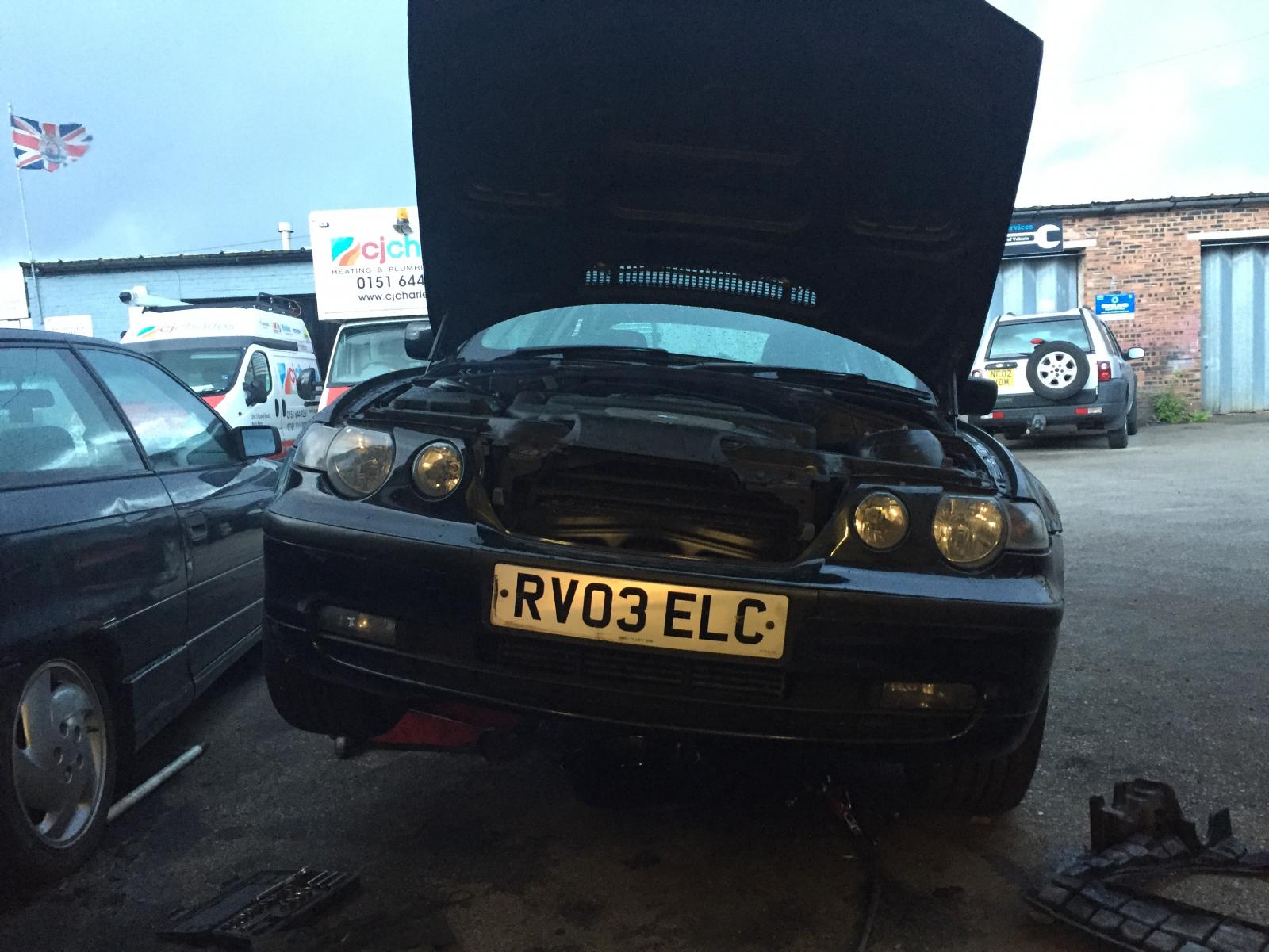

I know it's a boring BMW but I got it running and it's a nice little car! For all that is said of 'moderns' this is probably the easiest car I've worked on. Turbo out and back in in half an hour (after three goes)!
