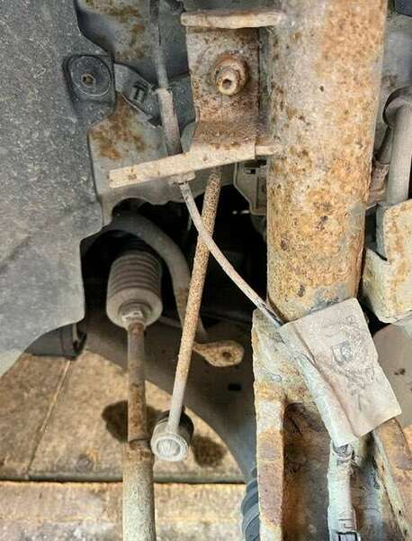

When the Mondeo arrived it was supplied with a pair of new front droplinks as there was some sort of rattle going on. The one on the other side seemed solid enough (but will get replaced anyway), so I wasn’t entirely sure if the ‘droplink rattle’ diagnosis was correct. Turns out it was, just not in the way I was expecting. This is what greeted me with the wheel off:
That would cause a rattle alright.
This didn’t look too clever either:
Goody gumdrops.

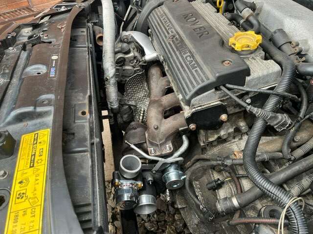

Substantial ZT progress:
Turbo fitted and all bolted up with oil feed/drain also done. Alternator bracket also refitted. Next up is a coolant flush and refill, and fill the engine with fresh oil.

All plumbed up. Colour coded-ish vac lines, 3mm in orange and 5mm in blue.
Took it for a test drive and a few things of note: there is loads of oil in the exhaust to burn off as evidenced by the blue/black smoke I was leaving behind me. It doesn’t smoke at all at idle, hot or cold, but under acceleration it’s like a WWII destroyer laying down its own personal fog bank. A second test drive saw a bit of a reduction in smoke, hopefully a few miles of thrash up the dual carriageway late one night will burn the rest of it out.
It also cuts the ignition at 5k rpm, which suggests to me that it is overboosting and hitting the limits of its fuelling. I’ve got a boost gauge to rig up and see exactly what it is doing. Right now the car is running with an aftermarket boost solenoid, so once the boost gauge is rigged up I’ll do a run with it still fitted, and then swapped for the stock boost solenoid. What I’d really like to see is the injector duty cycles but I don’t think my diagnostics machine can do that.
Its good to get it mobile again though, hopefully it’s not far now from being fit to use daily again.
This afternoon after the boost solenoid was replumbed I went for another test drive. On the first one the car felt flat and lifeless until 4.5k where it started to come alive, and then hit a wall at 5k where it felt like either fuel or ignition was being cut. Turns out the wastegate and pressure lines into the boost solenoid were the wrong way around, so the ECU wasn’t seeing any pressure from the MAP sensor until the BOV lifted way too early and suddenly it saw way too much and reacted accordingly.
