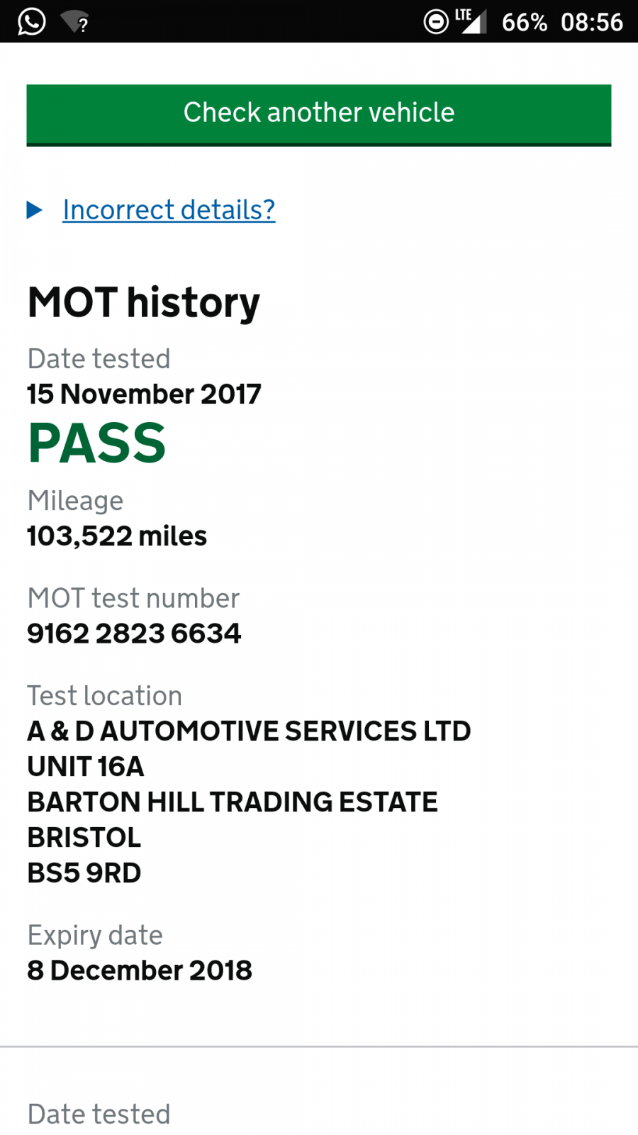

BOOM.
Although given my MOT prep consisted of throwing a fiver at the local Romanian car wash, attempting to clear the sunroof drains in the pissing rain, covering myself and the newly clean car in muddy handprints, giving up after doing one side and having a cup of tea, I reckon SiC deserves the credit here.
Woo! Great news. I don't know if I deserve any credit, its just a good car! Also I think previous owners have put a lot of care and attention in it.
Did A&D recognise the car?
If you ever get fed up with it and want to get rid, I'll happily buy it back. I genuinely miss that car.
Oh yeah, I got a 'don't worry, it'll be fine, Simon loved tinkering with this' when I dropped it off, and a 'oh bloody hell, what's he bought now' when I mentioned your MG. They actually sounded quite enthusiastic about it, mind.
On a related note, and given that the only thing that causes me more anxiety than finding a new garage is finding a new barber, I can thoroughly recommend A&D to anyone that lives in Bristol. For reasons I don't fully understand ('we missed them first time round and didn't mention it when we called you') they wanted to not charge me anything for changing my rear pads, and then refused to take more than £20...
