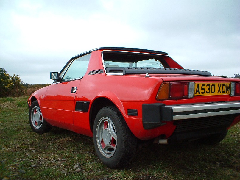

egg Posted April 8, 2016 Posted April 8, 2016 Here was mine. No longer with us, unfortunately. Sticking front caliper, and a trip to a specialist in Brighton revealed it was full of filler....I flogged it on. Barry Cade and richardmorris 2
