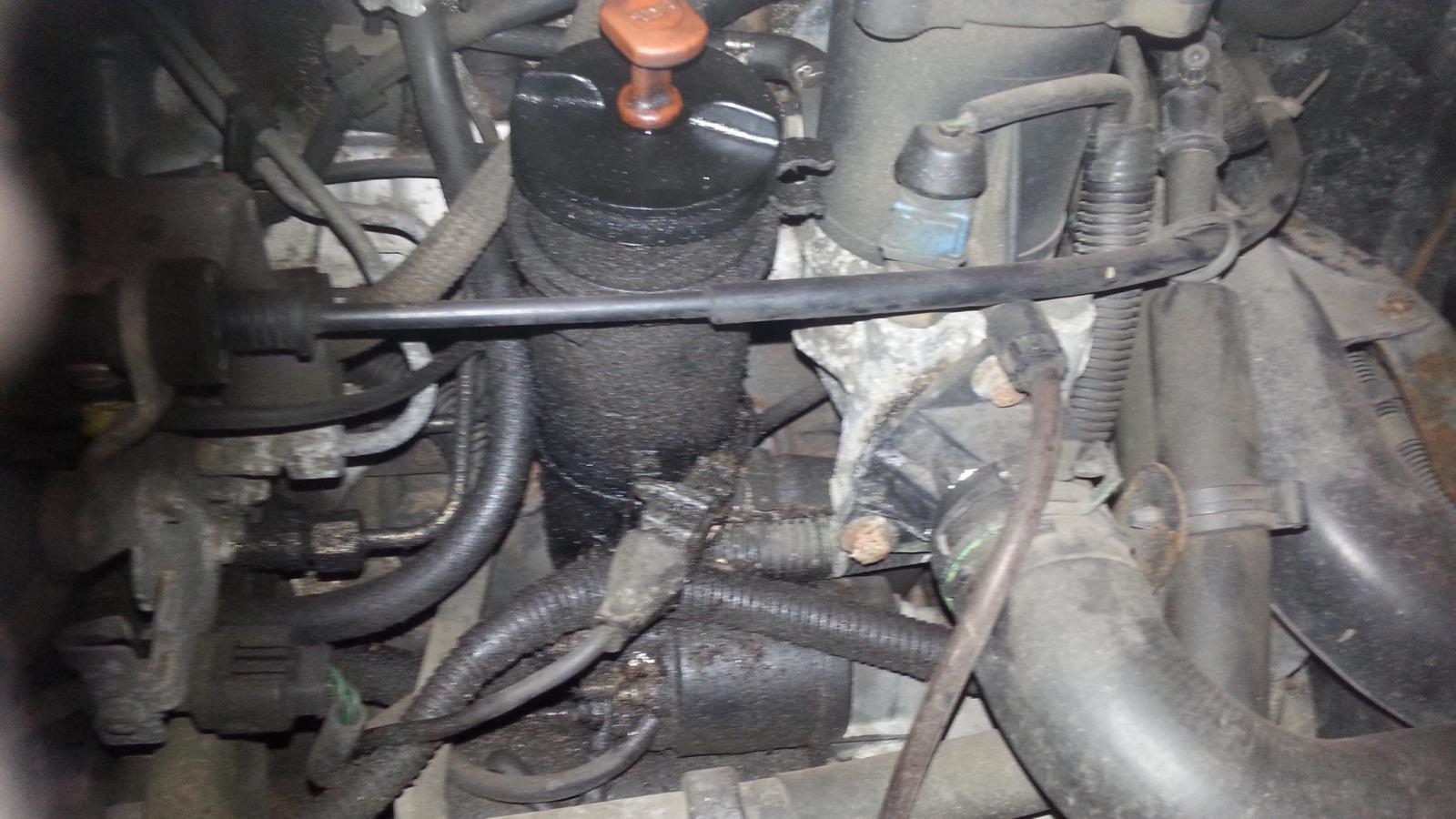

Looking from the top.
Starter unbolted and hanging from its wires. Will's locking tool (threaded bar) poking through into the flywheel.

What. A. Feckin'. Eeeeejit. I'd forgotten how high up the block the starter sits on these engies, so I was looking directly below it and just didn't twig. It turns over nicely with a wire direct from the battery!
