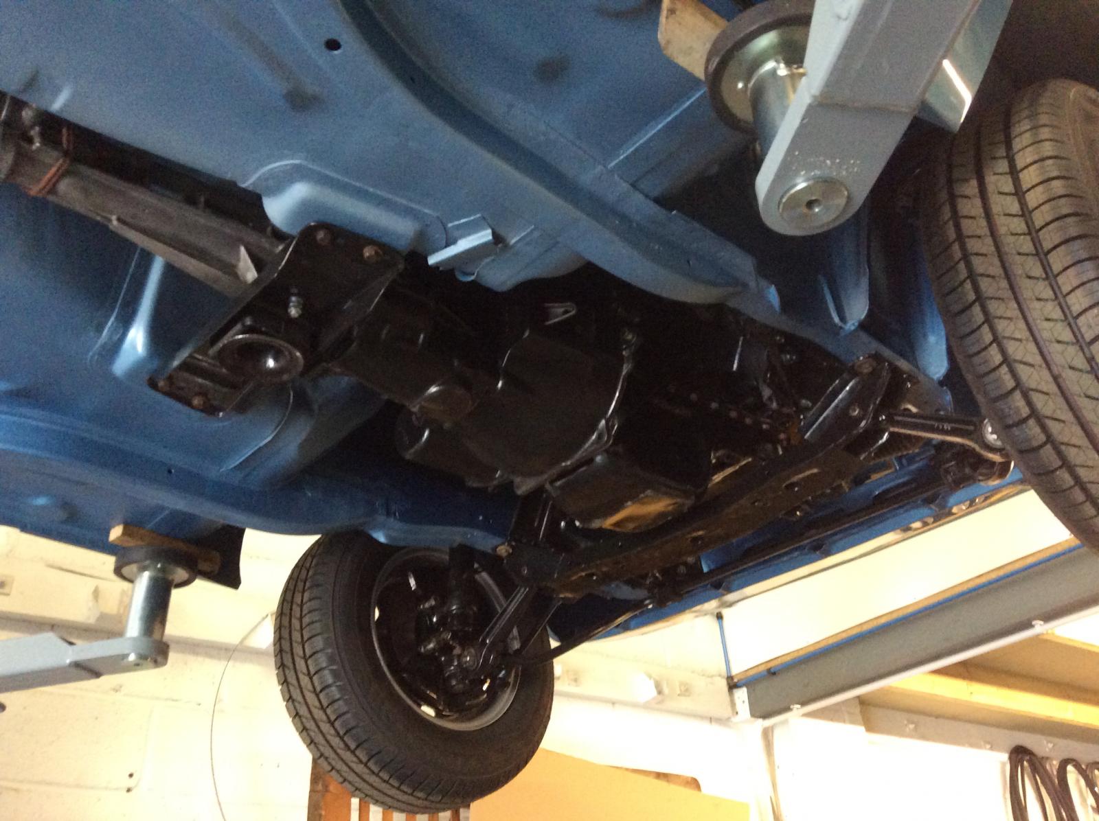

I got down there and the cars up on the ramp having the gearbox X member fettled. Made getting beauty pics a bit difficult. However instead I’ve managed to get a few naughty pics of the Capri’s nether regions which might actually be a bit more interesting as it’s something you won’t often see. And I guarantee you won’t see a Capri’s undercarriage quite as clean and fresh as this one!
Firstly is the engine sitting in it’s beautiful blue bay. The pics a bit dark unfortunately but it looks bloody brilliant!
Going up...
Underside of the engine and gearbox area. With all the front lower suspension bits, X member etc.
View of the underside from the back axle.
It looks absolutely stunning underneath!
The finish is exactly how I wanted it done, very very close to a factory finish, but with better protection.
I think the blue paintwork against the satin black of the running gear looks superb too, really smart and professional.
