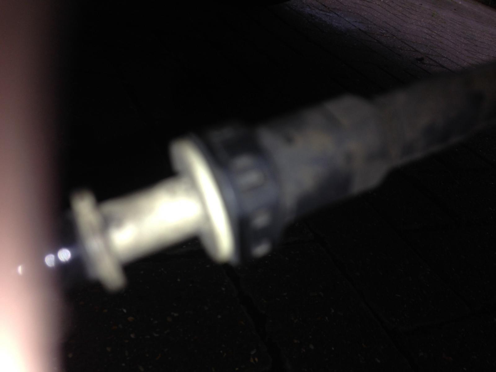

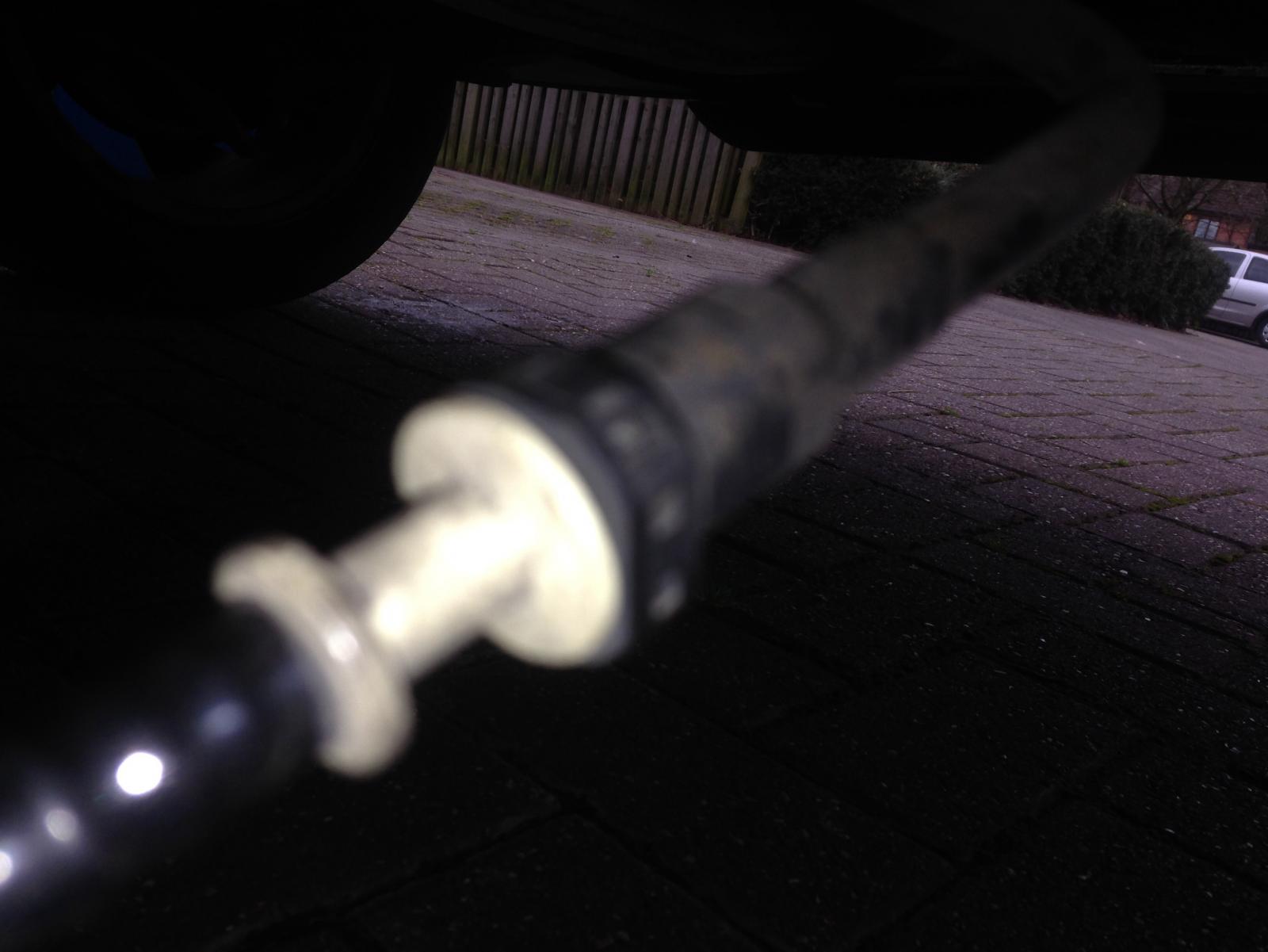

Halfway down the car the pipe is joined and I can't work out how to separate it, all the other connections have quick release snap connections, not this one!post-17414-0-07572500-1454502738_thumb.jpg
As I'm a heavy handed oaf and usually cause more problems than I fix,can anyone advise how this might come apart.
isn't it just another snap connection? You squeeze the black bit??
Failing that refer to above.....
Doesn't appear to unscrew,although it does spin freely.
It could be anther snap connector,it just looks different to all the others. And I've got previous for breaking things like this, might try a little squeeze with mole grips WCPGW?
Its a quick release connector , on the female part the end is kind of D shaped and there will be a 3-4mm by 10mm button you need to press in
thanks TwoSmoke, but I was already trying the mole grip gentle squeeze method!
And I don't seem to have broken anything else- yet.
