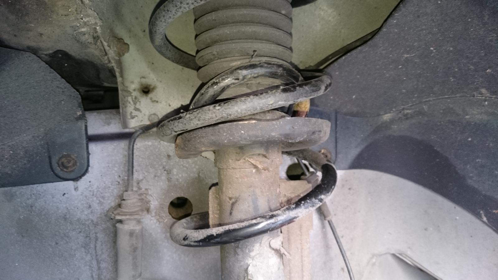

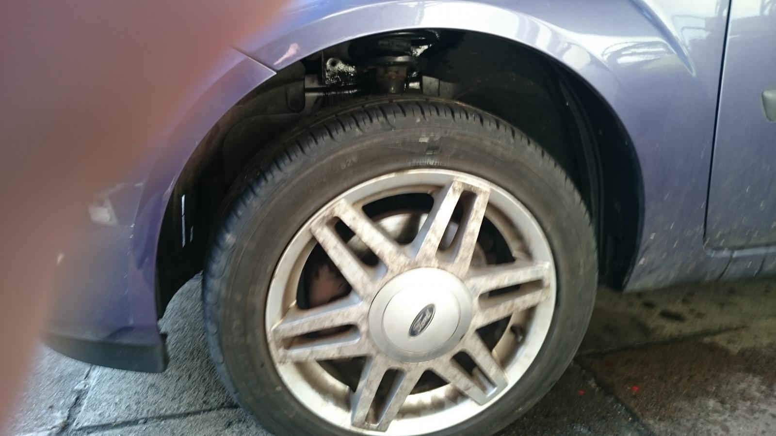

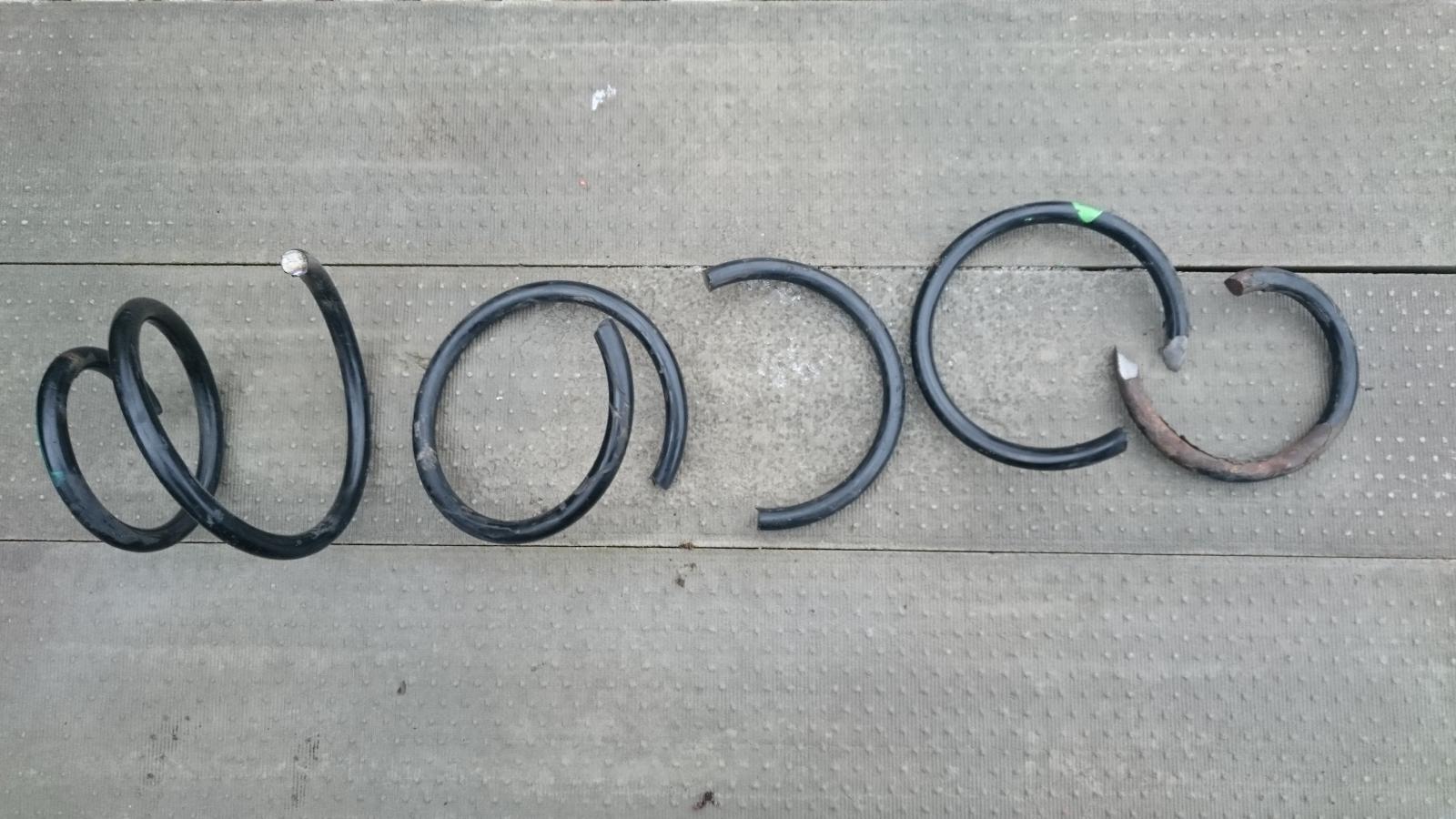

Banger Kenny Posted February 3, 2016 Posted February 3, 2016 Used a 18v Ryobi job borrowed from my Brother to use on another Brothers Fiesta snapped coil spring that he managed to get to the dark side of Morrisons car park before wondering why it sounded funny..Ideal for impromptu "get-u-home slamming"BeforeAfter (finger not to scale)Also great for cutting to fit recycle binSadly, I had to give it back to him. Battery life did what I wanted and had plenty of life left.I want one.
