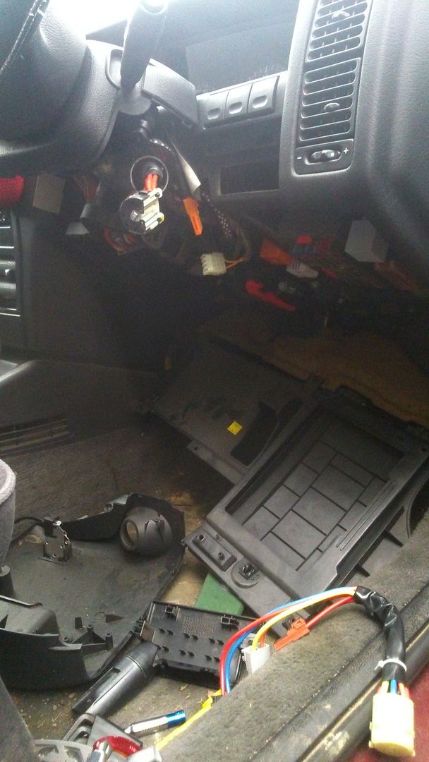

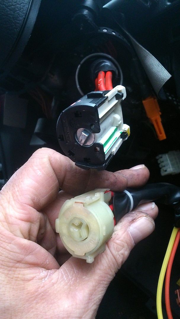

Ha ha, unbelievable. I bought the replacement part that Dink suggested above, and decided in my ultimate wisdom to strip the whole ignition down at lunchtime (30 mins) at work. I tend towards impulsiveness.
This resulted in much panic and "what the fuck am I doing" scenarios.
Especially when I found that it was the wrong part.
So back together it all went, and successfully too, apart from the bottom cowling needing some clips and of course the fan/HRW still not functioning.
