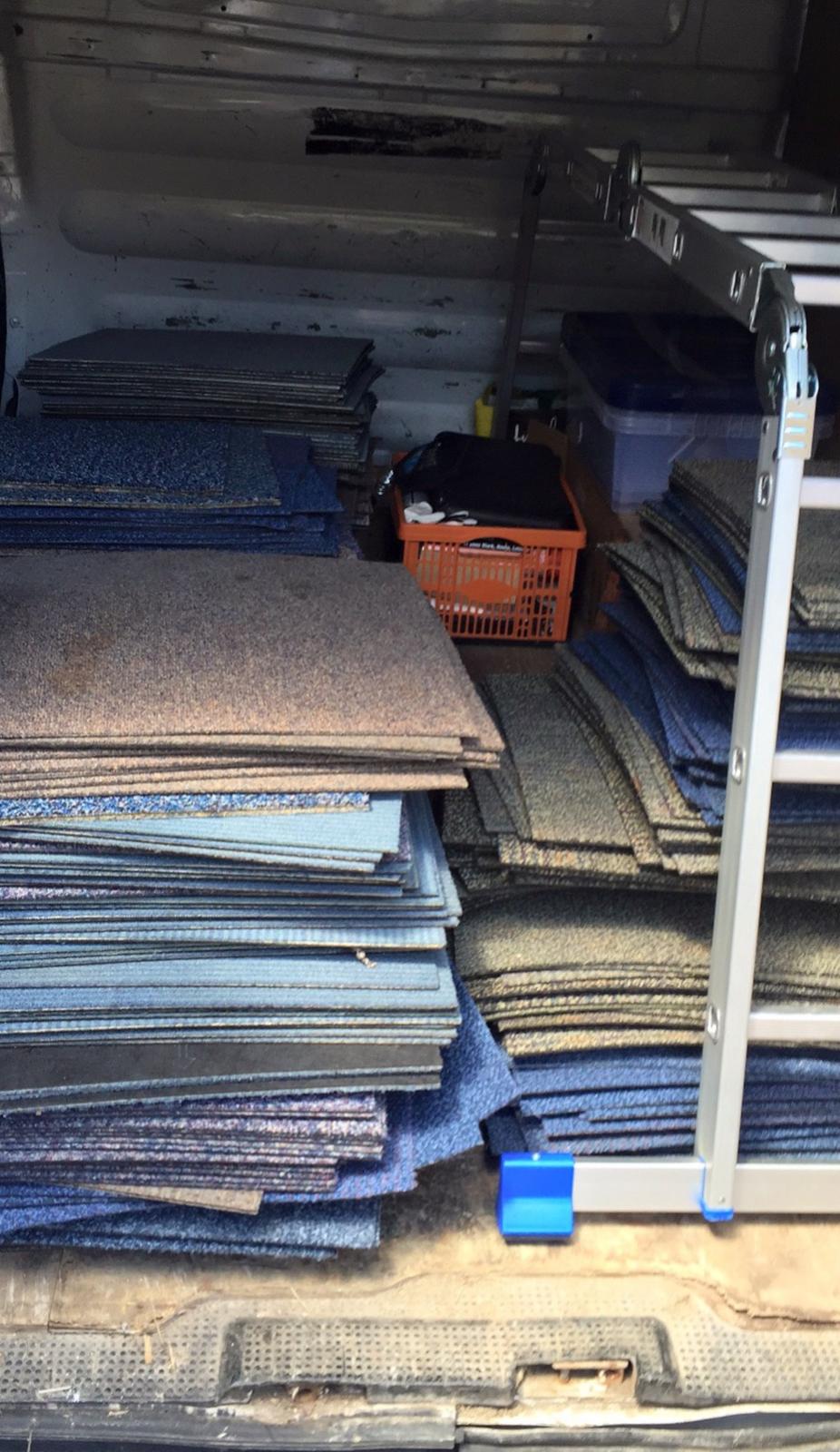

Van doing what it does (no not breaking down!)
Anyone need any slightly* used carpet tiles?
My garage floor would love them :)

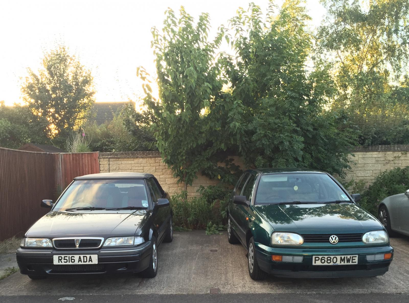

Scenic has gone to a new home but I'll probably see it quite often - still soldiering on at nearly 155k miles :)
216 Cabriolet replaced it but is being sold next week - I'm buying a MK3 Golf automatic from a certain shiter so that my other half can finally resume learning to drive!

Golf is here and is going well so far but could do with a bit of maintenance to be at its best
Water pump I think has noisy bearings so will be replaced along with the aux belt that drives it - might change the timing belt too although I'll have a nose through the paperwork to see when it was last changed
Rear wheel bearing advisory on the last MoT and I think it has a slight rumble - will change both because they're cheap and easy
Radiator hoses are 20 years old and a bit crusty so will go when I do the water pump
Rocker cover gasket is weeping
Front wing on the drivers side is rotten, not sure whether I'll find a good used one in the right colour or paint a new one (less than £30 for new!)
Rear tyres have seen better days but will do for now
Glovebox handle is AWOL
Sounds bad but the parts for these are insanely cheap and they're piss easy to work on :). Will service it and put some kind of rustproofing gunk in the sills too!
