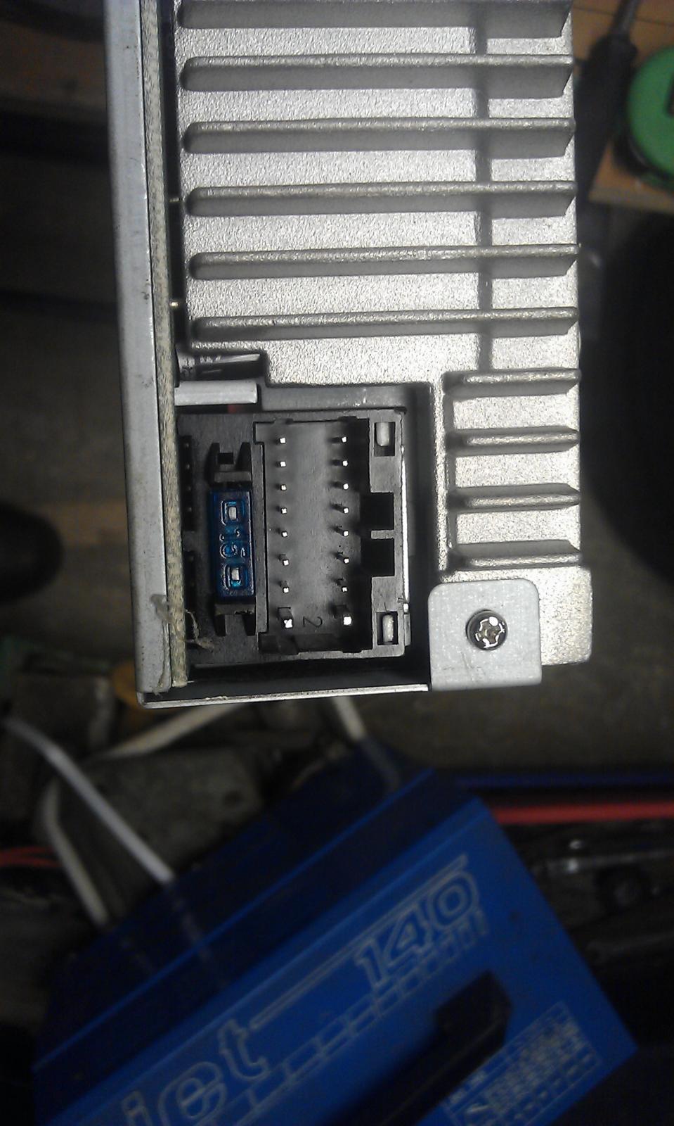

ruffgeezer Posted December 23, 2015 Posted December 23, 2015 So I was blanket bidding on a bunch of DAB radios on ebay, without much success but managed to end up with this one; The "scuffed screen" was soon fixed with a bit of T-Cut, however the box it came with was bereft of a wiring loom, and the seller is now "out of the country until March". I'm a little pissed off, I cannot test the unit until I find one, and the only place that lists them wants a tenner plus postage for one, which is nearly the same as I paid for the flippin' thing in the first place. Soooooo, first port of call, does anyone recognise this socket to any other manufacturer? I've tried a Kenwood and Sony harness as well as an older Pioneer. I'll also need an aerial eventually, I think at this rate I could have bought the cunting thing new for similar money as this bastard is going to cost!
bub2006 Posted December 23, 2015 Posted December 23, 2015 Looks the same as my sendai headunit in my van.

Eddie Honda Posted December 24, 2015 Posted December 24, 2015 Soooooo, first port of call, does anyone recognise this socket to any other manufacturer? 16 pin Pioneer. Apparently* there are at least 6 different Pioneer versions. I even saw a picture of the same in reverse (with the two fat pins at t'other end of the block, so watch out) The one you want is this: http://www.aliexpress.com/store/product/JSTMAX-car-DVD-Radio-stereo-ISO-cable-16-pin-Adapter-for-Pioneer-DEH-P-series-select/1760182_32407908764.html Fiver delivered on the Chinese place. Give it four weeks! Here's another: http://www.ebay.com/itm/NEW-PIONEER-16-PIN-CAR-CD-PLAYER-WIRE-WIRING-HARNESS-2-/280591473629 At least that should point you in the right direction to finding one. Good luck. *fat bloke down the internet says Conrad D. Conelrad and chaseracer 2
Dave_Q Posted December 24, 2015 Posted December 24, 2015 This looks about right as well, have purchased from this seller before so can recommend. Eddie Honda 1

Timewaster Posted December 26, 2015 Posted December 26, 2015 A lead will certainly be more than the unit is worth.Also, as mentioned before there are loads of variations in the pioneer plugs. I once had a Sony unit that was free because the lead was missing and I opened it up - to my surprise the board was marked which pin was which so I soldered on to the pins and filled the socket with silicone.For a shite bodge it worked fine. I doubt you will be so lucky.(With the board markings I mean).
