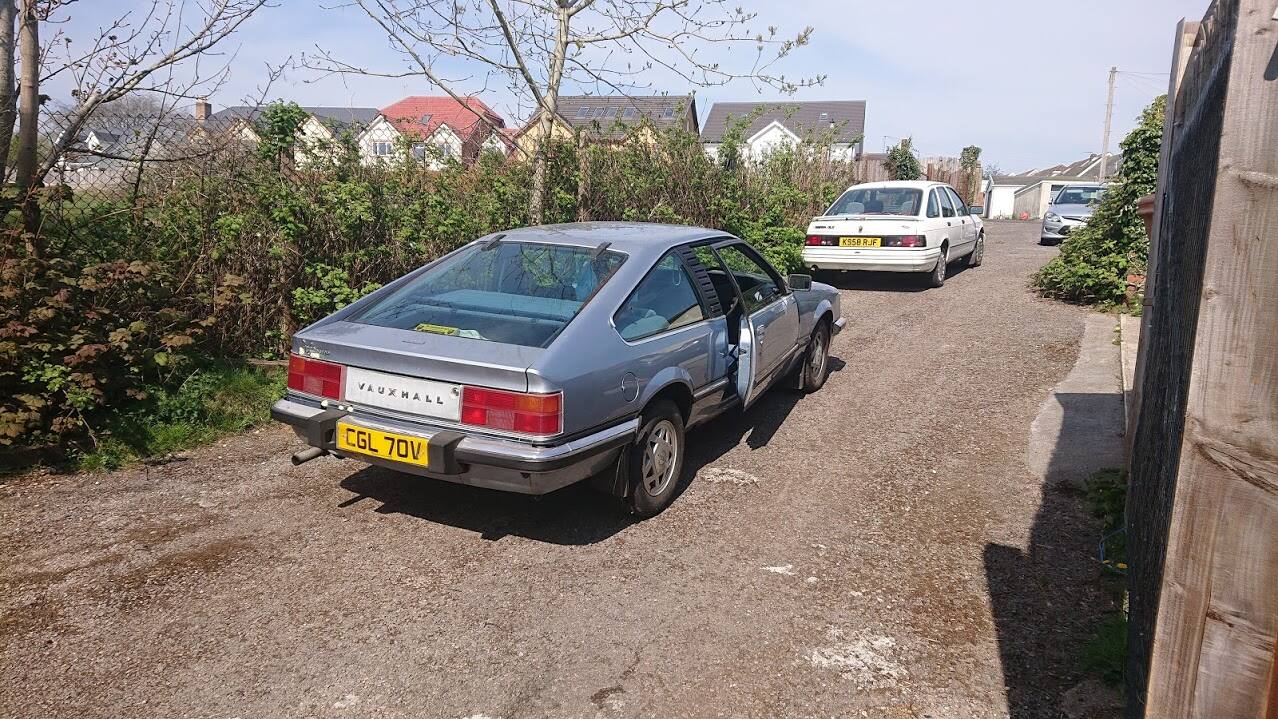

Did a bit of work on the Royale today aided by Chester the dog. Still haven't got around to welding it yet (over a year!)-but when moving it this morning one of the rear calipers was sticking, so stripped it down and gave it a clean. You can see the hole still present and my helper. The bluey stuff is Vactan.

As i had done a bit of work on the Senator-I thought it only fair to do a bit on the Royale. This has been off the road for a year waiting for me to weld two patches. Had a problem with the brakes a few months ago-car was up on ramps for a few months-went to move it and brake pedal went to the floor. Reservoir was empty. No visible leaks so topped it up-suspect leaking master cylinder. Started it today-always fires up immediately-and brakes working as normal. Took it for a spin up the private lane and remembered how much more powerful and quicker it is than the Senator.
Going to practice my welding tomorrow-need to get it back on the road.
Here's some pictures from this morning.
