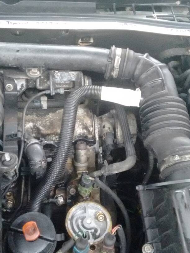

First off was to replace the breather pipe.
The previous repair had not held and was venting oil fumes all over the engine bay.
After a dig around in my shed I found some conduit that was roughly the right size.
Sliced the end and tucked it into the intake hose then used gaffer tape to seal it.

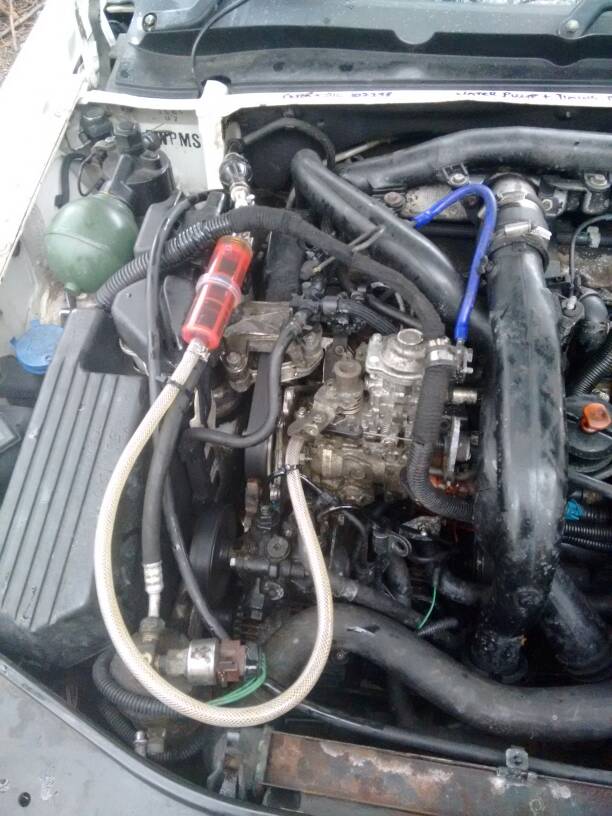

Received proper fuel hose clips so sorted out the fuel filter. Decided to simplify it at the same time to minimise any air leaks.
Clear hose shows no air bubbles so a bit of a result.

The standard filter has 5-10 micron media, the strainer in the in-line filter you've installed is something like 125 microns. OK as a temporary fix but you need to put a proper filter in there.
It's just temp filter for next 300 miles before putting back the metal filter. I just wanted to see if any rubbish was coming through.
No reason, it was the second pipe before and I didn't cut it down. Once I have run a tank through and the clear filter is fine, will sort it out properly

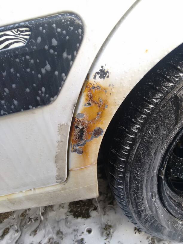

Rust on the door shut needs doing. Will have a look when it is warmer.

That rear arch needs the outer skin cutting off and the metal behind sorting out.  When I repaired it I really needed to remove a lot more than I did.  It's something of a moisture trap behind and difficult to sort out, a known weakness on the estates I'm told.  Shouldn't need to buy screws for the front plate, it's velcroed on but the velcro is held to the bumper with screws, just use those, they should be long enough.

Maybe using bits of an Alfa Romeo door as a patch wasn't my best idea to prevent rust from returning ;)
Asking for big trouble, running without a proper filter. I use those in place of a tank strainer, before the main filter.
The smaller the particle, the more damage it does. Would be a shame to see the car scrapped because of borked IP and injectors.

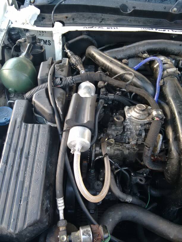

BMW filter is back in place. Will do update pics.
Regards to the rust patch is it likely to be MOT failz? Both sides need doing really.
Strictly speaking probably "yes", though a roll of that white pound shop gaffa tape might wing you a pass...
Mot not till December, but something to bear in mind.

They all rust at that seam, estates particularly, because they're practically coachbuilt from part-finished berline shells.
What the thinking with this filter, is it bigger? I often subsititute odd filter heads for something Bosch so cheap screw-on filters can be used, of varying sizes.
Yes, I've just binned the standard, leak-prone filter in my Caddy for a Bosch spin-on, £4 filters instead of £10 filters.
I think the BMW one is what chompy used to bypass the standard plastic XUD filter housing, it's like a very posh in-line filter.
Yeah, those R-clips are pretty shonky. I likeez big filters, preferably siamesed and with heated ports. Part of me would like a see-thru bowl as part of the dashboard instrumentation - not impossible, especially on the A6 which has its fuel supply pipes routed inside the passenger compartment.

Updated with filter pics.
