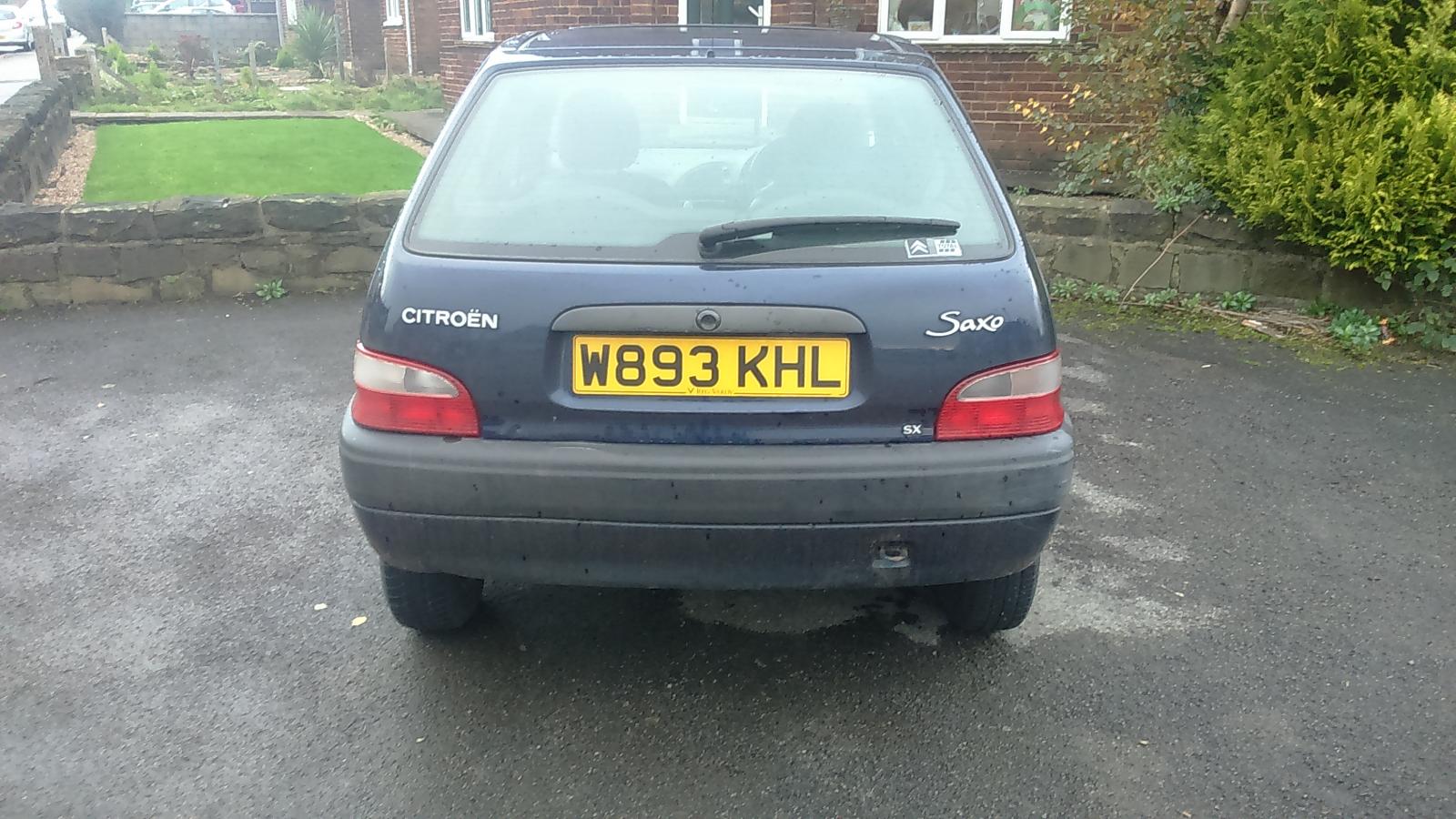

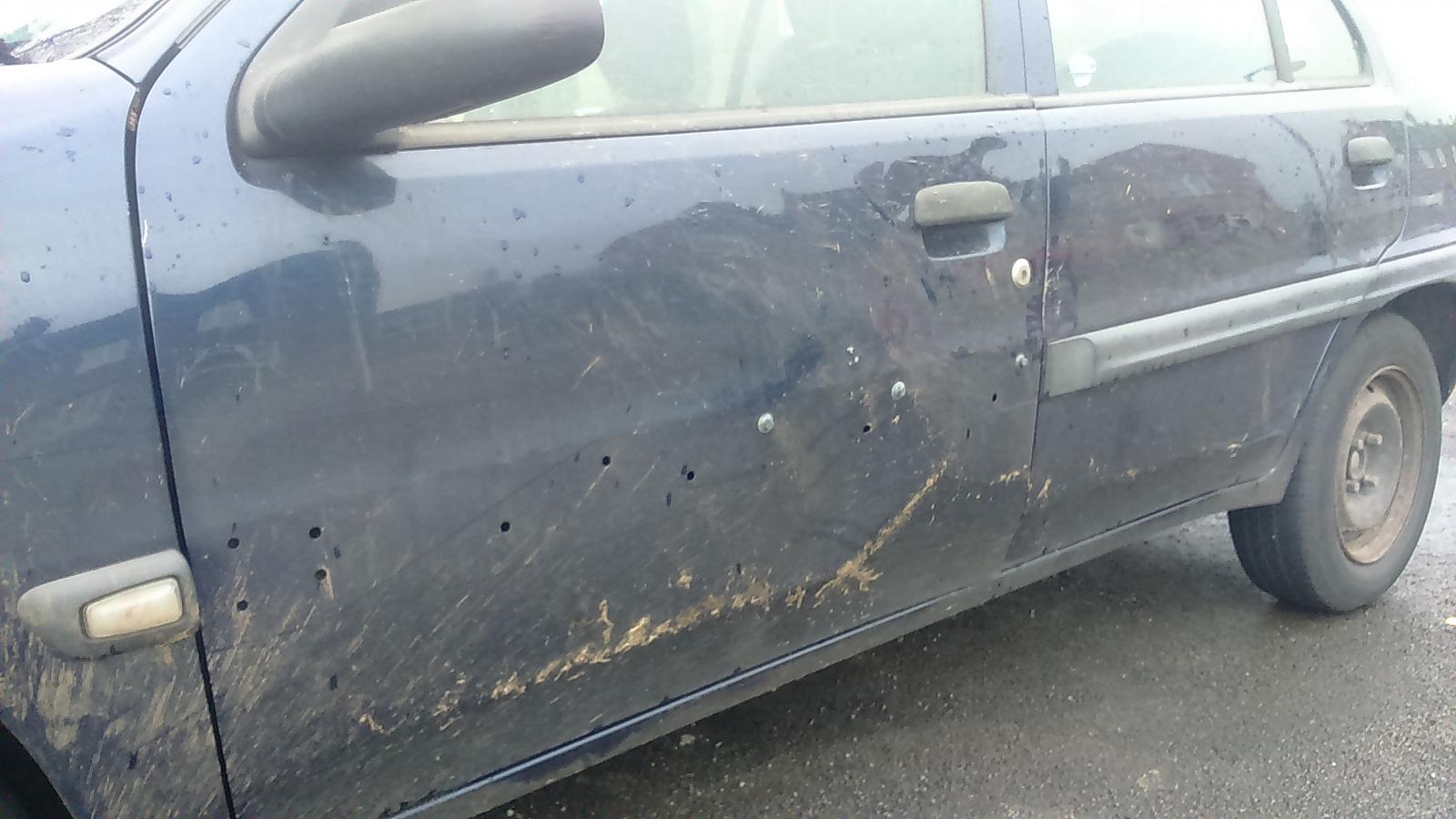

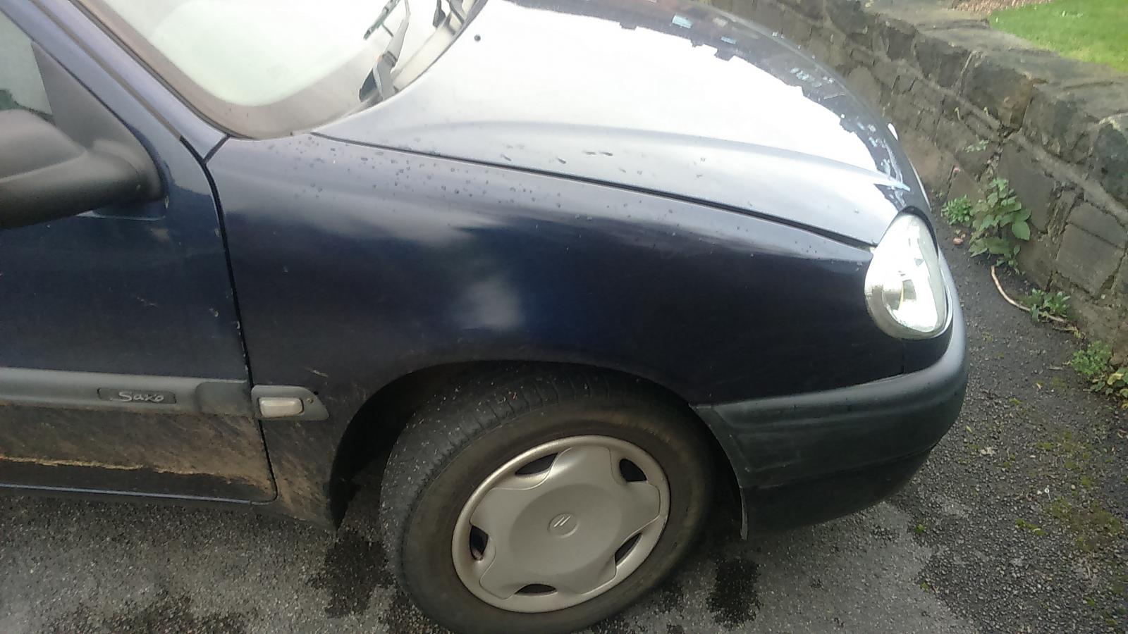

Right folks. Acquired this the other day. Thought I'd post pics for anyone perverted enough to actually be interested. Saxo 1.5d in sx flavour so has got leccy windows,partial central locking, sunroof,front fogs but no switch and comfy seats. Low mileage for its age but living where I live and bad weather means cars get filthy quick. Obligatory wheel trim missing,trim missing on passenger door and both passenger doors dented. Clean underneath and under bonnet though. Sunroof don't leak and central locking don't work on passenger door sometimes. Idle issue which I'm trying to sort out. It starts and idles ok then starts get lumpy after so long and does it round town too. If I switch it off then start again it be fine for a short while. Starts first turn with one glowplug cycle so don't think it's too bad. Reg vardy plates and stickers also still present. Looks like it's had a knock at some point as front wing is flat. Mot till may also.
