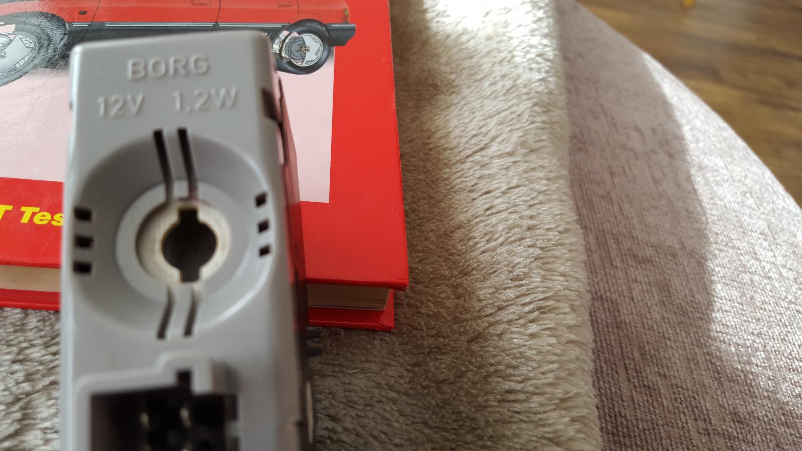

Is the clock just dim and invisible at night. I bought a replacement clock but only changed the bulb over in the end.
Start by prising the wooden trim out with a flat blade at the passenger door end. Just pops out and clicks back in! A 5 minute job that actually took me less for the first time ever and I didn't break anything !!
Yep, the clock readout is very dim indeed. Cool, I will try that tomorrow.

The clock can be swapped inside five minutes as Tam explained. I think you only needed the little bulb to brighten yours up, but the whole unit is so light I sent it anyway.

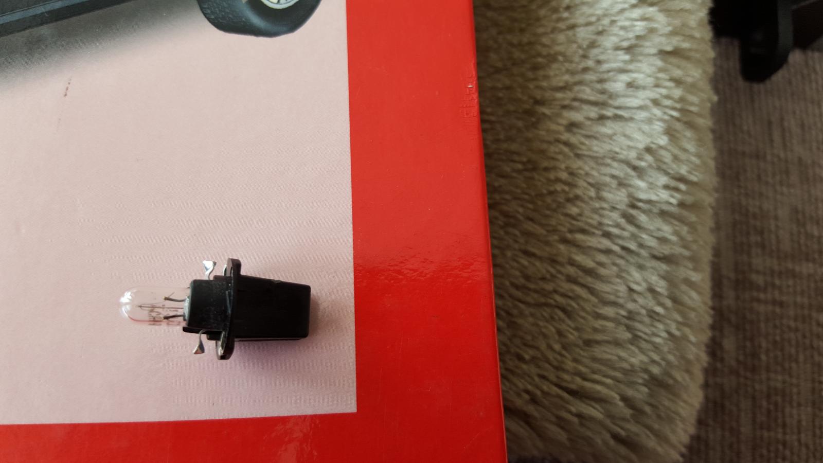

Fitted Joe's replacement bulb and then the clock which made no difference. Can you get new bulbs and holders?
Must be able to get the bulbs there just a twist in dashboard bulbs.  See them on ebay but not sure if wattage and technical stuff that I know bugger all about is important  :-(

Maybe your feed to the bulb is faulty (turns off when you put sidelights on).
Failing that, JohnK will have a known good clock in this white breaker when he comes to collect it.
No worries guys, it isn't vital. I can see the time but it is faint.
That would be handy Richard, has to be worth a go as I doubt it will b e pricey.
Pretty sure you will just need a bulb then. It's a small inconvenience but surprisingly satisfying when fixed  :-D
