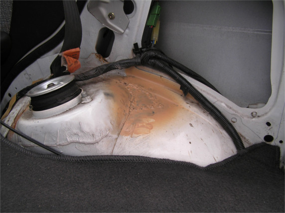

mouseflakes Posted November 11, 2015 Author Posted November 11, 2015 In response to Reg Hirst's well-placed words of encouragement to us all on the Grumpy Bollocks thread, I thought I'd add an update to this thread. It's not very exciting. A few weeks back I set to rust-proofing the wheel arches on the Justy as these seem to be the most obvious weak points on these cars. More on that later. Here it's plain to see why the rear wheel tubs breed rust. It looks like the designers just kept adding small panels until all the gaps were filled. The panels are even made with nice, curled-back edges enticing the water to nestle in behind them no doubt. I sprayed any patches of surface rust with a bit of No1 Rust Beater and then went at it all with that there Bilt Hamber stuff. I'm steering away from taking the welder to any of this car yet. It's got a long test and I'd rather enjoy it as it is without making the inside smell of grinding disc dust and melted carpet from the outset. Front arches hid a couple of unpleasant surprises. One was the hole in this 'gusset' (sorry). Mind, the photo also shows how clean the A posts are - right down to the bottom. Nice. A couple of the old MOT tests include an advisory about 'damage' (not rust) to the O/S front of the car. I couldn't find any evidence until I saw this - looks like a hole has been patched in the inner wing. I can't imagine it having rusted out though - nothing else on the car would suggest a rust hole this big. Maybe the inner wing was torn or punctured here somehow? Anyway, I think this patch explains why the advisory disappears from later tests. The seam sealer and sticker do a job of disguising it under the bonnet. More wheel arch revelations later... Lacquer Peel, Alexg, For Fiats Sake and 9 others 12

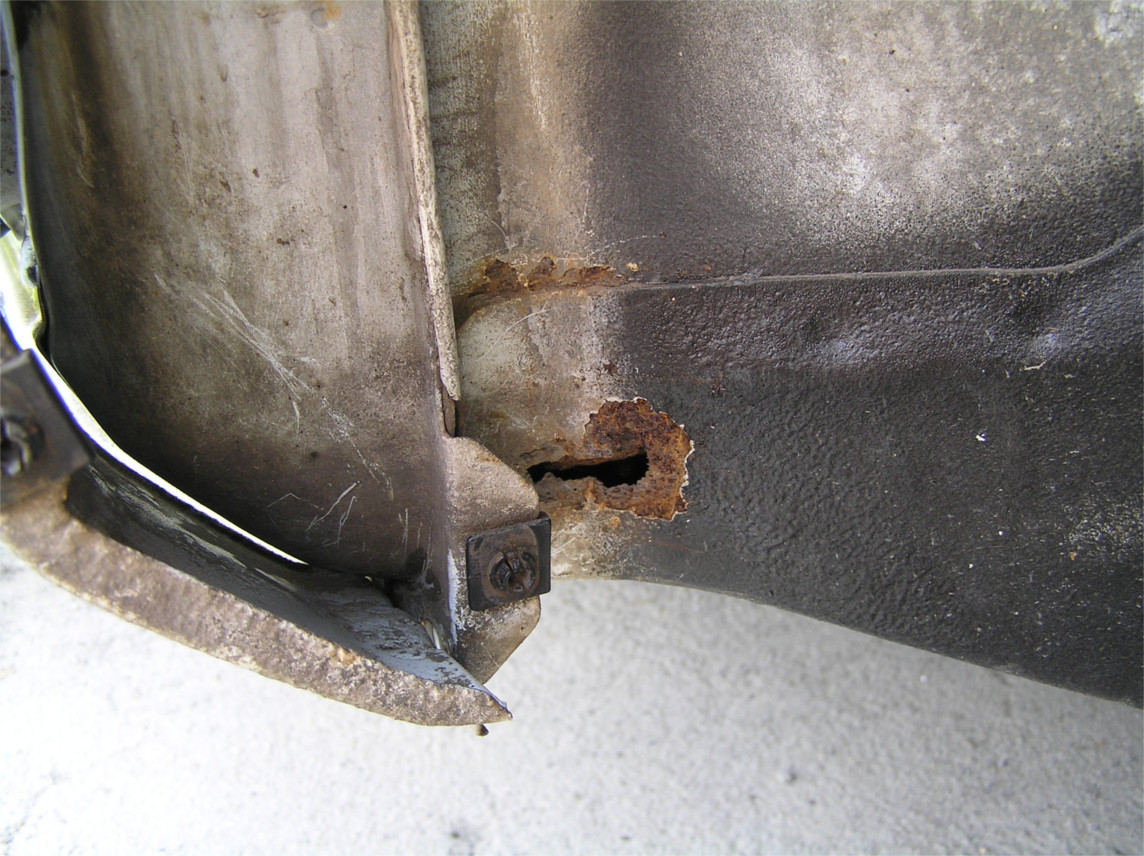

mouseflakes Posted November 13, 2015 Author Posted November 13, 2015 I was a bit bothered to find this crumby little welded patch. It felt very flimsy and the steel around this area seems quite thin. This is the first thing I'll tackle if I still have the car after the winter. All that thick black goo was already on there. It seems it's (another) weak point on the Justy. There are a few photos on the web showing the same (some even upside down like this one)... The 'rear' side of the seam at the bottoms of the sills was a bit flaky, but the steel behind that skin was solid. I gave it a coating of that Bilt Hamler stuff. I'll fill the insides of the sills and the rear arches with the spray thing they do. Hopefully that'll keep it solid for a while yet. Jim Bell 1
Station Posted November 13, 2015 Posted November 13, 2015 Expect to find more bits of rust! That bit around the steering arm went on mine as well. The under seal hid loads, it was holding seat belt mounts in. Also pray the carb doesn't give up, they're a nightmare to tune once they play up. Looks very clean though.I have an owners manual somewhere. And a genuine roof rack.

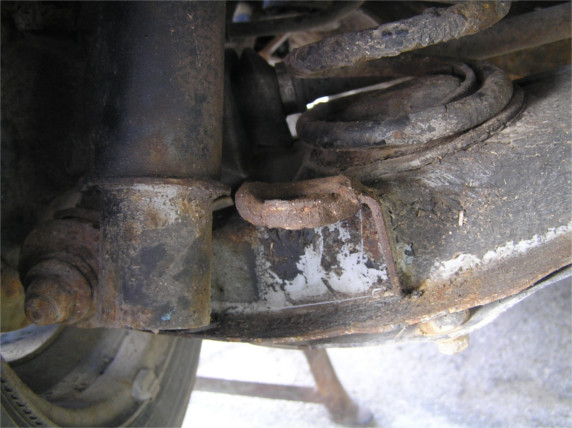

mouseflakes Posted March 19, 2016 Author Posted March 19, 2016 The bracket that holds the offside end of the rear anti roll bar has snapped on my Justy. I plan to weld it back onto the lower wishbone, but having taken it off I've found the drop link thingy is virtually welded to the snapped bracket with rust. Until I can separate the parts to make the welding job easier, I've taken the entire ARB off the car. Question: Would it pass an MOT with the ARB removed? I've had a few cars where the model has been available both with and without an ARB, so I would have thought it's okay not to have it. You can see from the photo, this isn't one of those set-ups where the ARB contributes to the suspension geometry - it's loosely coupled through the little drop link doobry. I didn't detect any change in the handling after it snapped - just a horrible clonking noise as the loose end rattled about. UltraWomble and anonymous user 2
Lacquer Peel Posted March 19, 2016 Posted March 19, 2016 I'm not sure, my friend removed his Mitsubishi Challenger's anti-roll bars and it failed the MOT for missing ARBs. Would they even know a Subaru Justy is supposed to have a rear ARB?
mat_the_cat Posted March 19, 2016 Posted March 19, 2016 I think the fail criteria is if an ARB has been obviously removed. That said, my Stellar went through two MOTs with the front ARB missing, and nothing was mentioned so a lot may depend on tester skill/discretion.
mouseflakes Posted March 19, 2016 Author Posted March 19, 2016 I think the (remaining) mount might be a give away. I hope I'll manage to de-rust and re-attach the snapped mount anyway - it was just a thought. I'm pretty sure some models have been produced without them and then later had them added to the spec.Just checked the Delica forum actually - the L300 only got the rear ARB after 1990. I'm sure I've had some others like that.

mouseflakes Posted March 21, 2016 Author Posted March 21, 2016 Managed to fix the ARB mount. Noticed that the mount on the other side has been subjected to similar lumpifying at some time in the past. While I had the mig out I started on some of the patches the car needs. Was hoping the car might last a bit longer without smelling of weld inside And then there's this. An old repair carried out to clear an MoT Advisory. A seat belt mount fixed using rivets and filler. I can see why they did it - that big silver pipe is the filler tube. Still - this is not good. Will have to wait 'til the Easter break. CGSB, anonymous user and Lacquer Peel 3

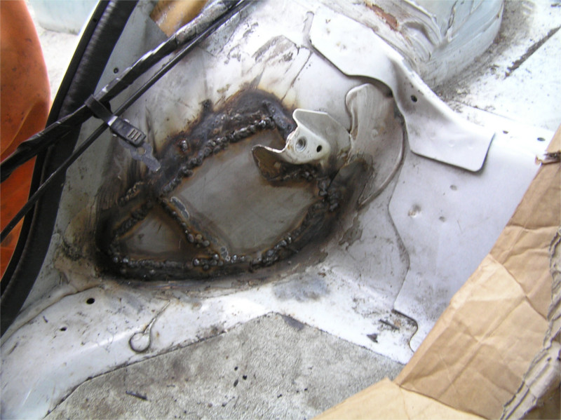

mouseflakes Posted July 30, 2016 Author Posted July 30, 2016 The old repair on the other side wasn't much better.More a case of 'seems welded' than seam welded....The old patch was covering a nasty rusted skin over this chassis section, so it was cut out and replaced...The belt mount area was replaced. Had to use a couple of sections of steel because of the double curve. Seam welded inside and out.And that flimsy old patch at the front was cut off (more rust behind) and replaced. M'coli, scdan4, Lacquer Peel and 1 other 4

surprisingskoda Posted August 2, 2016 Posted August 2, 2016 Good for you on some proper non-bodgery structurally integral fixes there. mouseflakes and stephen01 2
