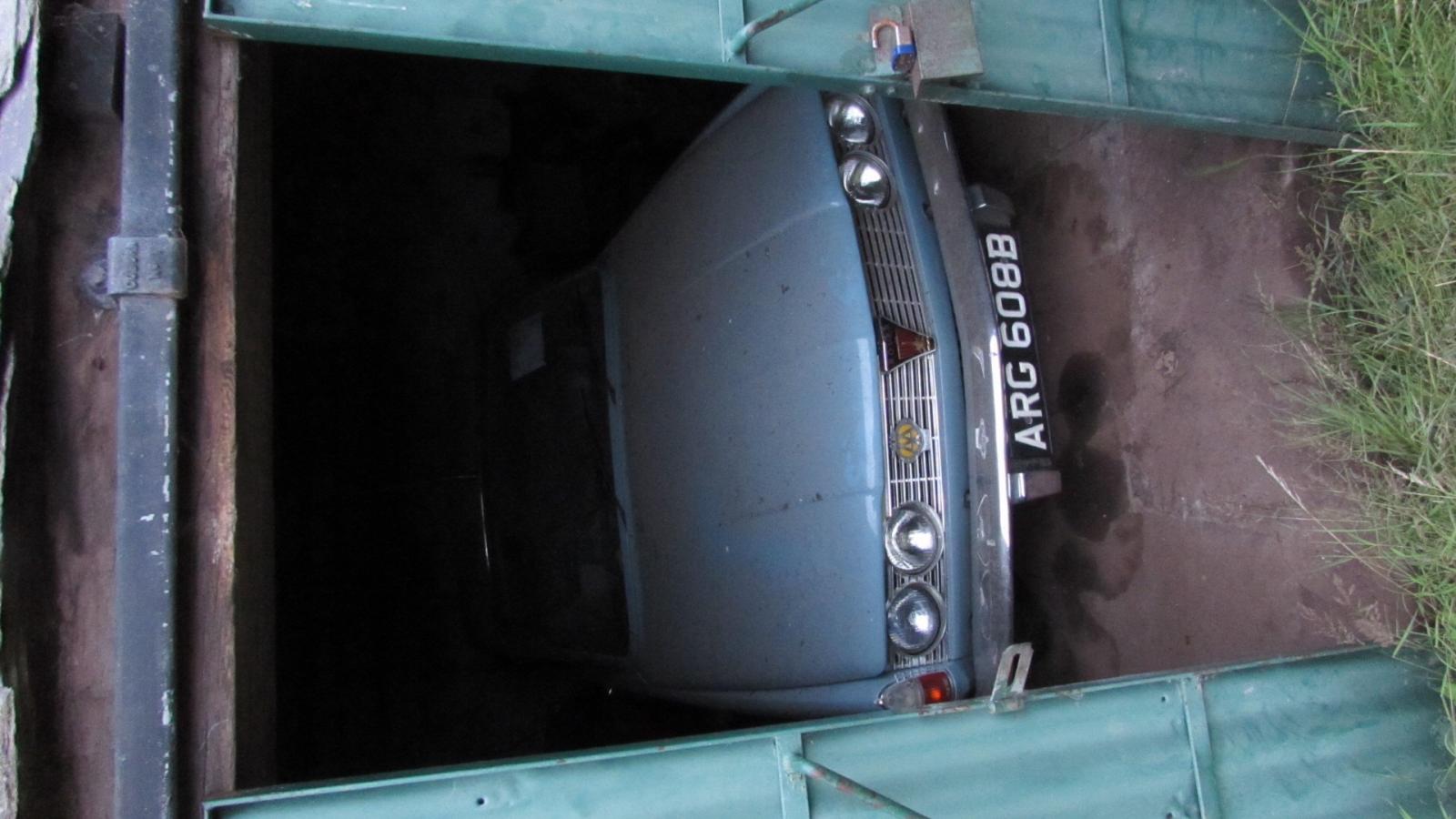

They have my maestro and two of Tam's P6s for company.
They take up less room when stored on their side.
I'll stick my neck out and say that I reckon that's the most scenic car storage space on Autoshite but I'll gladly be proven wrong by other efforts. This LR love really isn't helping my current obsession with wanting a S1, especially since I dream of at least trying one with the 'screen down and the doors off at least once.

That P6 is lovely I've never seen one that old before just goes to show Rover must of known about a merger nearly 30 years before hand with that Austin/Rover group initialed number plate.
