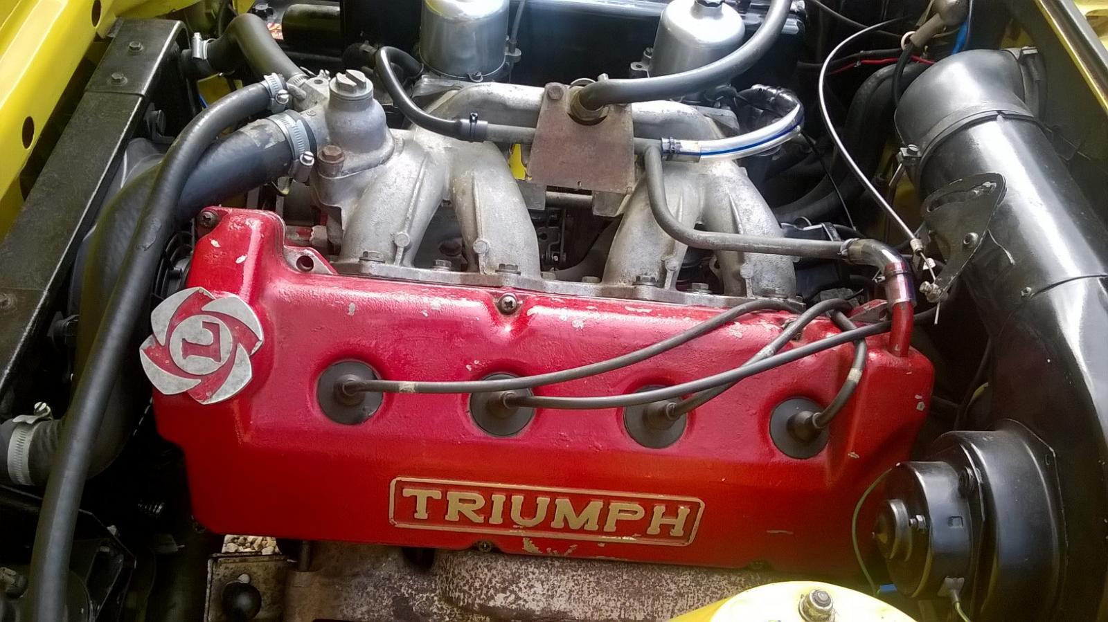

Guest Breadvan72 Posted July 9, 2015 Posted July 9, 2015 MOAR begging letters, sorry. Can anyone please help a fellow chod-botherer in the South Oxon region? My Dolly has a misfire on one or probably two cylinders, and I think it may be solved by fitting new plugs and leads and maybe a new rotor arm. It has Luminition ignition, so no points. Compression is fine, and the carbs seem OK, as far as I can tell. I was hoping to use the car on Saturday afternoon and go to the Triumph Fest on Sunday, but the new parts will not reach me until Saturday morning. I lack the tools and skills to do the work myself, and local garages are booked up. My usual mobile mechanic is unwell. If anyone has the skills and tools, is not far from junction 6 M40, and would be interested in copious bacon sandwiches, tea, beers, money, free goes in some other classic cars that I have (if not borked), random chat, a free go with my Missus, etc. please PM me. Many thanks, and sorry for being a useless numptie. PS One of the offers above is not genuine.

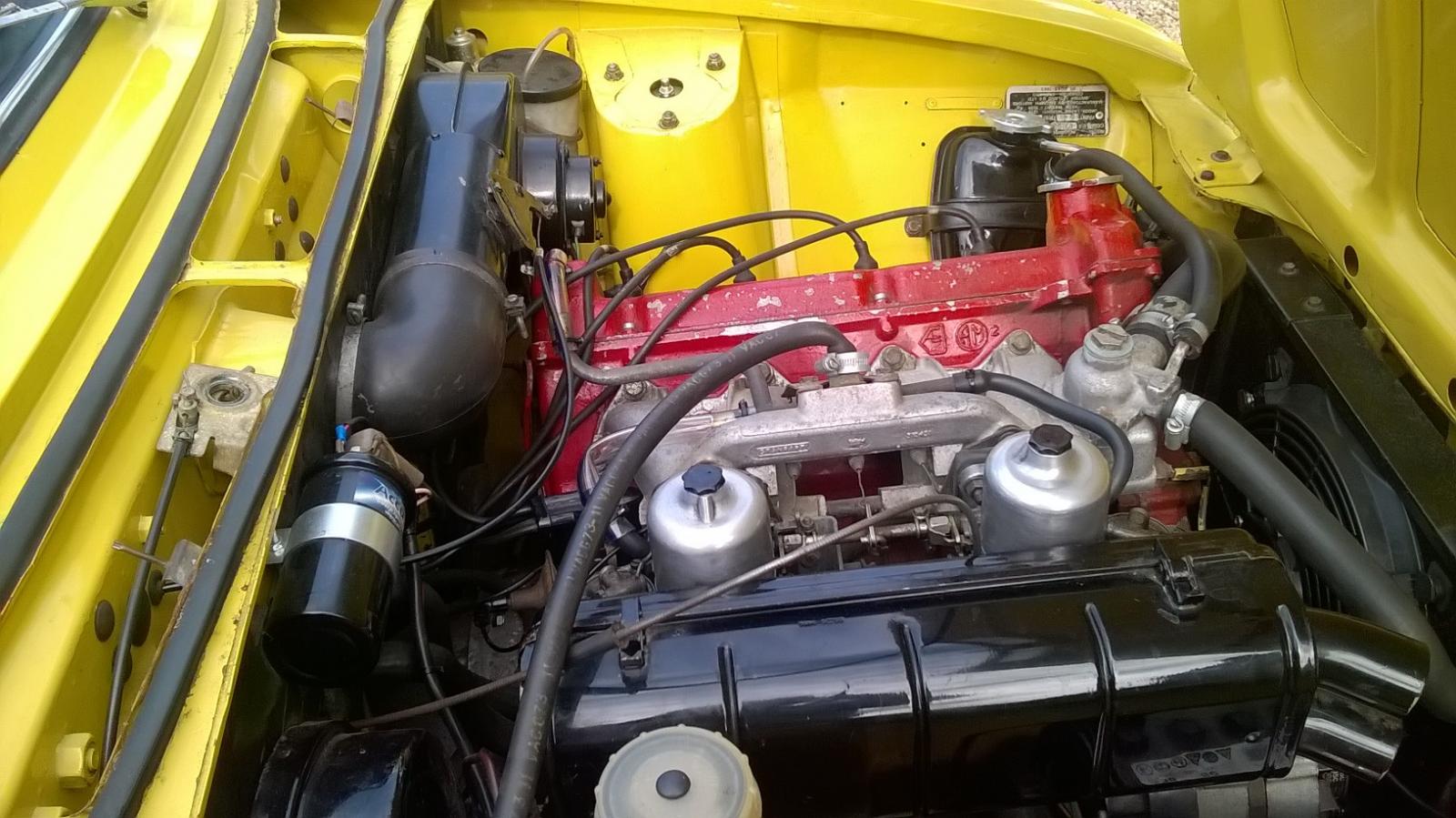

beko1987 Posted July 9, 2015 Posted July 9, 2015 If my daughter can run around I could help change the plugs and leads if its not a tricky job. Never done a rotor anything though, so may not be much help there. Can bring tools though if a shiter can come without them. Got a smudge of the engine bay?

Guest Breadvan72 Posted July 9, 2015 Posted July 9, 2015 Kind offer, Beko. Bring your daughter, meet my daughter (she is ten). We have a trampoline, big garden, friendly pooch, and a resident granny (no, not a clapped out old Ford). Imagine the comedy* as we try to fix the unfamiliar bits whist on the phone to some shiter who is 100s of miles away but has done one before. Sort of talkdown in the fog stylee, or Airplane 2, without the beaver jokes. NB, plugs lie deep within the contraption, cos of whacky top end design. BL used to use some specialist tool, but not sure if essential. Official BL workshop book and also HBOL on hand.

Skizzer Posted July 9, 2015 Posted July 9, 2015 Good luck chaps, that dizzy looks easy* to get at. I'd offer to come and assist but 1. I'm 160 miles away and 2. I'm very, very unlikely to be much help. Especially if you don't need/want beaver jokes.
