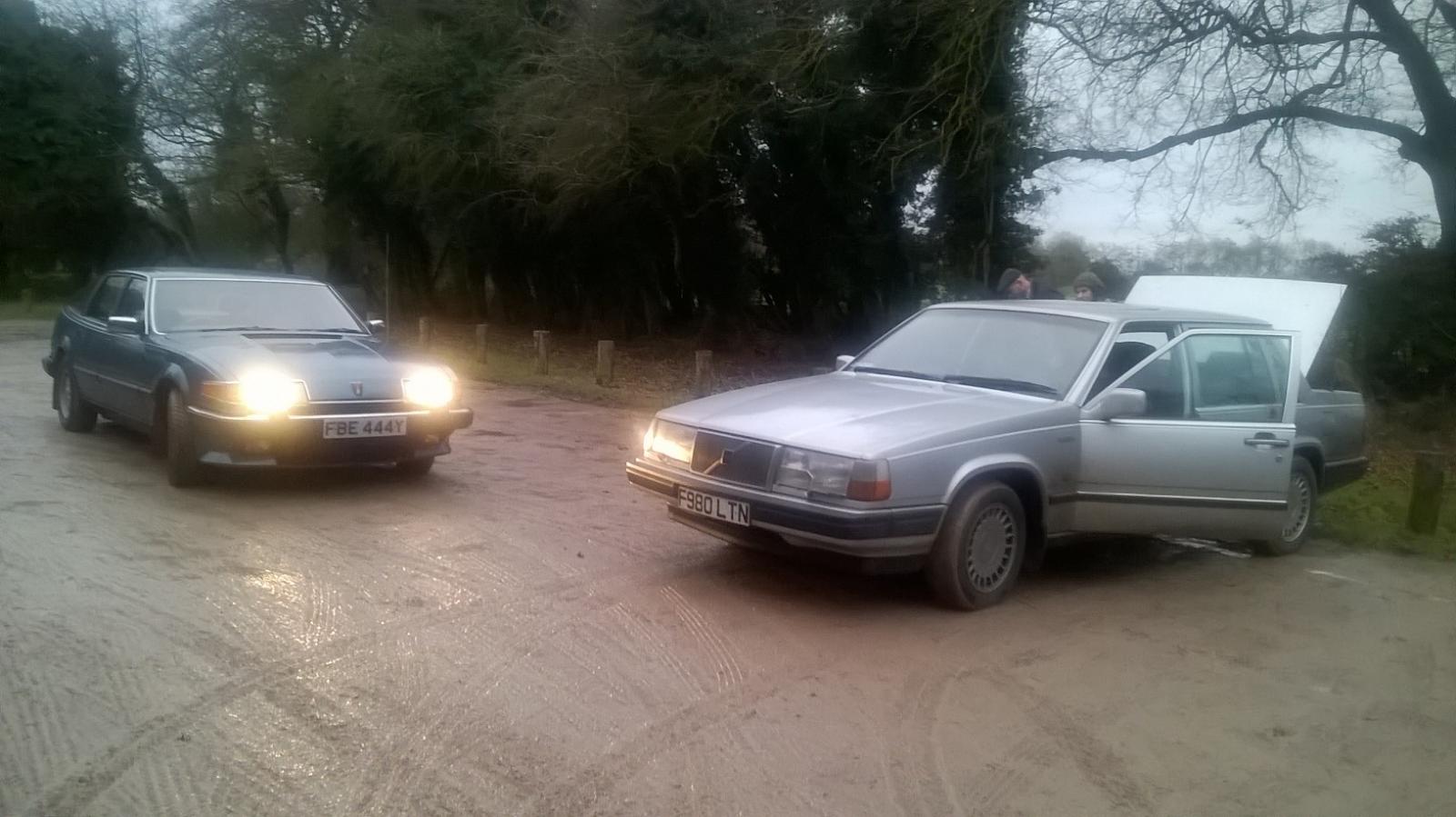

Guest Breadvan72 Posted February 1, 2016 Posted February 1, 2016 The incredible SIR BOLLOX OF AUTOSHITE rocked up at my place and freed the stuck clutch on the Rover, so once again it has been out bothering modern Beemers and such. Here it is with the NadgerVolvo. Clanger, Sigmund Fraud, Mr_Bo11ox and 13 others 16
hauserplenty Posted February 1, 2016 Posted February 1, 2016 Er--LHS headlamp inop......squire.[/obviously]
Mr_Bo11ox Posted February 1, 2016 Posted February 1, 2016 Er--LHS headlamp inop......squire.[/obviously]My headlights are off, that's a reflection of Bready's abundant headlights DeeJay and anonymous user 2
Guest Breadvan72 Posted February 1, 2016 Posted February 1, 2016 What did he hit it with to free it off? He hit it with a clue. Signor Testiculos has many a clue when it comes to cars shonky and various. Me, I loves cars, me, but I have nary a clue about dey heaps. All my dad's efforts to imbue in me mechanical cluenessness utterly failed. Having had two clutch probs on other cars in the last year or two (one dud clutch, fixed by a certain Capitano Cojones, and one dud slave cylinder, fixed by some bloke), when I couldn't get the RovahDaytonah to budge I went all OMG BROKKENESS. A clued person would have seen, as Herr Von Nutzen saw, that the fookah was just stuck on, Derrr. PS: Am sooo glad to be back in the 1970s/80s big fast saloon driving world. Lovely as my new freebie Bimmer is, it ain't got the fabness of the Sd1. Skizzer 1
Bren Posted February 1, 2016 Posted February 1, 2016 He hit it with a clue. Signor Testiculos has many a clue when it comes to cars shonky and various. Me, I loves cars, me, but I have nary a clue about dey heaps. All my dad's efforts to imbue in me mechanical cluenessness utterly failed. Having had two clutch probs on other cars in the last year or two (one dud clutch, fixed by a certain Capitano Cojones, and one dud slave cylinder, fixed by some bloke), when I couldn't get the RovahDaytonah to budge I went all OMG BROKKENESS. A clued person would have seen, as Herr Von Nutzen saw, that the fookah was just stuck on, Derrr. PS: Am sooo glad to be back in the 1970s/80s big fast saloon driving world. Lovely as my new freebie Bimmer is, it ain't got the fabness of the Sd1.I concur.
Guest Breadvan72 Posted February 1, 2016 Posted February 1, 2016 I had also fergit how whooshy quick it can be, once you wind it up. Those modern Bimmers were scattered asunder as I cranked and banked along the M40. Lots of people looking at it going "WTF is that?" as I stonked by. anonymous user 1
