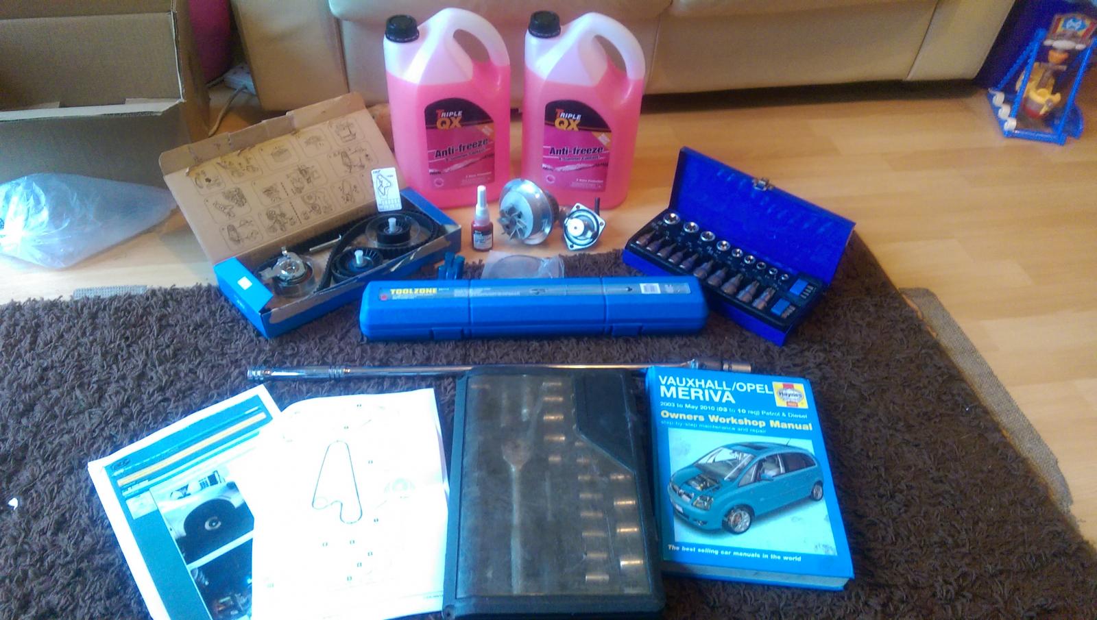

i bought a set of torx bits and sockets specifically for the car, so hopefully one will fit. Ive read scare stories about that too!

Should be piss easy now mate, all the parts, tools and knowledge you will ever need!
I now own a torque wrench (and need to learn how to use it now!), and a cambelt kit where the metal bearings are made in canada and the palstic tensioners are made in france...

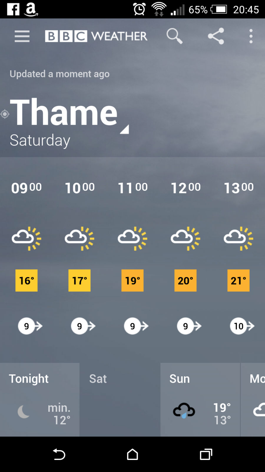

If it's not pissing down on saturday hopefully we will find out!

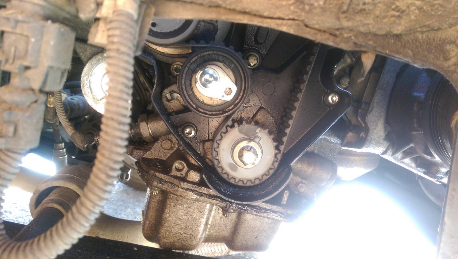

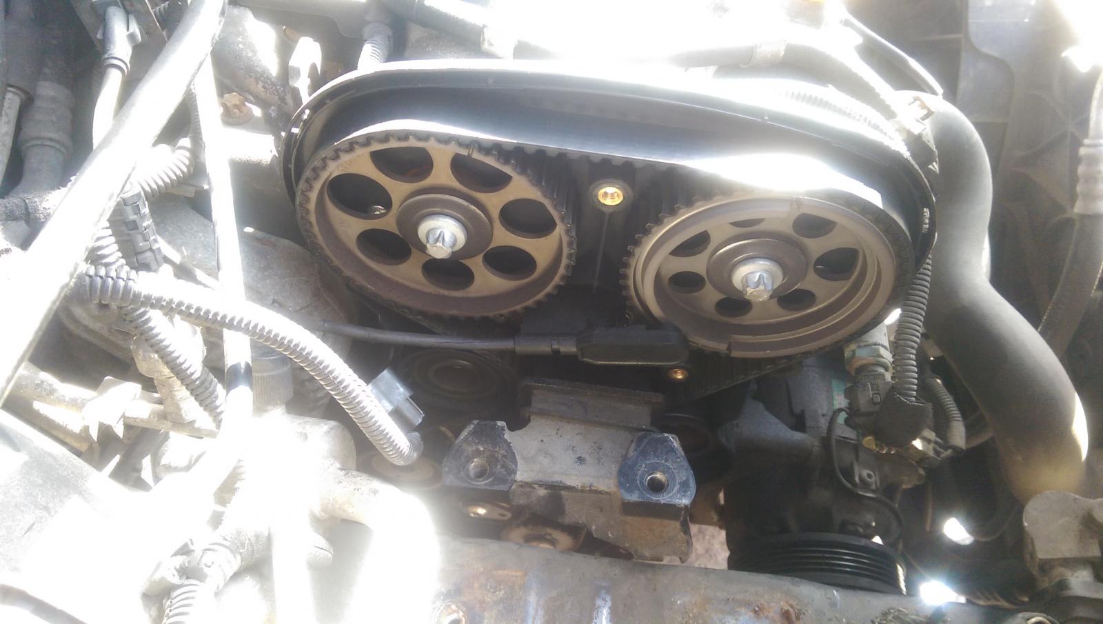

Going well so far. After an hour of undoing and removing stuff, I can see the cambelt.
Having a rolly and cuppa, then its time to time it up!
