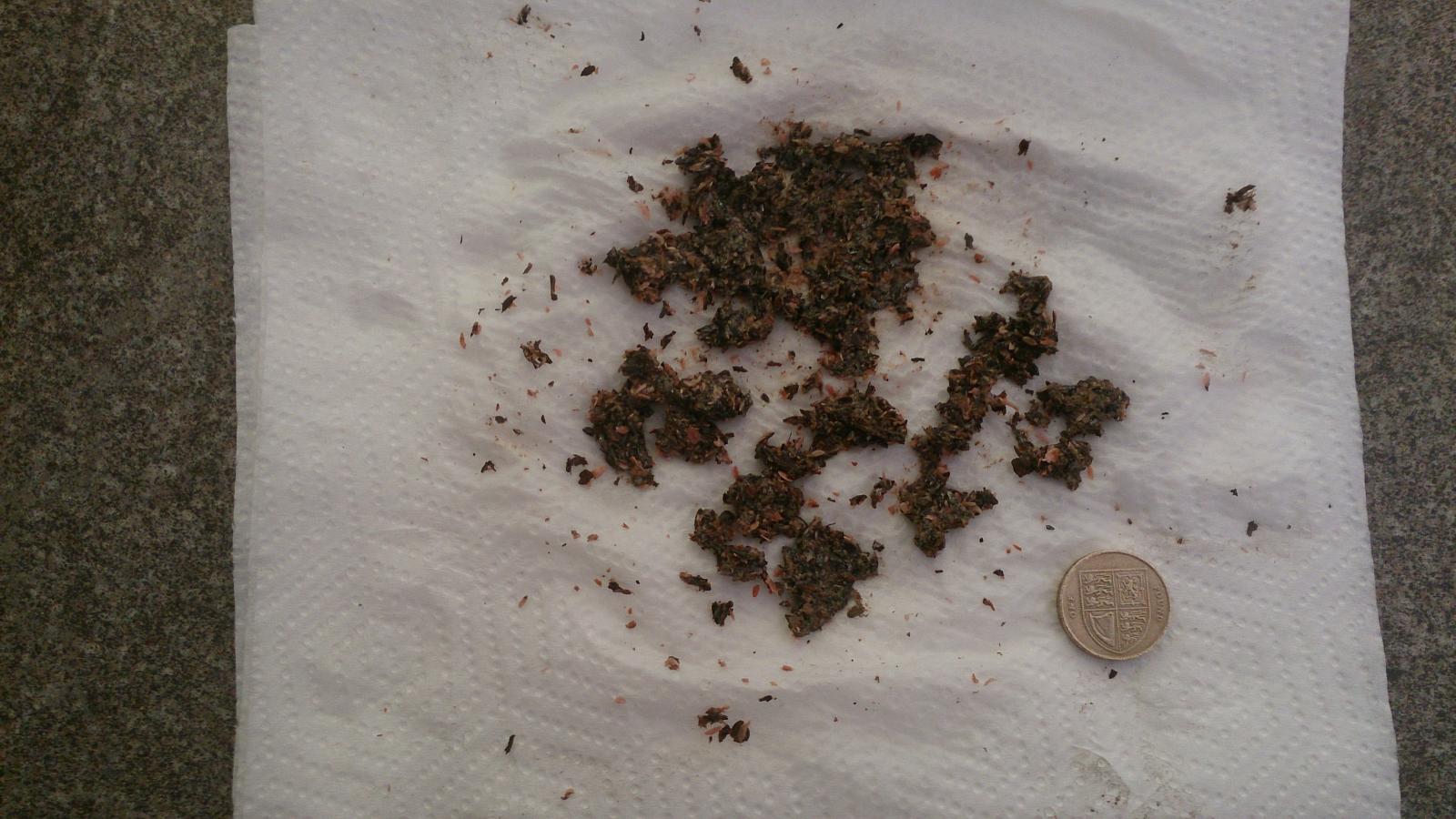

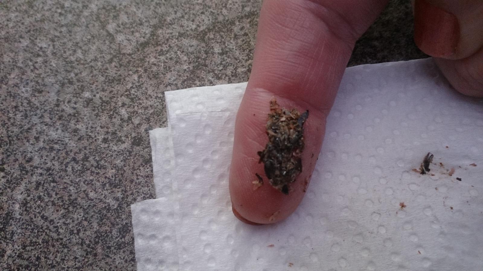

Mr A Lawrence Posted June 19, 2015 Posted June 19, 2015 Don't do it!! We bought an Mgf last year with hgf for £300 with 12 months mot, poor guy was on his way home from test centre when a pipe burst causing hgf. He put K seal in it and possibly some other, equally shit stuff to try and cure it. We had a mobile mech come and do the gasket and he couldn't get it to bleed properly so I had to flush the system.. This is what I got out of the matrix!!Not the quid coin though, that's for scale!!
Bren Posted June 19, 2015 Posted June 19, 2015 That looks like the stuff you used to crumble into the header tank like an oxo - bars?
sierraman Posted June 19, 2015 Posted June 19, 2015 That looks like radweld, that's got a powder solution in it. You wouldn't use that for sealing a head gasket, its not designed for that. Its designed for minor leaks not plugging the gash on the Titanic. purplebargeken 1

Station Posted June 19, 2015 Posted June 19, 2015 This is what I got out of the matrix!!image.jpgimage.jpgNot the quid coin though, that's for scale!! That's just years of hard water crud/sludge out of the cooling system. K-seal is microscopically minute particles that harden with heat and oxygen.

MrBiscuits Posted June 19, 2015 Posted June 19, 2015 That looks like the stuff you used to crumble into the header tank like an oxo - bars?Barrs Stop Leak. Known in the trade as the 'dog turd' about as useful as one too in my experience. Twiggy and Vince70 2
