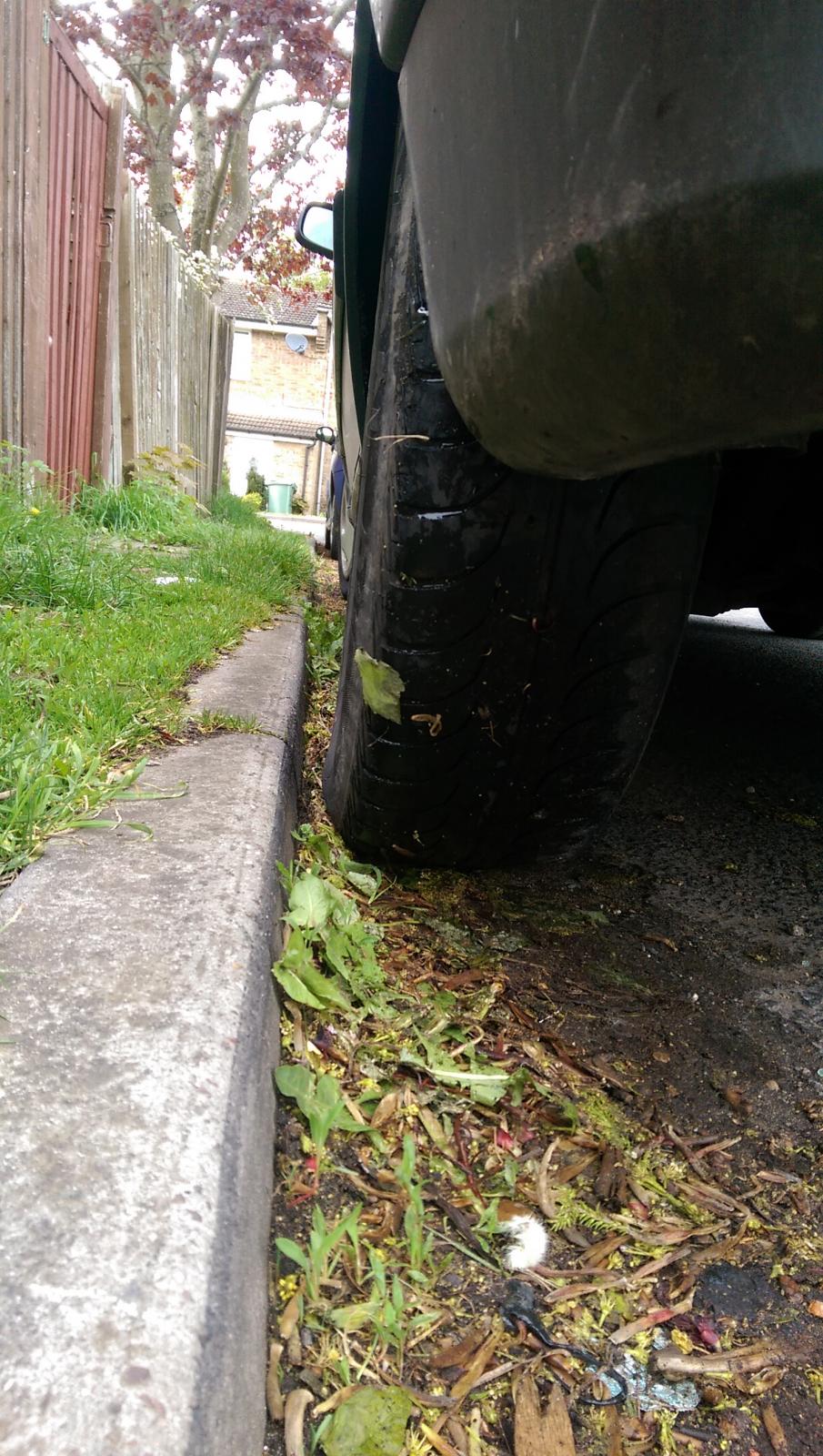

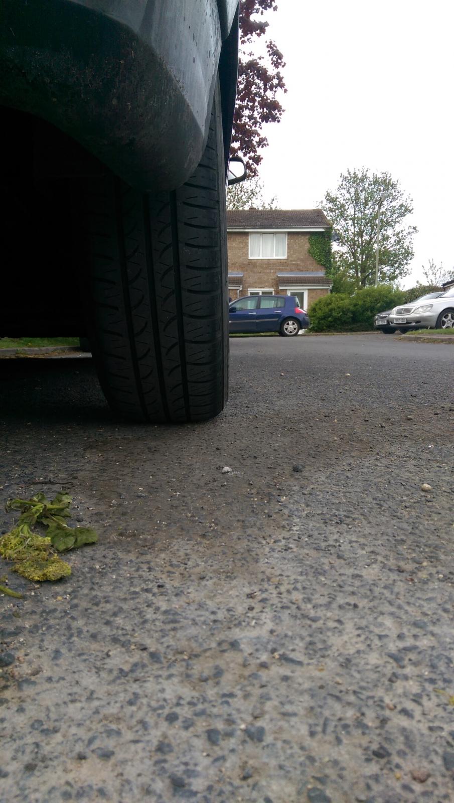

Offside looks ok-ish, nearside looks a bit dead I'm afraid!

The camber issue is worn bearings which can be replaced but once they have worn to the point where the wheel is visibly on an angle then the axle will be worn too so you won`t be able to refurb this one
