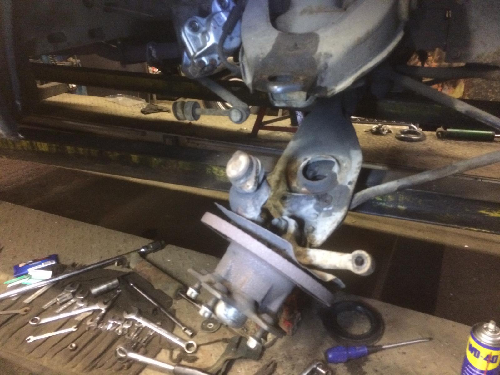

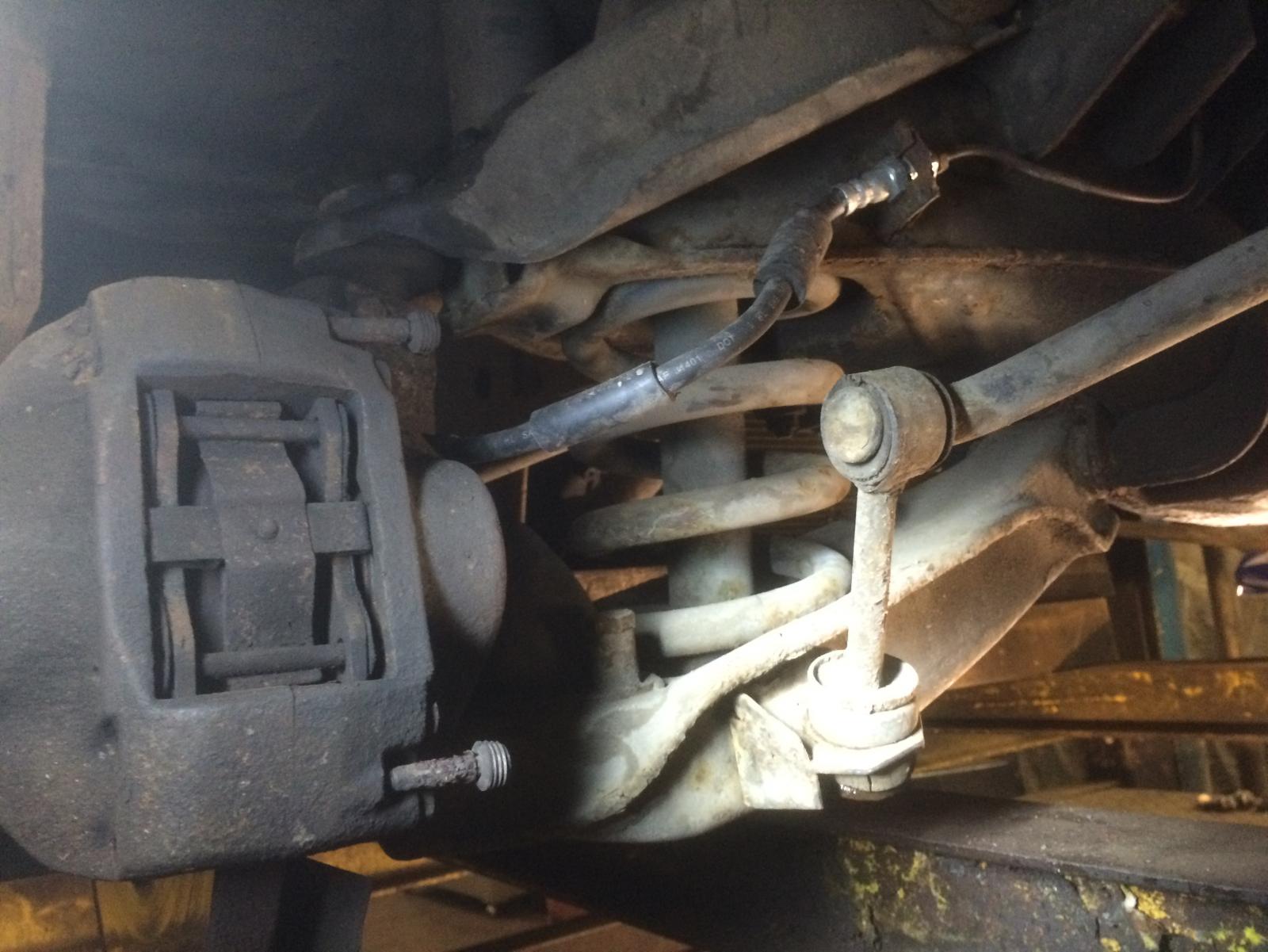

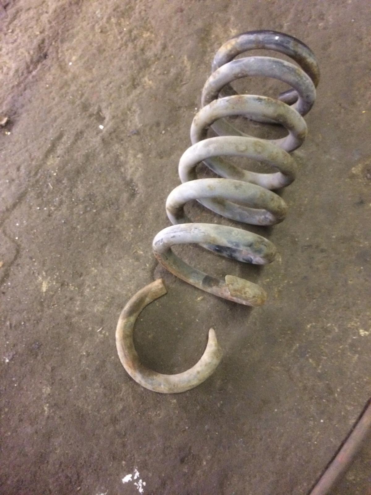

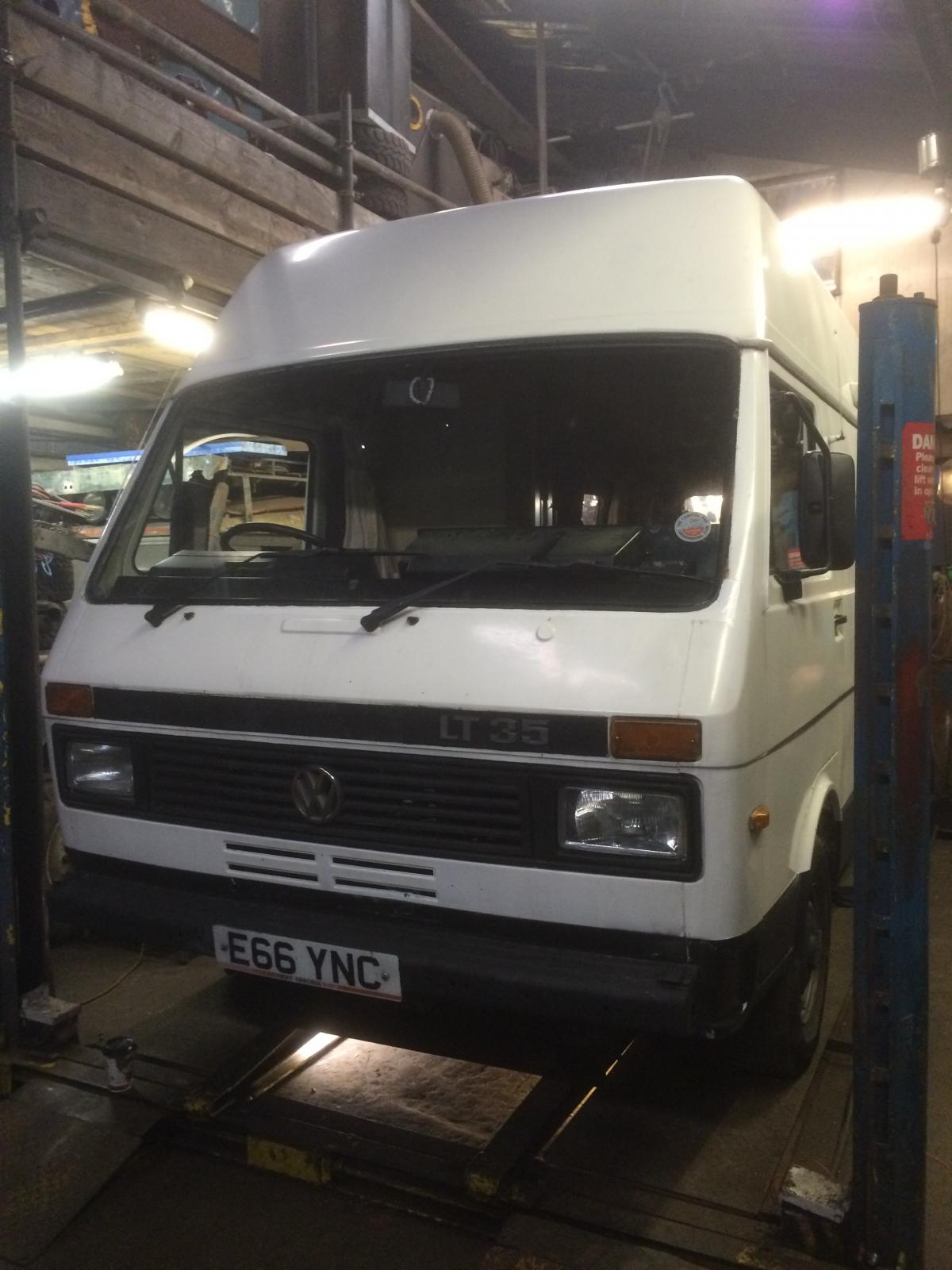

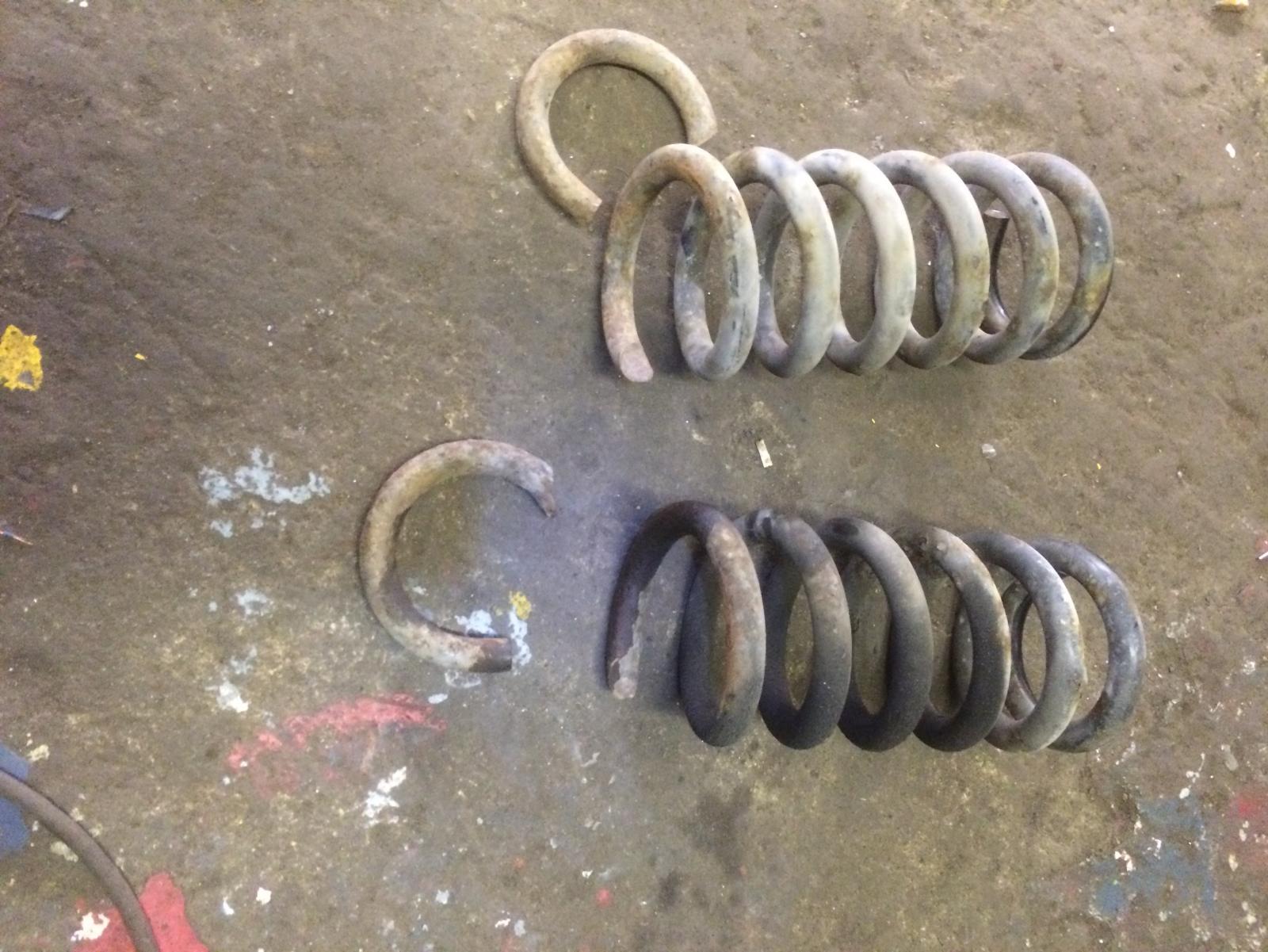

John F Posted May 6, 2015 Posted May 6, 2015 I found some time to start spannering my unwise ebay purchase LT camper today. First job: replace the front springs, both of which were broken according to Mr MOT man. There's almost no info about this job online, and I wasn't going to trust the HBOL (not that I have one anyway), so I popped a couple of brave pills & got to work. LT just about fits on the ramp... Starting on the nearside... not a lot of room to work here... you can just about see where the spring is broken. No way I'm going to get spring compressors in there. But eventually: The first one took me 4 hours to remove since I didn't have a clue what I was doing. But I eventually worked out that the brake calliper had to come off, then the anti-roll bar, then the bump stop, then the radius arm that extends forwards from the front of the bottom wishbone, then the track rod end. After that, shove a bottle jack underneath the bottom wishbone to take up the tension & the top ball joint can be unbolted from the upper wishbone, allowing the hub to drop. Then it's just a matter of unbolting the damper (top & bottom) and the whole lot pops out The trick is, the vehicle needs to be supported far enough in to allow the bottom wishbone to drop far enough for the spring to come out. I might have saved an hour if I'd realised that before everything was balanced on the wheel-free with not enough clearance to do the job. Meh. Anyway, on to the other side. This time it only took about 90 mins, I knew what I was doing now And the buggers are out The new springs (£45 each) are arriving tomorrow, let's see how easy it is to get them in... mat_the_cat, Vince70, Bren and 8 others 11
mat_the_cat Posted May 6, 2015 Posted May 6, 2015 How are the upper wishbone bushes? They tend to squeak over bumps well before any play is felt and seem to be a fairly common problem. If you loosen the upper wishbone at all, make a note of the pivot shaft position as that sets the camber...
michael1703 Posted May 6, 2015 Posted May 6, 2015 Hang on, you removed old springs before new ones turned up? OMG KAOSS!
gordonbennet Posted May 6, 2015 Posted May 6, 2015 Nice reminder of what a neat van the LT was, lovely engines nice drive. Hope the springs are short enough to pop in the same way they came out without having to compress them.
John F Posted May 6, 2015 Author Posted May 6, 2015 How are the upper wishbone bushes? They tend to squeak over bumps well before any play is felt and seem to be a fairly common problem. If you loosen the upper wishbone at all, make a note of the pivot shaft position as that sets the camber... I haven't had any squeaks yet, and the bushes didn't get flagged up in the MOT the previous owner had done, so I guess they should be OK. Ta for the info on the camber though, I suspect the offside wheel needs adjustment so I'll have a look at that whilst I've got everything apart. Hang on, you removed old springs before new ones turned up? OMG KAOSS! WCPGW? Nice reminder of what a neat van the LT was, lovely engines nice drive. Hope the springs are short enough to pop in the same way they came out without having to compress them. Absolutely. I've got a large stock of expletives ready if they don't go in easily though, so I'm well prepared. gordonbennet and Cavcraft 2

mat_the_cat Posted May 7, 2015 Posted May 7, 2015 Come on, where's the update? Brake pipes/hoses look pretty fresh from the photo which is good news; might be worth keeping the bleed screws free as with their length they seem more prone to shearing than any other vehicle I've worked on!
John F Posted May 8, 2015 Author Posted May 8, 2015 Come on, where's the update? Brake pipes/hoses look pretty fresh from the photo which is good news; might be worth keeping the bleed screws free as with their length they seem more prone to shearing than any other vehicle I've worked on! I got the springs in OK, no photos 'cos I was covered in grime for most of the day. I only needed to use my stock of expletives right at the end of the day when one of the solid brake pipes by the calliper decided to split as I was re-attaching the n/s calliper, I fitted a new bit of pipe & left it for the night as it was well gone beer o'clock by then, I'll bleed it up in the morning I sincerely hope the bleed nipples don't shear on me. Handbrake repair is also scheduled for tomorrow, and MOT is booked for Saturday 10.30 am... mat_the_cat, KruJoe, alf892 and 1 other 4
