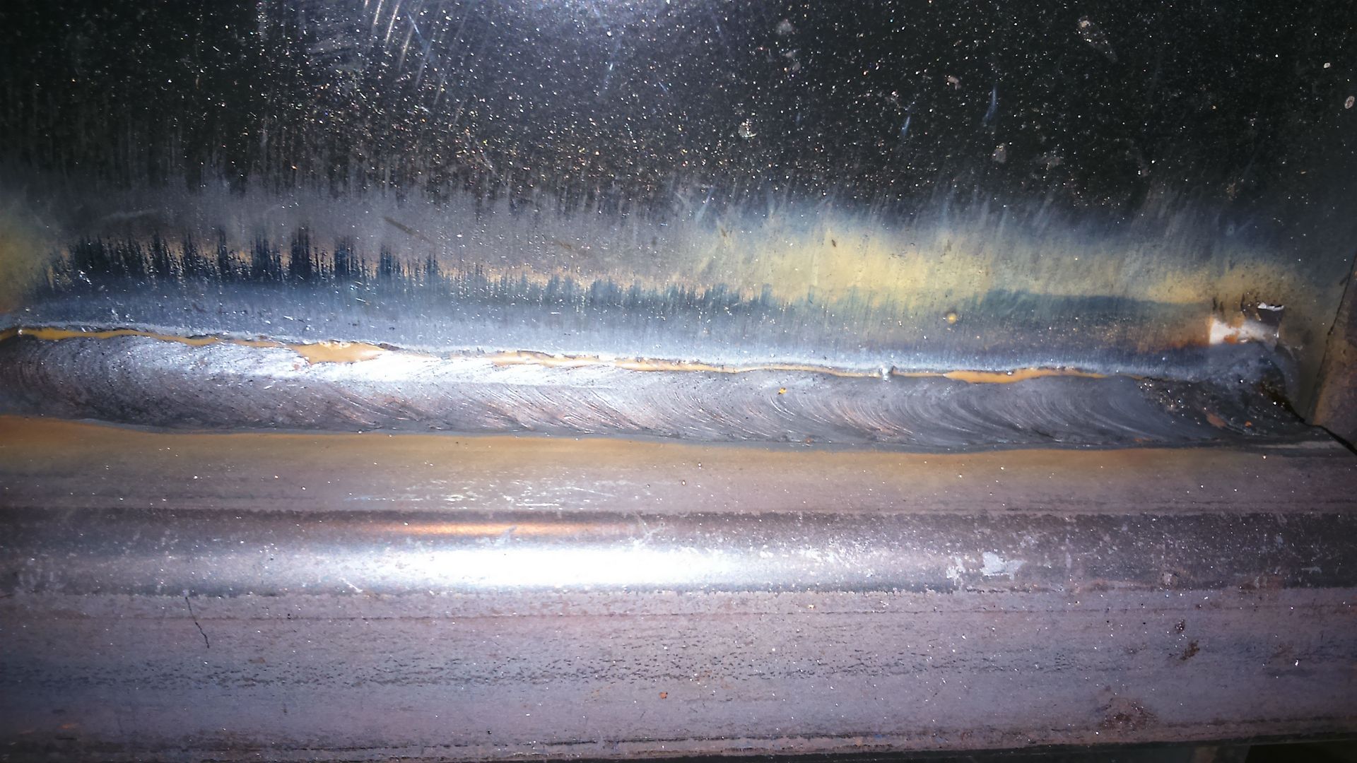

filthyjohn Posted April 10, 2015 Posted April 10, 2015 I'm a certified Portamig fanboy The biggest advantage of the Portamig is the low minimum amperage, it goes down to 20 on the lowest setting, which (with 0.6mm wire) means you can weld Brown Ale cans together at the ends. To go lower you need a TIG really. It's also the absolute nuts when it's turned up too.
