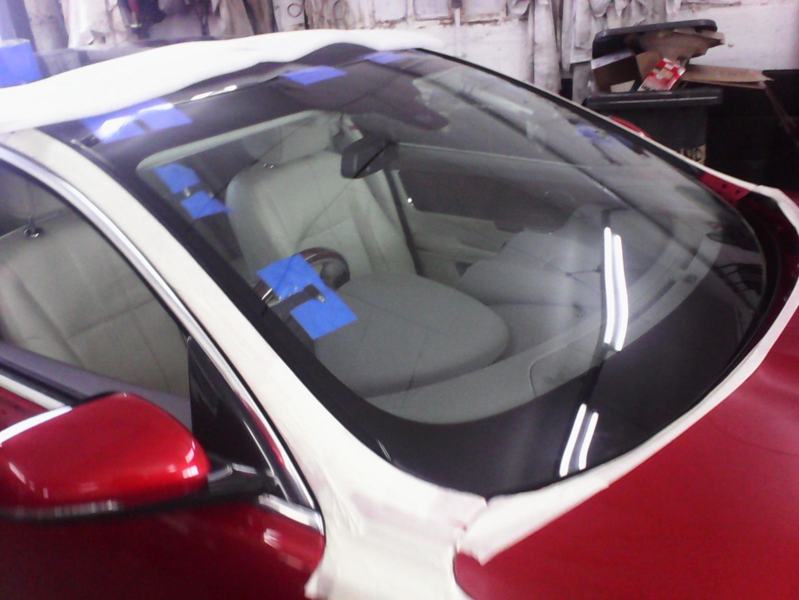

It's great what the professionals can do.  The windscreen company next door to us had a 15 plate XJ in, where the windscreen wasn't fitted correctly when the car was built, the trim along the top of it didn't line up correctly.
They cut the screen out and refitted it without causing any damage.post-3751-0-92265200-1429437167_thumb.jpg   post-3751-0-70527700-1429437228_thumb.jpg
I'm hoping Jaguar or the dealers were paying for that, a month-old lux-o-barge with a major component put in wrong! But yeah, I suppose it's all about knowing where you can and can't put force. Glass doesn't twist or fold very well but is surprisingly flexible in the right direction.

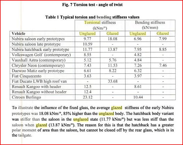

Possible but I was always told that the bonded screen is part of the chassis strength on a modern car and I can see them wanting to loose that .
the MGF fraternity will tell you that the windscreen is "structural".  While I accept it adds some small degree of strength to the frame, I'm not convinced that "structural" is the right word for it.
Gavin from Autoglass used to harp on about that too. I suppose it keeps everything else in line and the rest of the car is designed around having it there, in one piece. Can't see a stone chip causing you to veer into a bridge support at 70mph though.
Bonded glass substantially increases the torsional stiffness of the body.post-3751-0-20764800-1429972711_thumb.jpg
