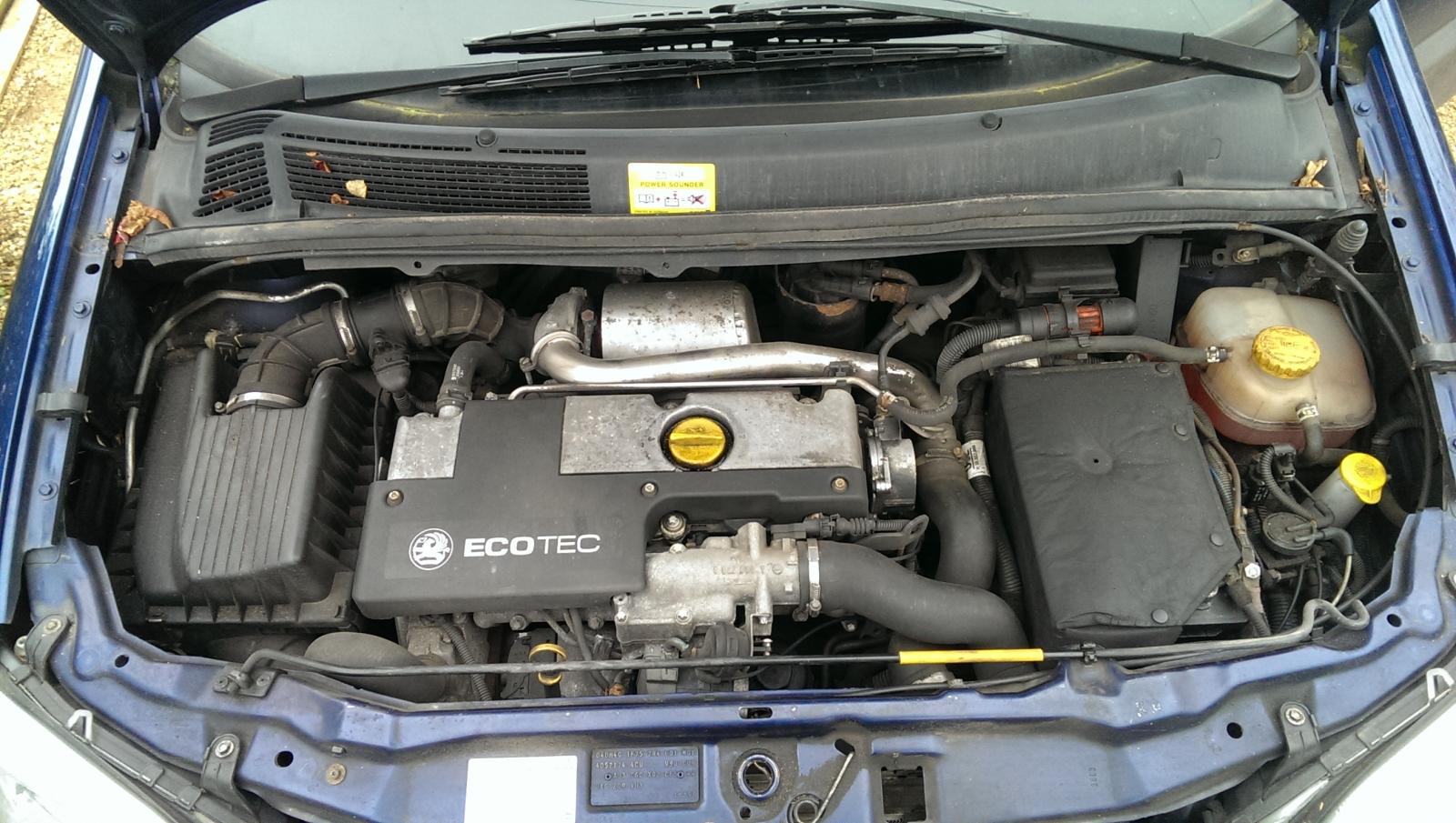

This is the engine
Is that the EGR or the DPF? If it's happened after running at low revs it MIGHT be the thing most modern diesels do, whereby they need a bloody good 'Italian tune up' to clear themselves.

Interesting, cheers. He did say it doesn't do it if you keep the revs high.

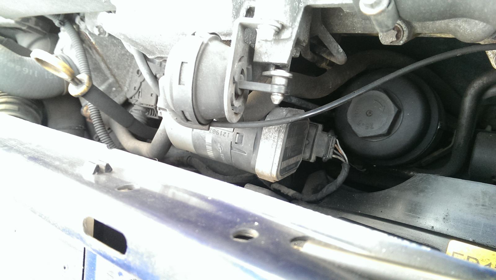

Doing some googling it seems its the egr valve in that picture, but on the various vx threads the symptoms are anything from the egr, mad, dpf, collapsed cat, camshaft sensor etc

*Edit: I don't think (from an internet search) the 2.0DTi had a DPF, I think they were only on later 1.9CDTi models.

Those egr valves are lovely and easy to clean. Put a little high mp grease on the roller/cam inside too.

This generation of Zafira will have been far too old to have a DPF, the tighter emission legislation warranting them appeared much more recently.
Who made the 2.0 DTI engine in these? GM, or did they buy it from somebody?
Its a gm lump, and a damn good one at that. I don't know of anyone that has had one apart.
