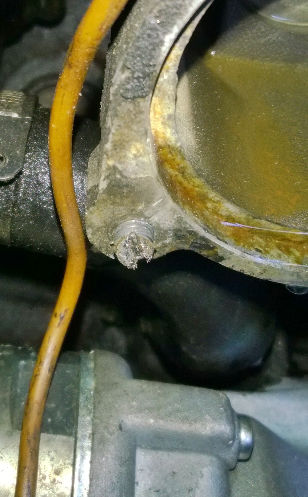

Not written on here for a while so here goes with a tale of fuckwittery and doh.
Changing a thermostat on a Kia Pride should be easy, 2 bolts undone, old stat out, remove old gasket, clean surfaces, new stat in, new gasket down, 2 bolts done up, top up coolant, bingo
A bit of plusgas and the bolts undid well, old stat came out and coolant was a nice clean blue so no drain and flush needed.
Then I look at the new and old stats
I realise with a bit of messing about that the new stat will have to lose the rubber ring to go into the place where to old one came out of and that as it didn't come with a  gasket then I would try some gasket goo to seal it.
The joy* of put putting it back in place involves working round both the distributor (top right) and the heating pipework (bottom right) which means that you can seen nothing but the top corner of what you are working on.
This means that I bolted the thing back in, filled up the coolant and saw liquid pour from god knows where.
The next attempt I left for a week so the gasket goo could cure properly before pouring liquid in, it still went everywhere.
Today I took the cover tot he local motor parts place and got a gasket for £1 (big money)
put it back together and found that the issue was that the bolt that I couldn't see was sticking in its hole and not tightening up, maybe the gasket glue wasn't to blame.
So out came the torque wrench and a bit of 50ft/lbs setting which leaves me with this.
Arse biscuits.
So if anybody in Birmingham has a stud extractor kit that can help then I'm interested in learning how to use one, I'm currently contemplating trying to get a lefthanded drill bit as that trick should work on what is a not very 'stuck' item, just inaccessible.

Were the bolts different lengths? They do things like put the long one in the top and a shorter one in the bottom just to confuse and spoil your day/week/month.
Delete as applicable.
Not noticeably different, but I wonder if there was a 2-3mm difference, that's all it would need, but then why not make them both the shorter length?
To get my gasket bolt out I cut a small slot in top with dremel then unscrewed it. It was slightly above flush so wasn't too bad to do.
Thanks Moog
I may have a go at that method, but will probably still order a left handed cobalt bit as it looked like a very neat trick in the youtube video.
