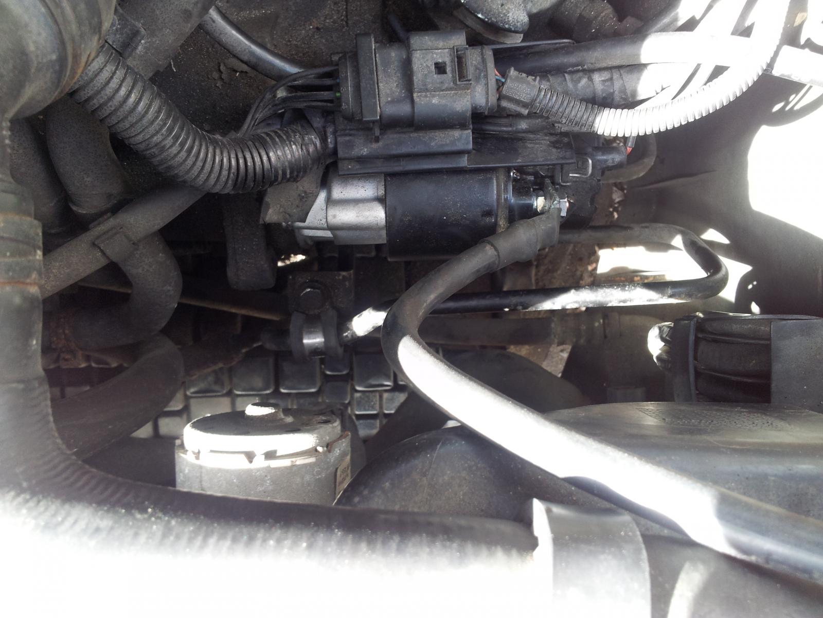

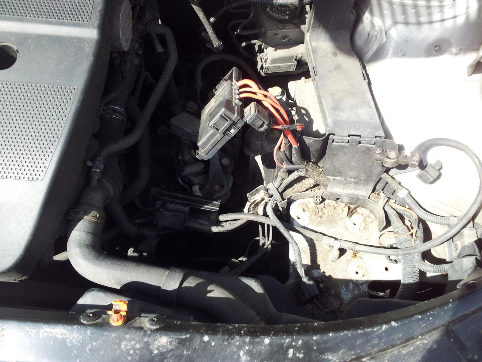

It's being pressed into service as my work hack next week and I thought it would be a good idea to make sure it was 100% beforehand.  It's always been a bit slow starting when hot, it spins over OK but the starter on these 1.9 diesels tends to wear and slow down, if the engine isn't turning at 200RPM or more, the fuel injectors won't turn on so when it's hot and therefore harder to turn over, it will sometimes take 3-4 seconds before it starts.  No big deal, I think it's been like this for years anyway (I knew about it before buying it) but it will be doing a lot of hot starts and possibly being borrowed by colleagues as well from time to time so I could see it getting annoying.
I extracted the starter motor last weekend and dropped it in to a local auto electrician who specialises in alternators and starter motors.  They found a large chunk of solder had come away from the armature, repairing the existing motor would cost £65 +VAT or they had a brand new exchange motor in stock for £68 +VAT.  A no-brainer really.
Shiny.
Bolted it in yesterday and it now turns over much faster and starts instantly whether hot or cold, I'd say that's money well spent.  Should last another 190,000 miles or so, hopefully.
A relatively straightforward and easy job, I've never done a starter motor job before but it took about an hour to get the old one out and another hour to put the new one in.  I could probably do it rather quicker now, it would also be easier without what I assume to be an air-con pipe in front of the motor which gets in the way of the ratchet when undoing the lower bolt holding the motor in.  Incidentally for anyone who might have to do this, the two mounting bolts are 18mm, this stumped me for a while as I do not have an 18mm spanner or socket (in fact, I have never needed one either) but fortunately an imperial socket of almost the right size came to the rescue.
