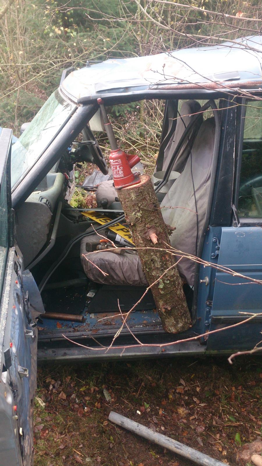

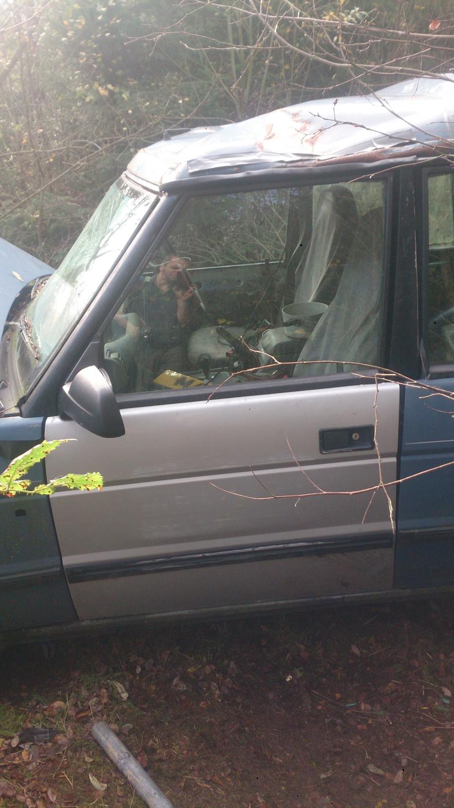

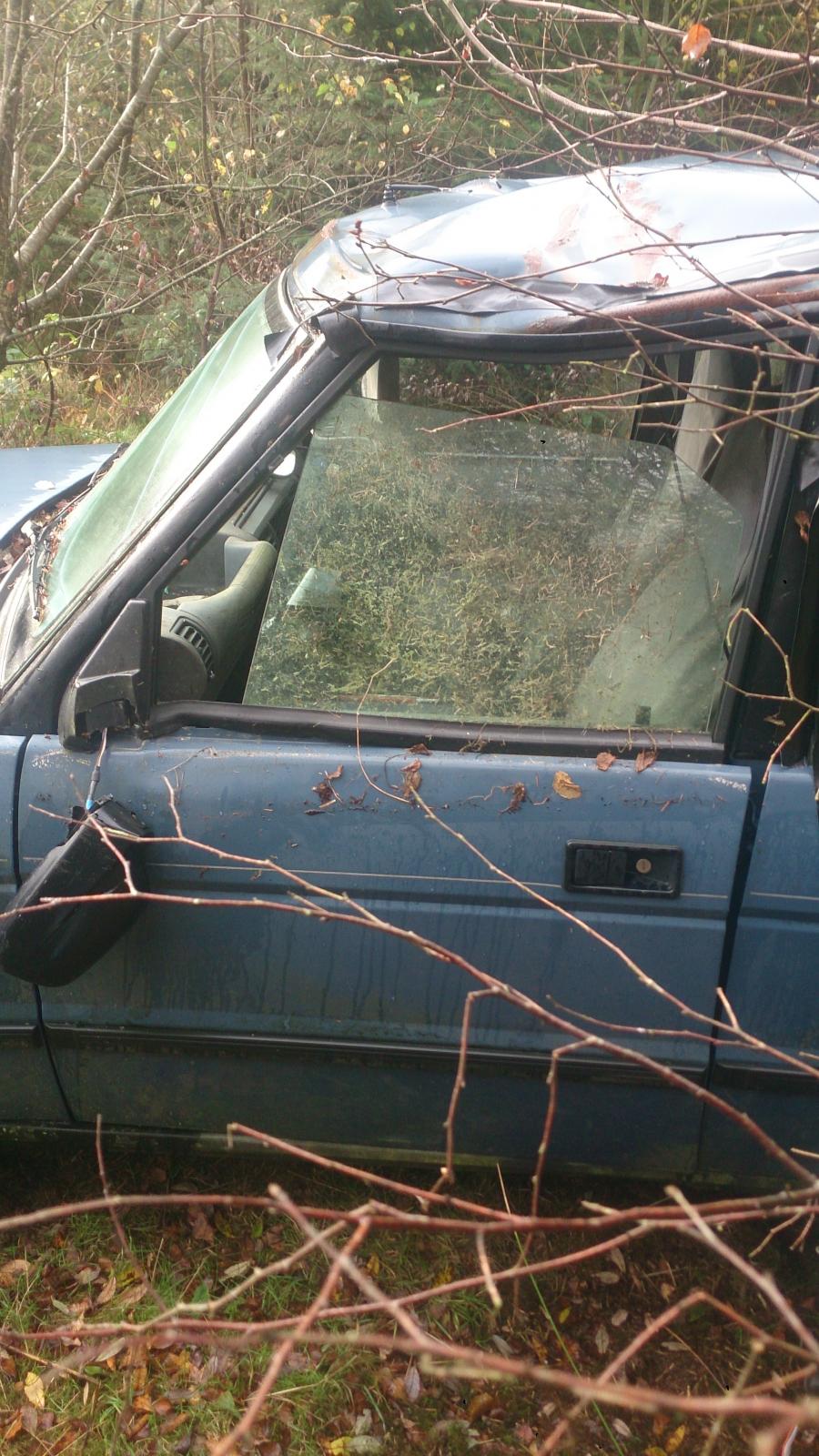

mat_the_cat Posted November 1, 2014 Author Posted November 1, 2014 Next was the passenger door - I wasn't looking forwards to this as the roof above it had taken the brunt of the force. Even when I had straightened the top edge of the door frame, when I hung the new door you could see that the A pillar had been pushed back too. So I tried jacking across the door frame, which worked reasonably well although it kept springing back. In the end I hammered the A pillar the last few mm and at last the door closed! Panel gaps with the rear door nothing to write home about, but at least it should be reasonably watertight. Windscreen next - I've bought some wire to remove it; just need to find a replacement screen for little money. Junkman, DVee8, Banger Kenny and 2 others 5

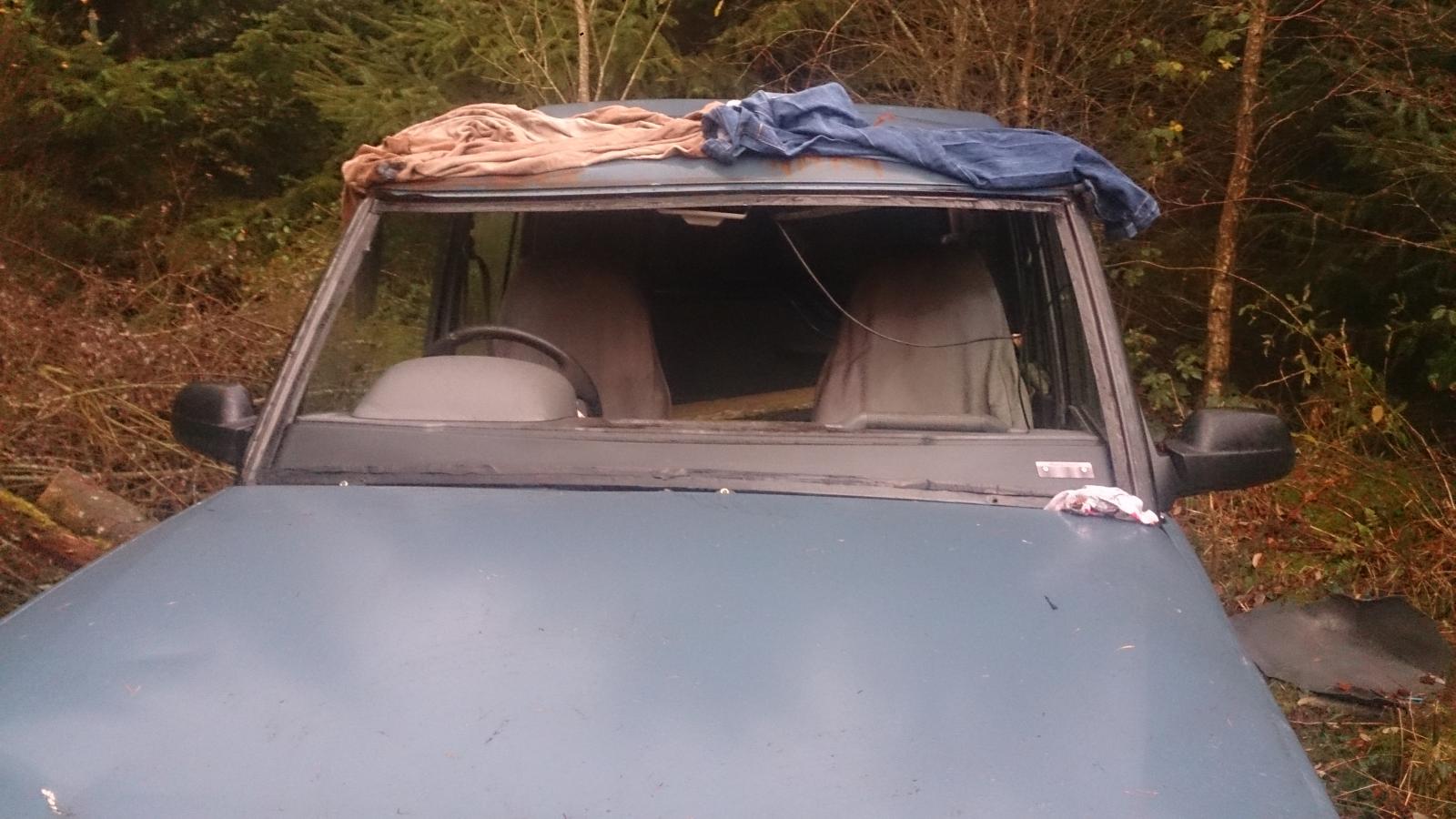

mat_the_cat Posted November 16, 2014 Author Posted November 16, 2014 Not looking too promising for tomorrow as we'd planned, as I've spent 3 hours on it tonight to get to this stage: Oh what an exciting Saturday night I'm having! Broken glass absolutely everywhere, the cheese wire is VERY hard work and keeps getting snagged on shards of glass etc. Going to have to break out the rest piecemeal I think. Remind me why I thought this was a good idea again...?

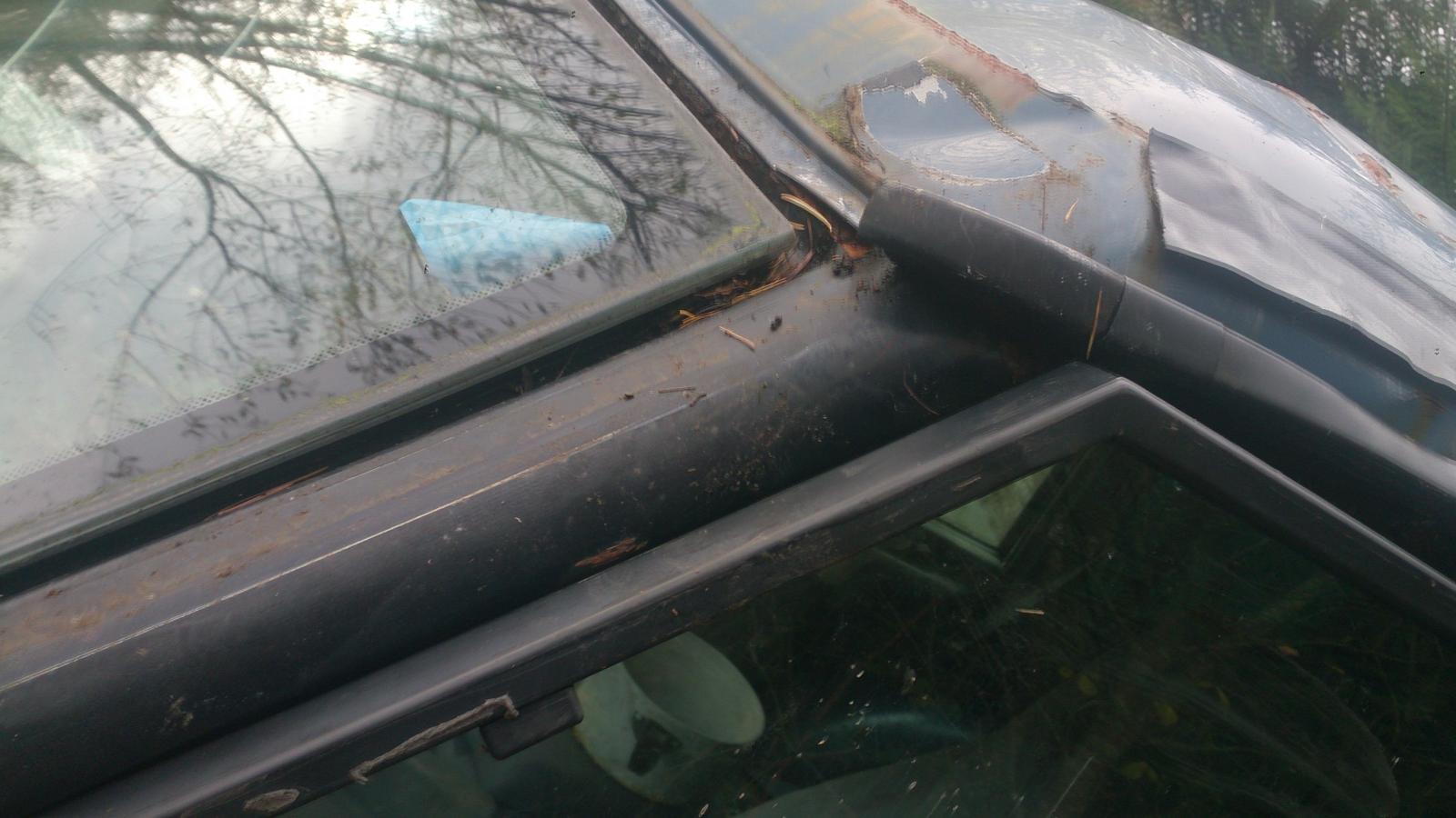

mat_the_cat Posted November 16, 2014 Author Posted November 16, 2014 FFS.This weekend was forecast to dry, the first days without rain since the beginning of October. Got back this afternoon to find it raining There was a break in the weather so I cleaned up the frame and primed it with etch primer (rags on the top are to absorb water and stop it running down while I'm painting). It turned out that if I knelt on the bonnet I could lower the screen in by myself, so I primed the glass for better adhesion, and while that was drying put the sealant around the frame. Then put the screen in! For the first time in years it's actually usable as a vehicle, and (hopefully) watertight, at the front end at least... Rusty_Rocket, jakebullet, DVee8 and 5 others 8

mat_the_cat Posted November 16, 2014 Author Posted November 16, 2014 Annoyingly, I actually ran out of adhesive! Did the bead all the way around (just) but there was a small gap where the frame was distorted. So I gave another squirt only to find there was bugger all left. Fortunately I had some Sikaflex 221 left over, so filled the gap with that. You're welcome to the glass primer though if that's useful. dollywobbler 1

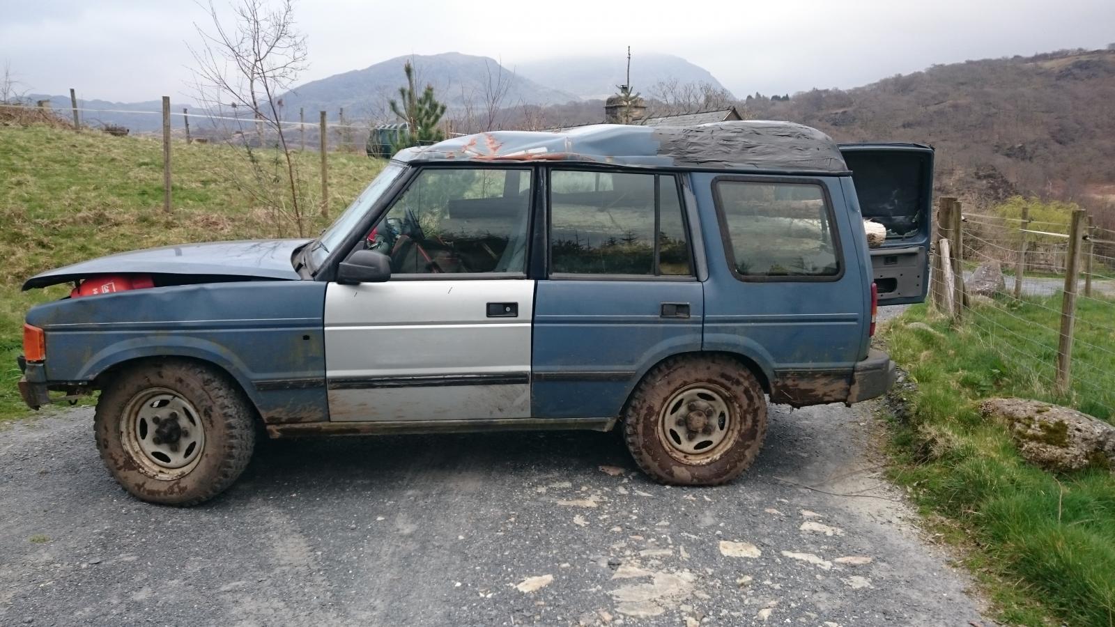

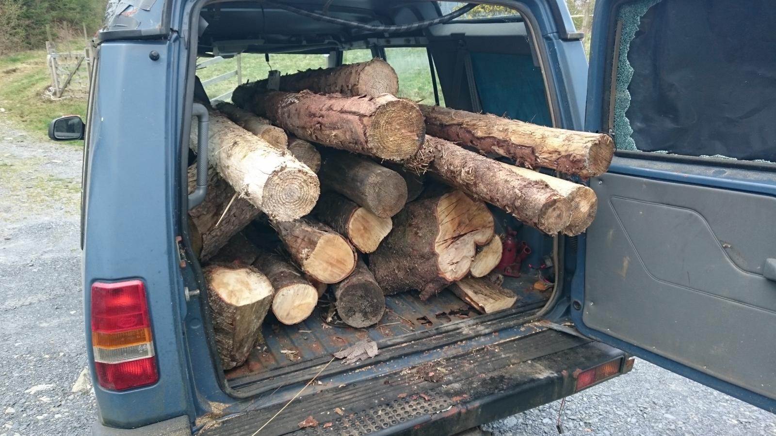

mat_the_cat Posted November 29, 2014 Author Posted November 29, 2014 Took it for a bit of a spin today, seeing as it has stopped raining! The engine pulls well, although rather loud seeing as I pinched part of the exhaust for the green one. Filmed with my bargain dashcam: And on the way back collected a few logs, so it wasn't a wasted trip I would have fully loaded up but the back door has seized, so had to put them in from the side. Junkman, LightBulbFun, Micrashed and 5 others 8
mat_the_cat Posted March 18, 2015 Author Posted March 18, 2015 Well, this has been useful up to now in collecting wood, but it had the first 'failure to proceed' earlier in the week I'm running purely on gas (petrol pump was swapped for the one on the green Disco), at least until the tanks ran dry. Inconveniently blocking the track. This left a bit of a problem, as I can't (legally) get it to a petrol station to fill up... So I managed to rig up a hose from a Calor bottle to the vaporiser, minus the regulator, which was enough to get it out of the way. Seemed to run OK too, although I needed to drill out the excess flow valve in the hose to get enough gas through to keep it running. Junkman, DS20, anonymous user and 4 others 7
jakebullet Posted March 18, 2015 Posted March 18, 2015 Turn gas bottle upside down so you get liquid to the vapouriser instead of gas? I'm sure this will be totally safe*.
mat_the_cat Posted March 19, 2015 Author Posted March 19, 2015 I could do that if needs be, but I'm only trundling round in low gear so the vapour off the top of the bottle is fine. Might get a forklift bottle though at some point. Or a new petrol pump...

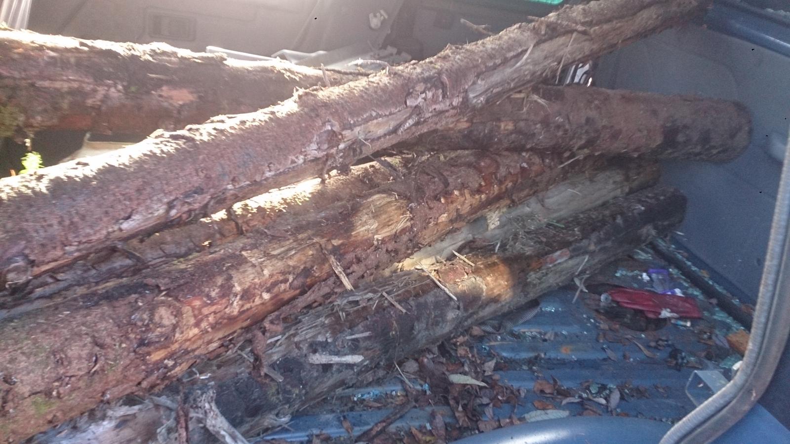

mat_the_cat Posted April 10, 2015 Author Posted April 10, 2015 I've been giving this a fair bit of use recently...still on the same bottle Got a decent load of wood in this afternoon: Which must have been quite a weight looking at the suspension! Junkman, brickwall, Banger Kenny and 6 others 9
