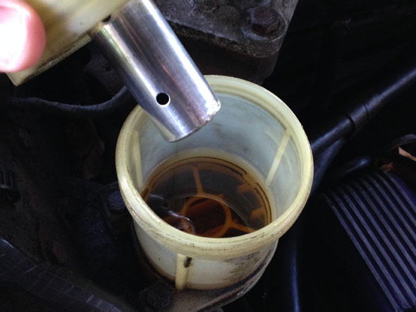

Then the strange thing - with me checking the fluid daily, the level didn't fall a single millimetre for a fortnight. Then suddenly:
RECONSTRUCTION
Okay, shit. Where's it going? At this point I'd have been over the moon to find a cracked pipe or damaged flexi, because fluid vanishing with no trace means either the servo is filling up or the rear calipers are filling up. Neither is good. Let's poke a dipstick into the servo first, since it's the more accessible of the two.
There is some evidence of brake fluid in the servo. More brake servo problems, wow, who'd have thought? I'm happy it's not the rear calipers, although the brake servo kept this car off the road for months in 2014, so... maybe I'm not happy at all?

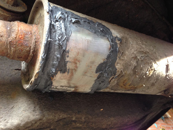

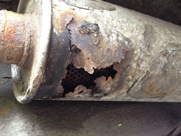

It suddenly got loud at a set of traffic lights. I couldn't remember seeing this hole before, so it was a key suspect.
Sometimes you just have to accept a component has had its day. This long suffering back box has already been patched twice, and a lot of the stuffing has fallen out this time. When new ones are available off the shelf, you'd have to be a real cheap piece of shit to bodge this rotten one back together with welded on bits of tin and exhaust putty.
But it came out okay, so... maybe I am happy?
