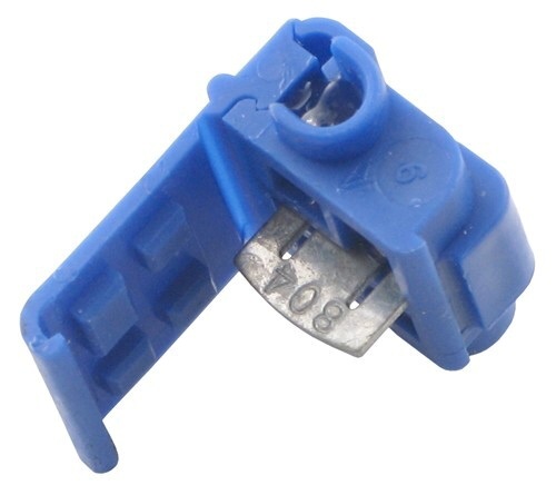

It shouldn't have a factory immobiliser on a K plate so that's one less thing to check, The factory immobiliser didn't come out till a year later as I found out when I got a new key cut on my old K plate 2.3 Cabriolet.
But most earlier 80 Coupe and Cabriolet models have had those horrid aftermarket systems fitted as a lot of insurance company's wouldn't touch one without a bit of Thatcham paperwork, So more than a few have had their wiring looms butchered in the past.
Mine had evidence of having two systems due to lost paperwork on the 1st one, so keep a look out for the tell tale scotch locks..post-9282-0-37109700-1409553857_thumb.jpg
