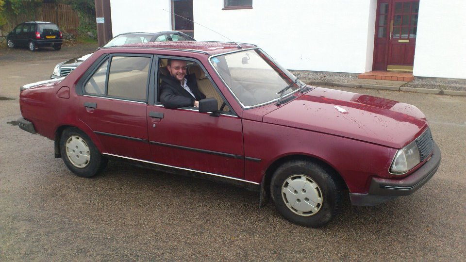

Nah it was originally burgundy. One giffer owner from new until Aberdonian shite legend Kinkersaab flagged him down and bought it off him.
It was the Giffer's company car and he kept it once he retired.
I took this pic when me and my mate bought it off Kinkersaab in Nov. 2012 (thats my mate driving - not me!)
Its been a bit of an Autoshite bike since then
