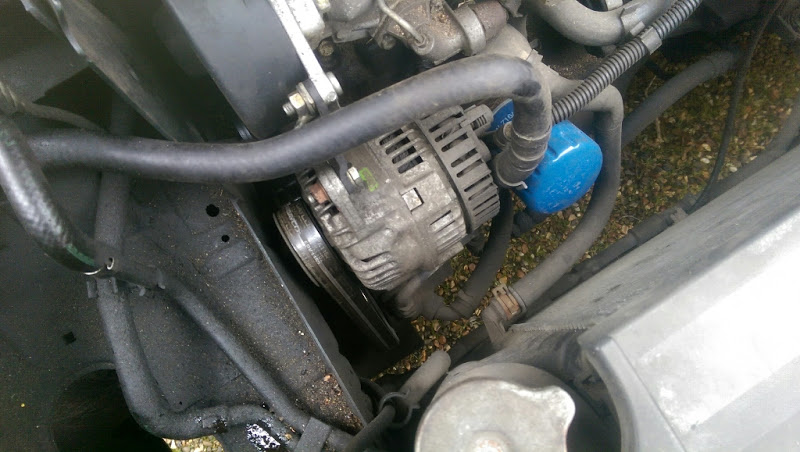

If the car feels down on power, check the rubber seals betwixt interwarmer and manifold. They go hard and leak precious boostus.

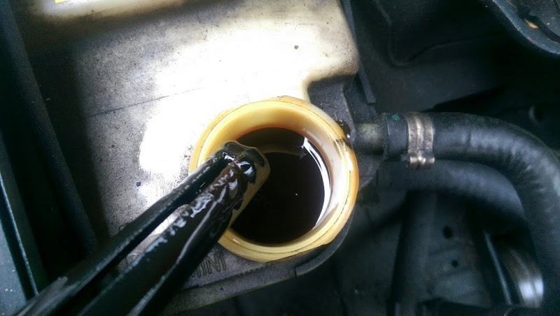

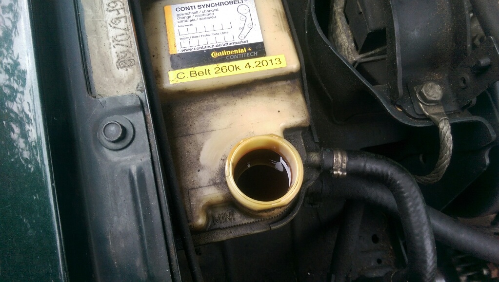

I had a quick look at the power steering at lunch too, the fluid does look like shit oil
(Thanks for the cambelt tools offer too, only 20k into it's last though!)

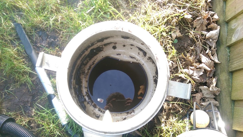

Is this the pipe I should look to drain it from?
which goes down to here
Yummy
I should hopefully have a bit of money to spend on it in feb, so apart from a general service which it needs, and a new exhaust, fitting and sealing ring, anything else I should have a look at?
Must give Dodgytom a list of stuff I want too, but I can't afford the postage atm, Tom, mind if I give you the list but we sort sendage out at a later date?
Yeah drain it from the exit pipe from the tank.
Run the engine for a bit whilst turning the wheel to pump any old fluid through.
Chuck the old steering fluid in the tank
I break up quite a few cars and the pas fluid and gearbox oil run fine mixed with a bit if petrol ☺
Just send me a list of what you want, i'll get it to you anyway.
Lucas power steering treatment is about the only cure in a bottle / bottle of hopes and dreams / snake oil that I've found to work

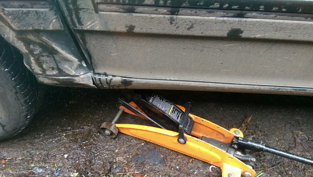

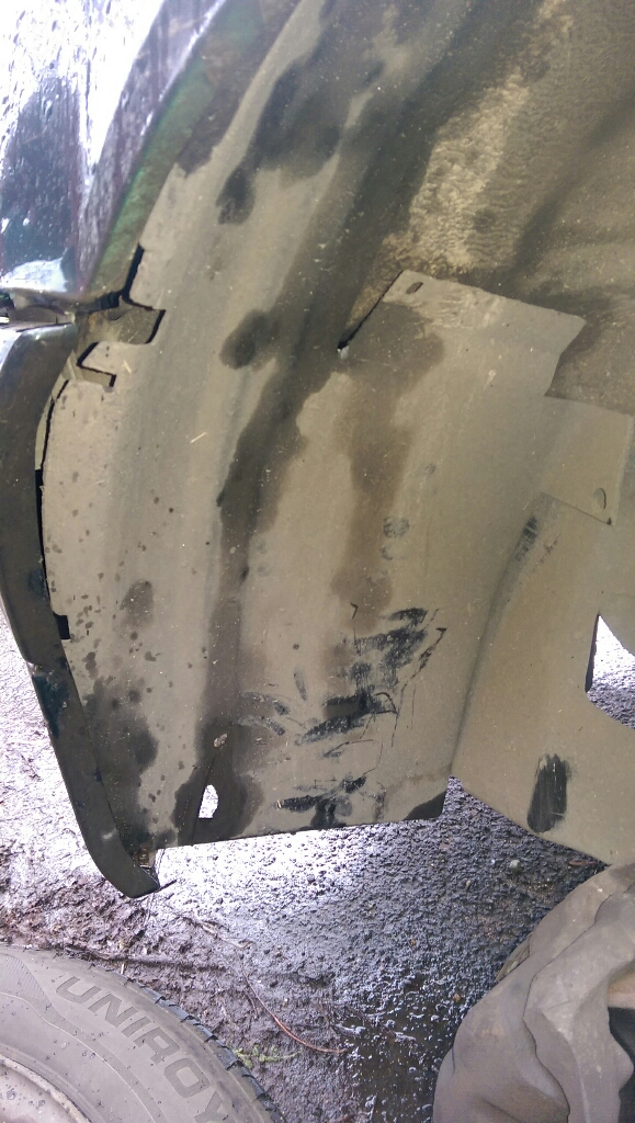

As you may recall, a week or so ago I hit a cat size deer, which had the annoying side effect of breaking the bit of twig I had holding the arch liner together. All was ok still, until last night when I took Eva to grannys for a sleepover. I found the bit by work that always floods, and drove through it at 45mph. Much laughs were had by all, but it busted the twig and the arch liner dropped, so I drove home with a scraping noise on left hand bends.
So I chose the BEST DAY EHAH to do something about it
The boy was in a gr9  mood, so Amy took him shopping
TBH it wasnt the job itself I wasnt looking forward to, it was the fact that everything is filthy, and wet, and shitty
I had to kneel in this crap

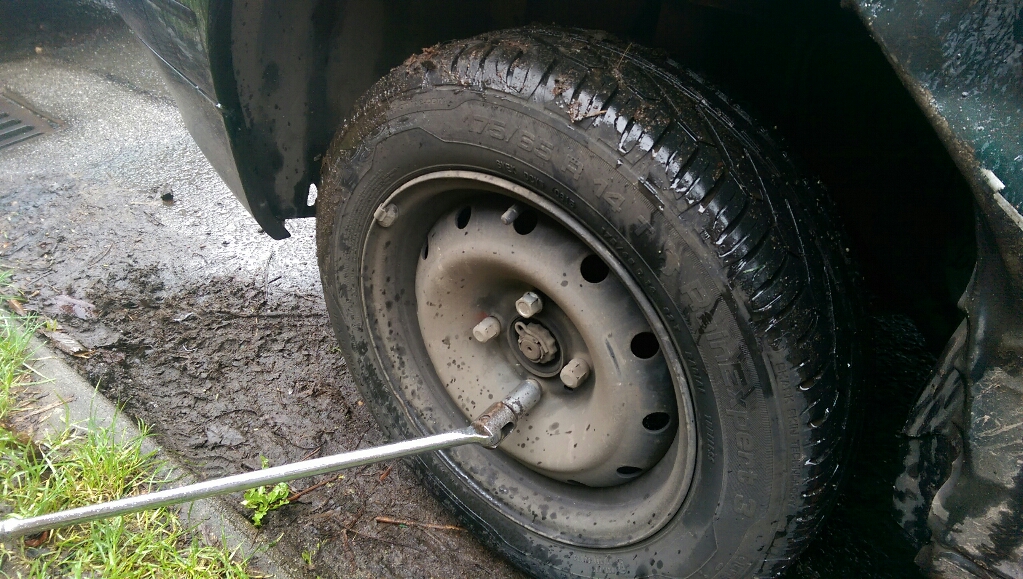

But the wheel came off. I want new front pads, these havent fucking worn in 2 years, and I brake a fair bit. I like pads to wear down and be obvious that they are doing their jobs. The discs look ok, are zx's light on the brakes?
General smeg

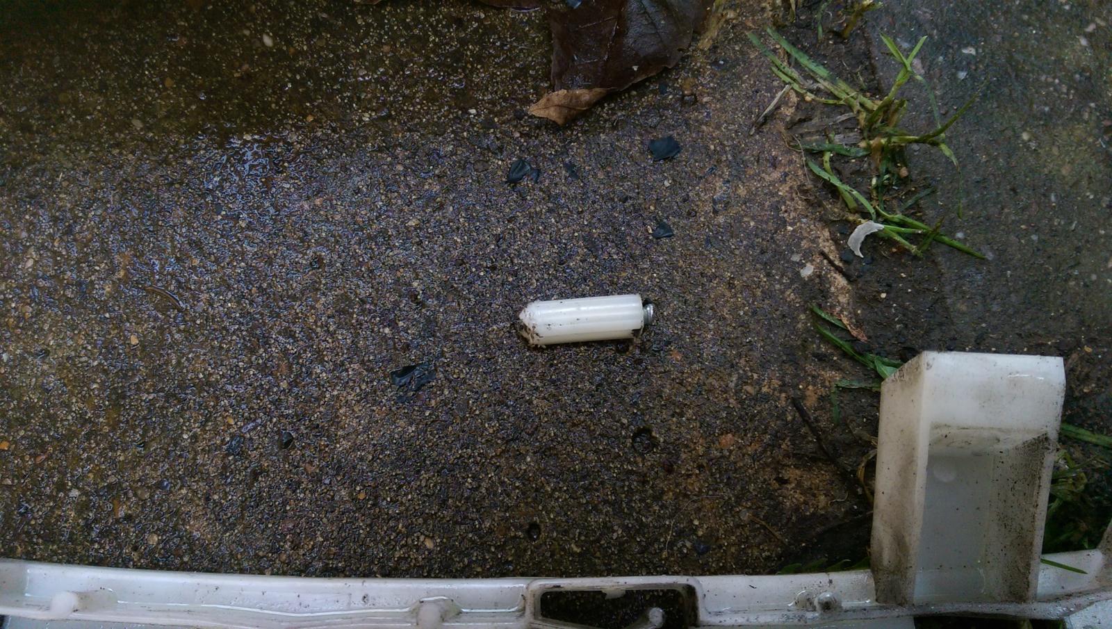

Aha, here's the issue!

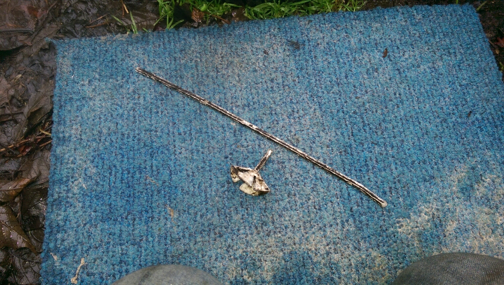

I tried to be clever by using the childs balloon stick that's been laying in the gutter for weeks, but alas it was not strong enough, as it was a + section, not an O that could be wedged in.
So a new bit of twig was acquired, this one had a handy bit of pokey out stick to hold everything in place
and hold it in place it does! It then pushes the front bit to where it needs to go, which in turn wedges against the stick stopping any movement
This piece is purposefully* wedged behind it's own bracket to provide rigidity

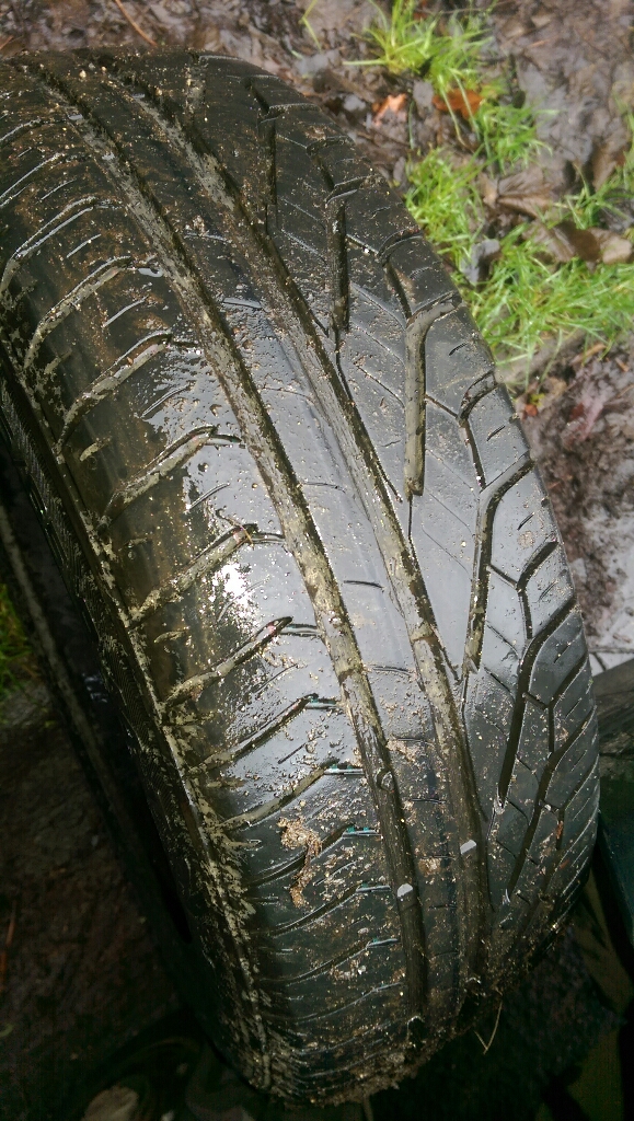

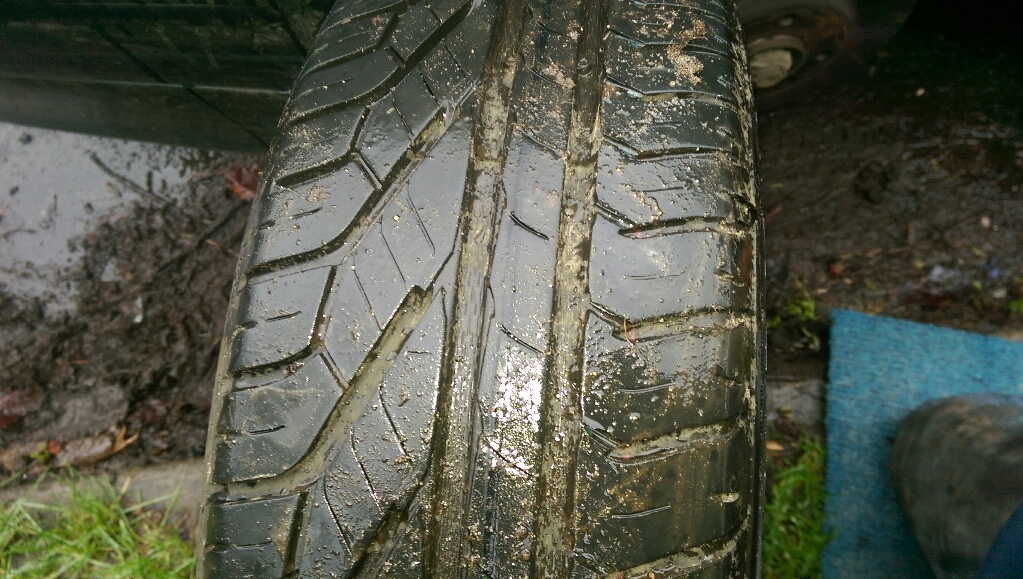

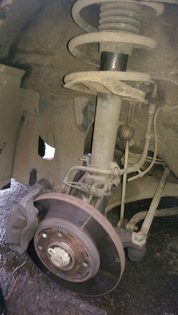

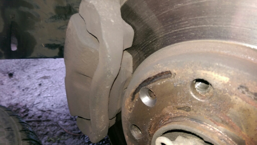

What wasn't so jovial was the uneven tyre wear on that wheel
The inner edge is wearing. Is this tracking? It does pull to the right, and the steering wheel is off centre. I've changed the track rod ends, drop links and lower ball joints, tracking seems the only thing left. What happens with tracking? Will they need the wheels off?
Still, never mind, it wont go bald overnight, and theres fuck all I can do until payday, so on the wheel went, and I packed up on the car, which was even wetter now as the rain had increased

Tracking is only about £20 or £30, but if your wishbone bushes are goosed there's no point doing it.

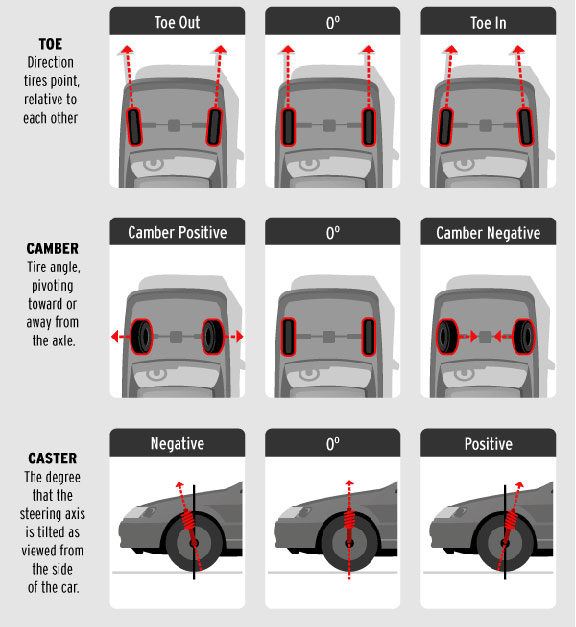

Wheel alignment refers to three basic angles, as shown in the picture below (stolen from the internets) :
Those angles are determined by the design of the suspension and are found in the manufacturer's workshop manuals.
Tracking usually refers to the adjustment of the toe angle, the other two angles are not really adjustable in most modern econoboxes.
Toe is usually adjusted by altering the length of the track rods. It's a fairly simple process that can be done on a flat driveway using a ruler and bits of fishing line. Most garages nowadays use laser-based equipment (remember that a laser beam remains perfectly straight over long distances) which makes the process faster and less prone to operator error.
The wheels stay where they are and my local tyre place charges £30 (which is on the salty side) for it.

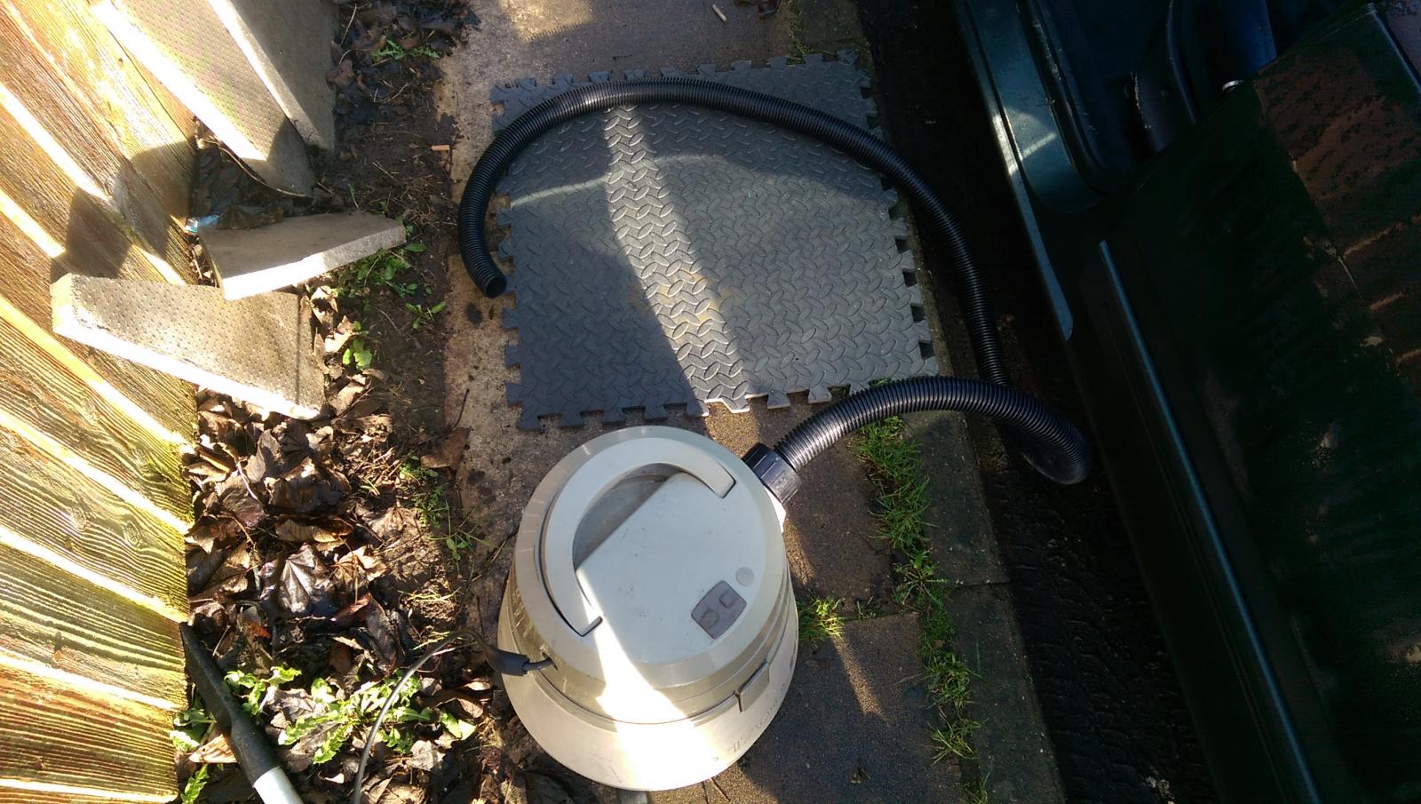

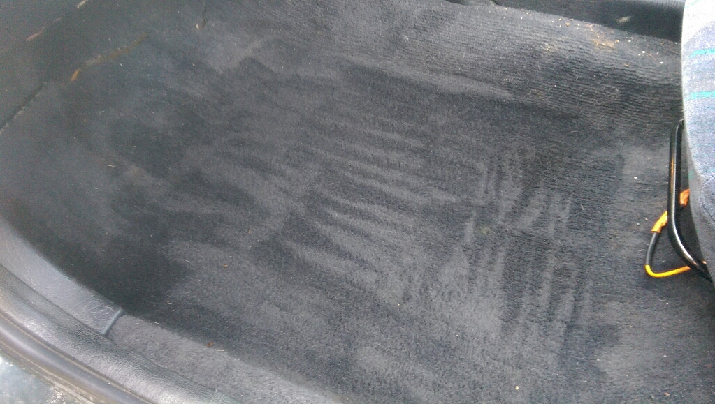

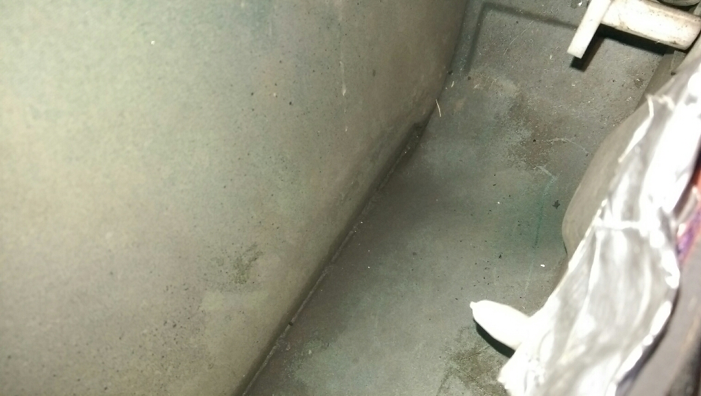

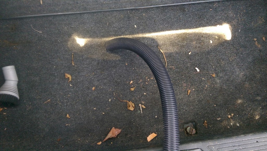

It seems the season for leaky chod is upon us! Noticed the front footwell was underwater too yesterday
So, out with the Hoover AquaPlus

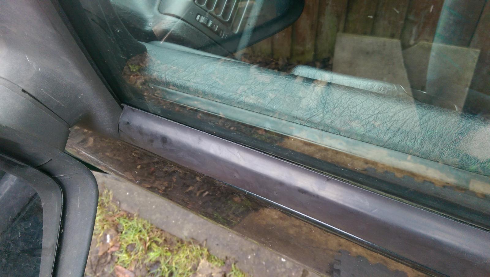

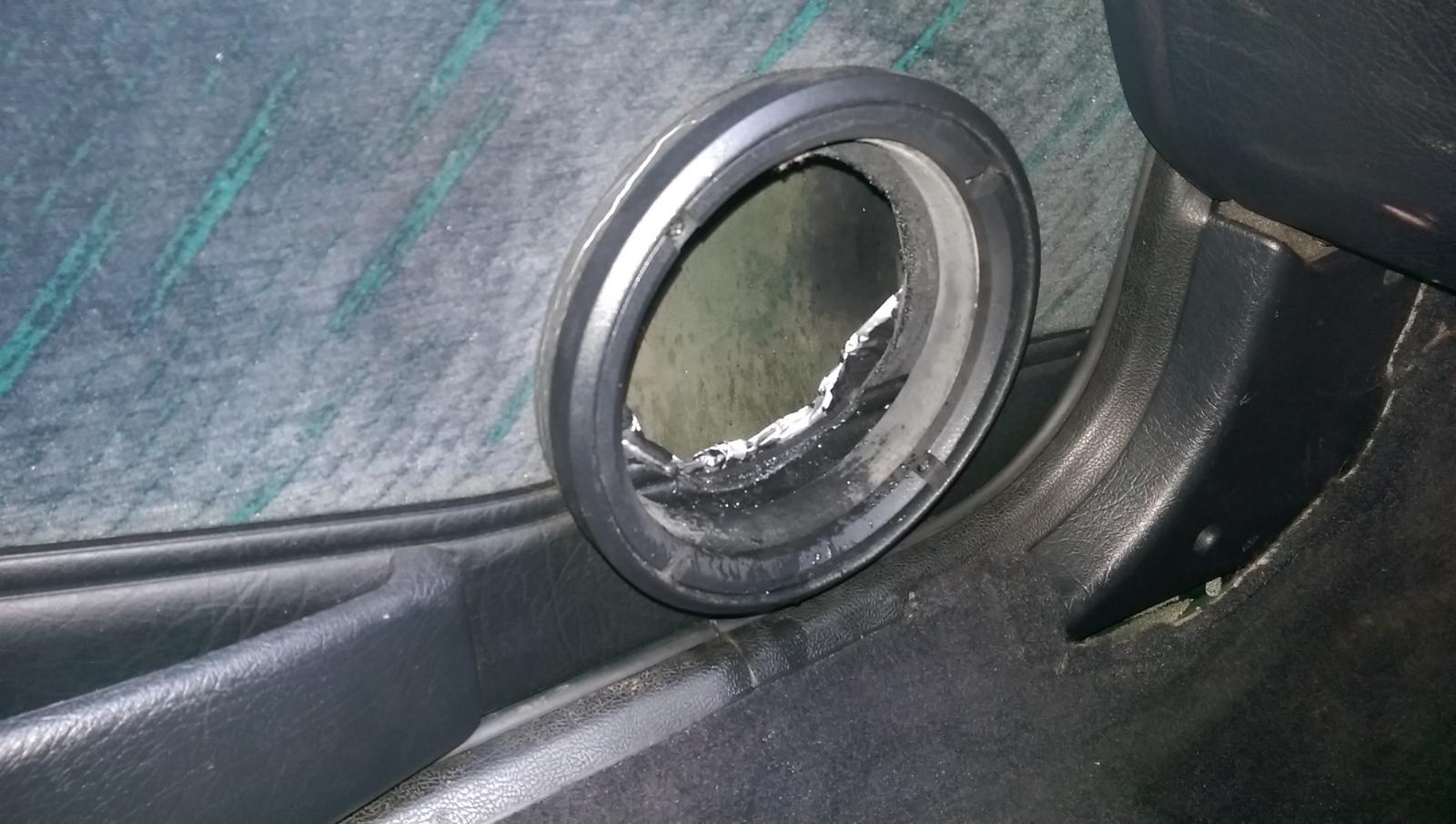

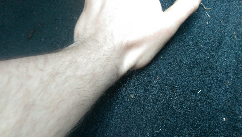

I checked my doors for water after 320tourings waterfall. I could handily* get my phone all the way in the door
using this handy access hole caused by old speakers
Nope, dry as a bone. I took the rear speaker grille off as well just in case
Nope, that all looks fine.
So, my thoughts are turning to this
Which has never worked in my ownership, the previous owner said it worked, but went back at an angle and fucked itself up so I've left it. Can't say I've ever used sunroofs in cars anyway. I've ordered some sunroof repair kit to see if I can fix the issue. Otherwise, the water is coming from underneath, and it's not got a hoel as far as I can tell

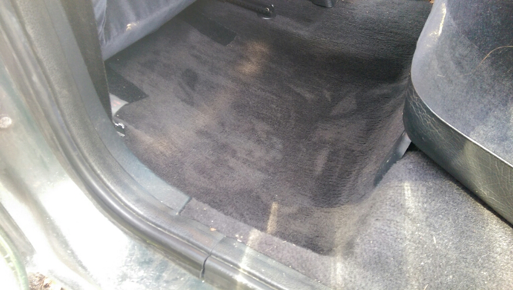

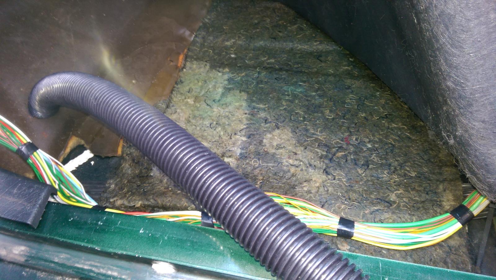

I vacced out the rear footwell as well
Then, because half the car was spotless, and the other half a skip, I put the AquaPlus back in the boot for mid-week water removal, and got the AquaMaster out (cos it was dry and had its filter fitted) and vacuumed the rest of the car out
which was bone dry. Only the passenger side of the car floods. If the sunroof repair method does not work, I'll have to do some more thinking. It's wet again now in the back after the rain overnight. But I don't sit there when driving it, so meh.

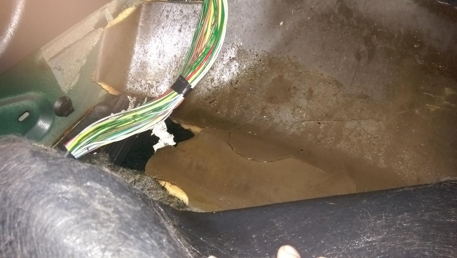

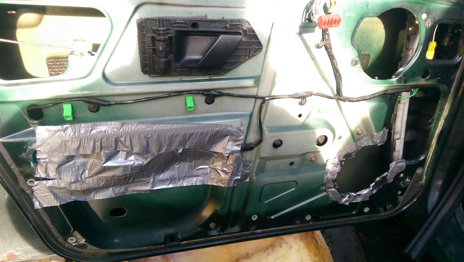

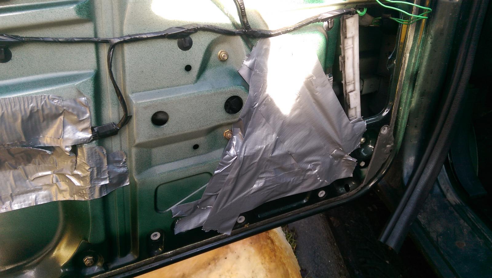

I had the morning to myself, so went out to the car

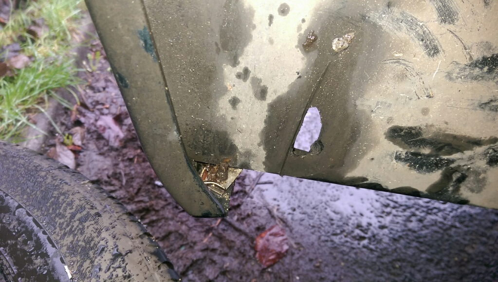

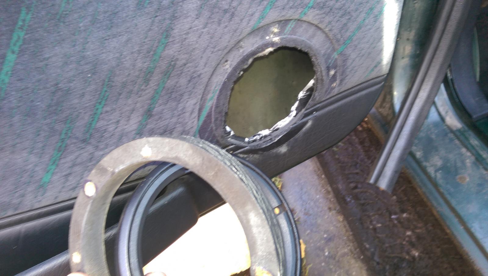

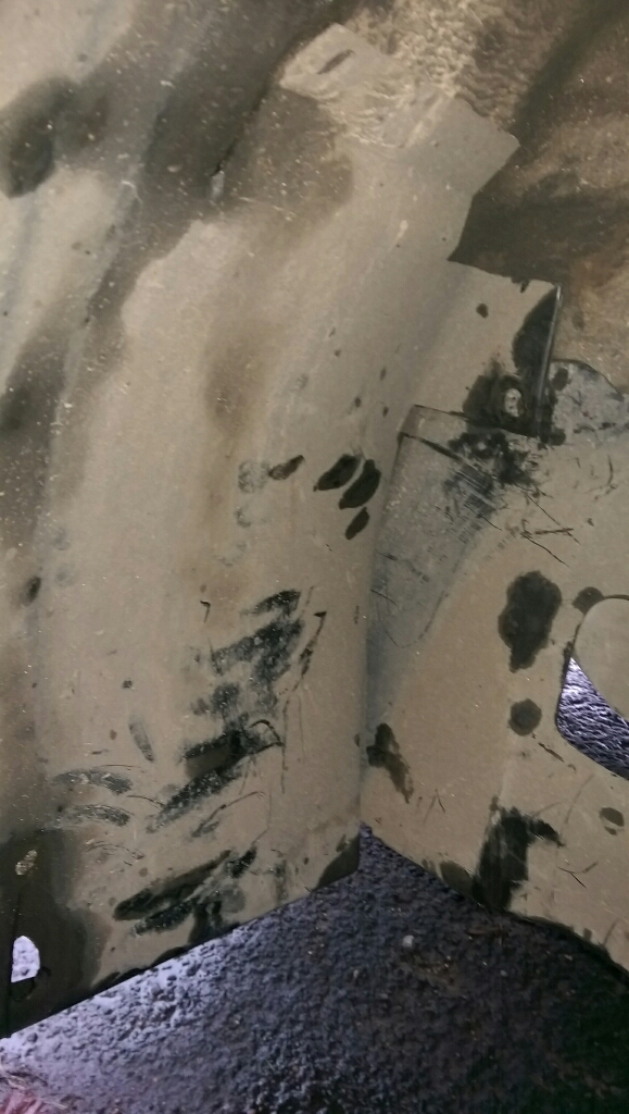

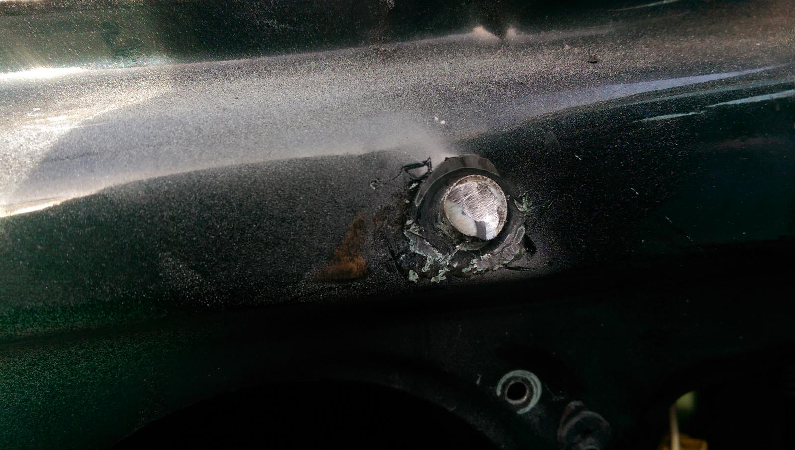

The aim was to get rid of this hole. I went out and bought the shittest roll of gaffer tape known to man this morning especially
It was rather wet in/under there
Time for a 1989 Hoover AquaPlus 1700 (too rare for me to be doing this crap with it tbh)
Because I tore the carpet taking it out that time, I could peel it right back and remove the section of underlay that I also tore last time. Handy!

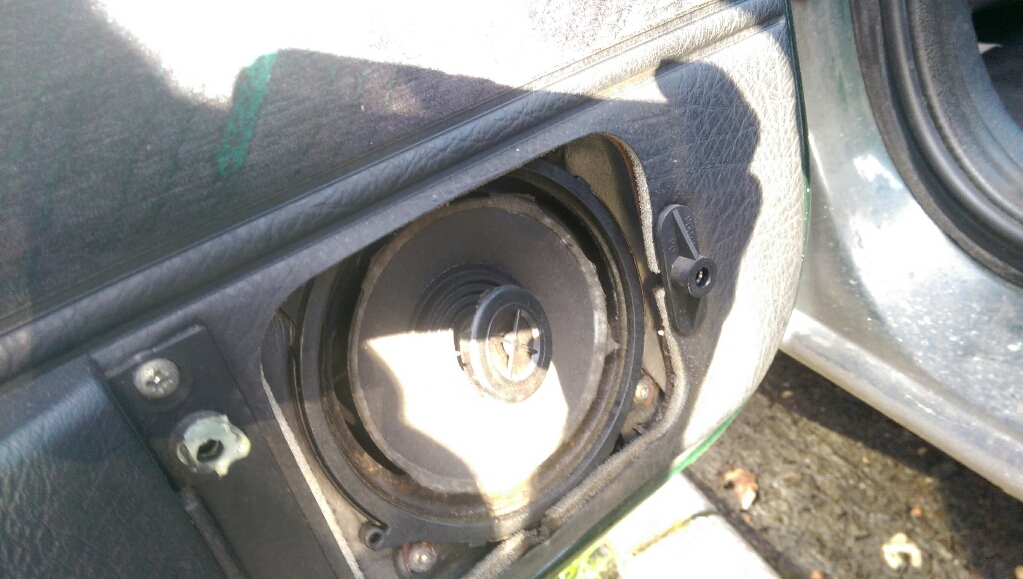

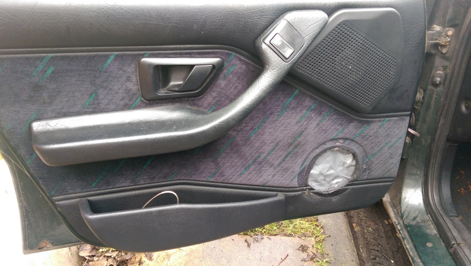

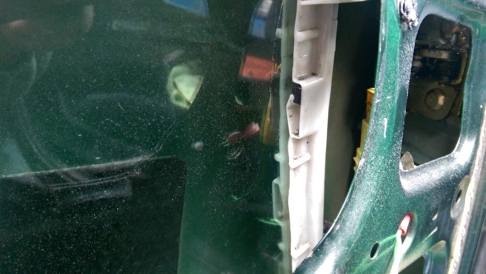

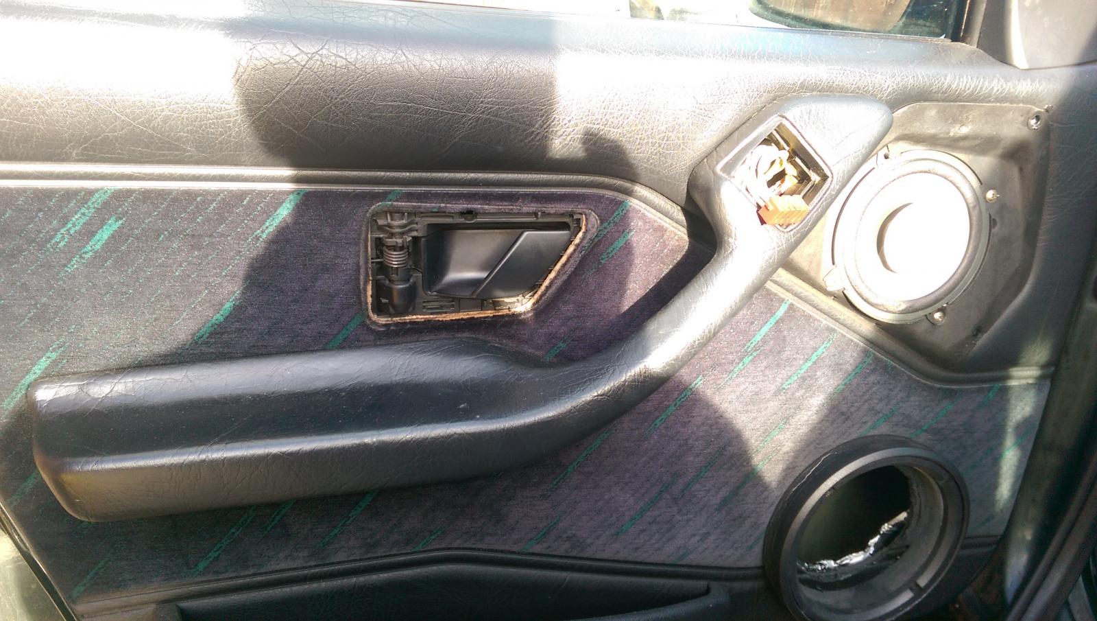

Started taking the doorcard off
Took this crap off (anyone want them? no idea what size they are)

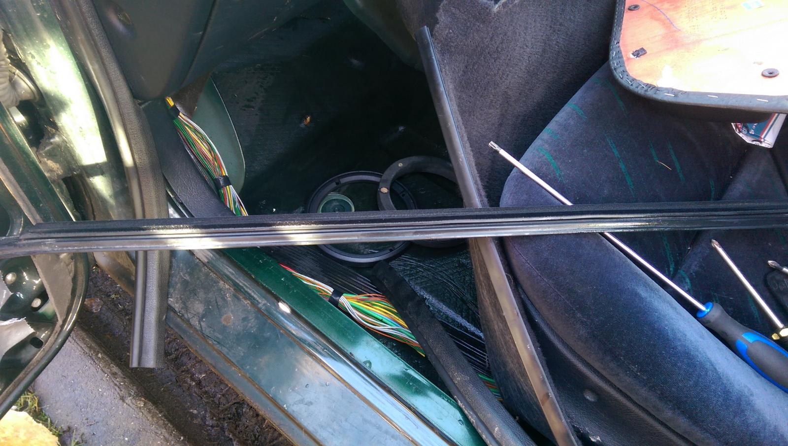

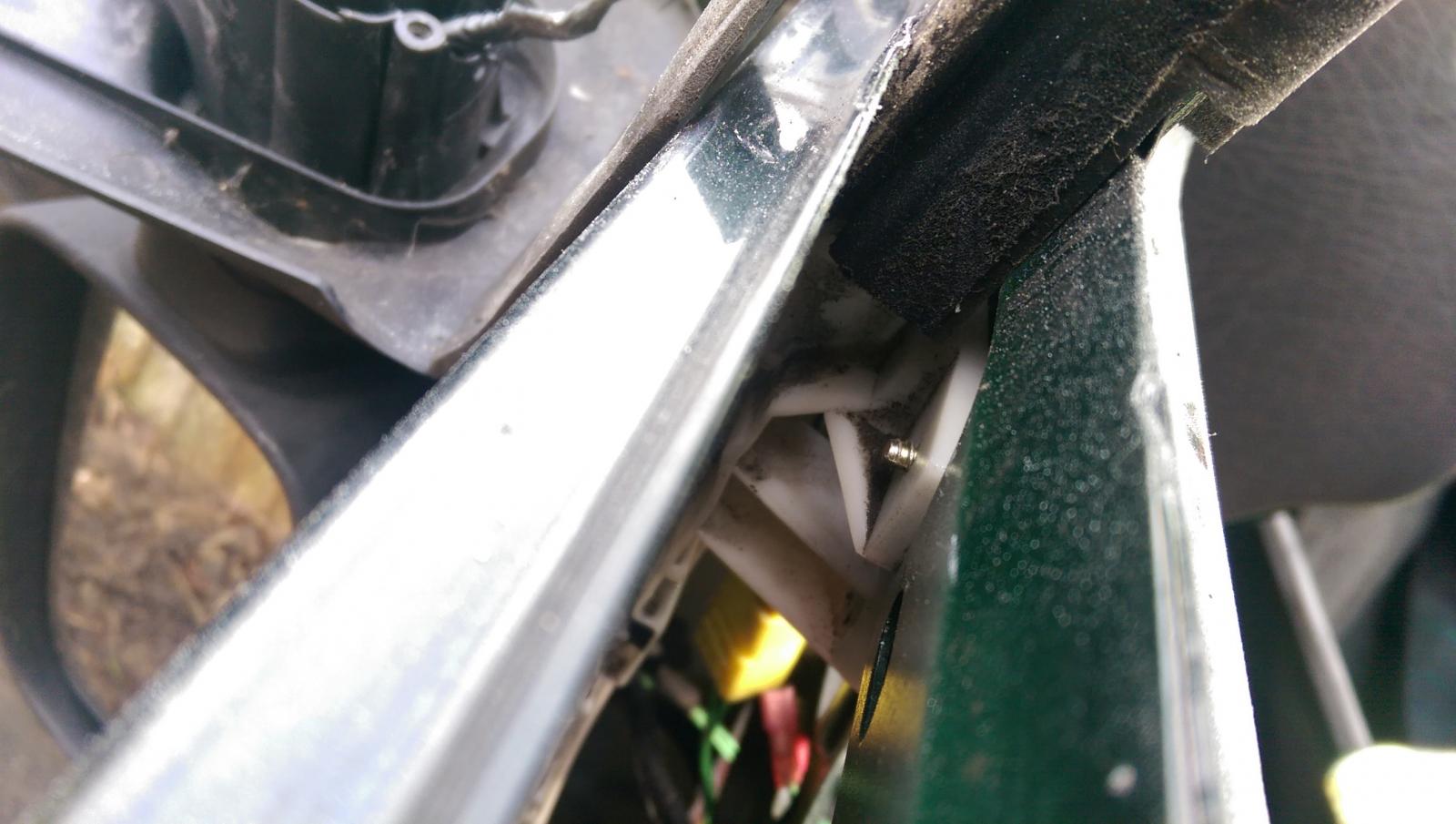

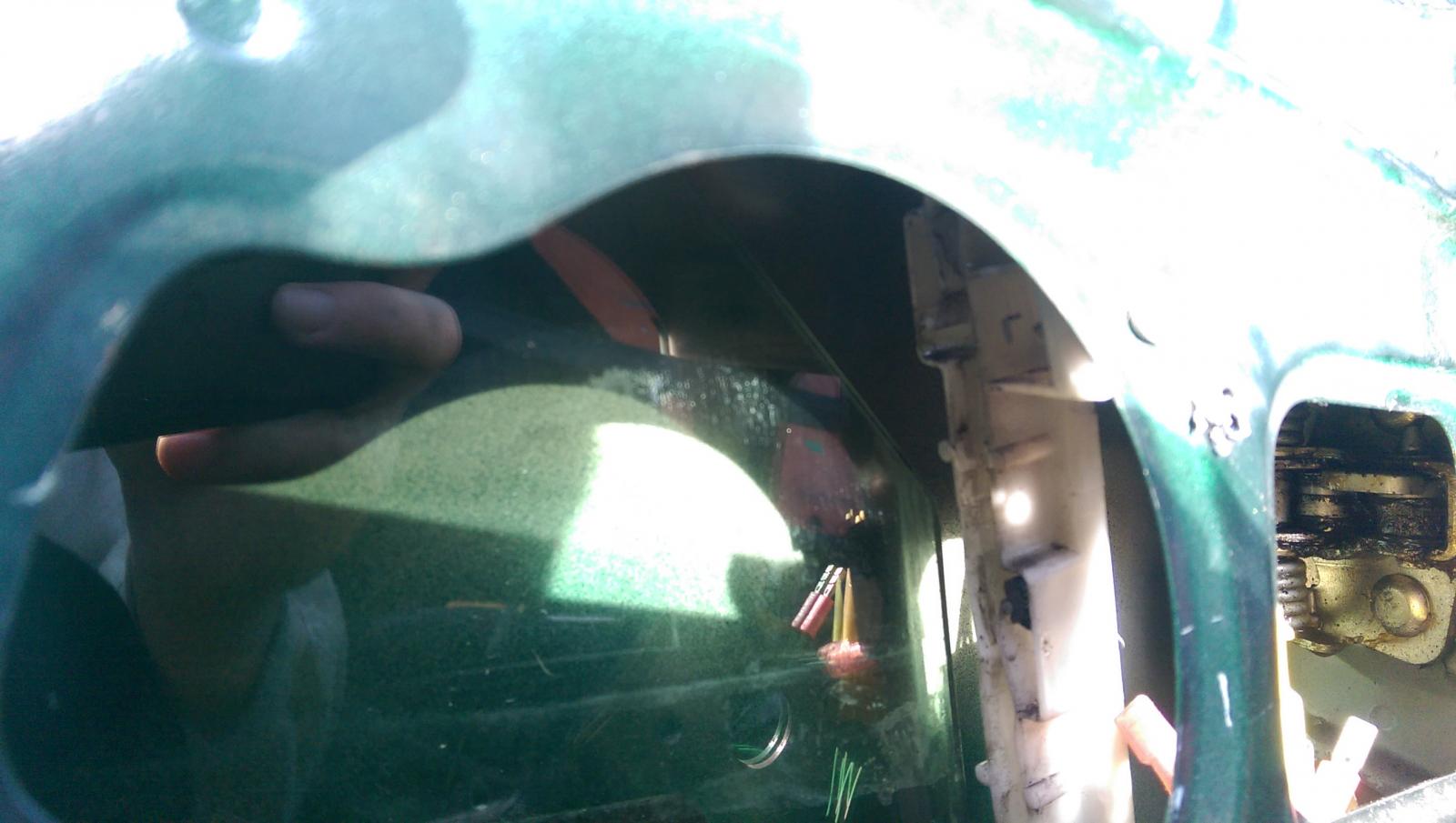

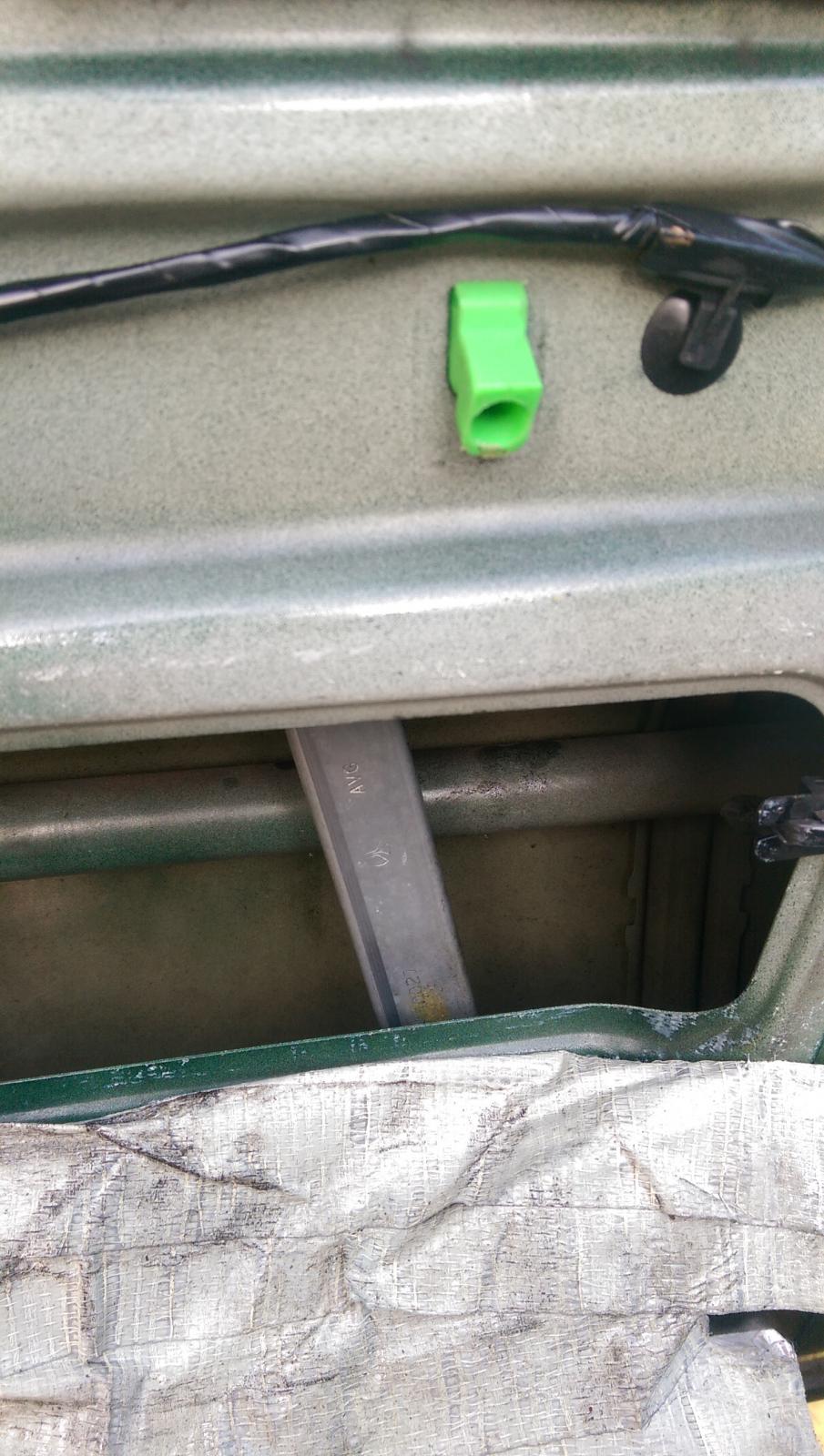

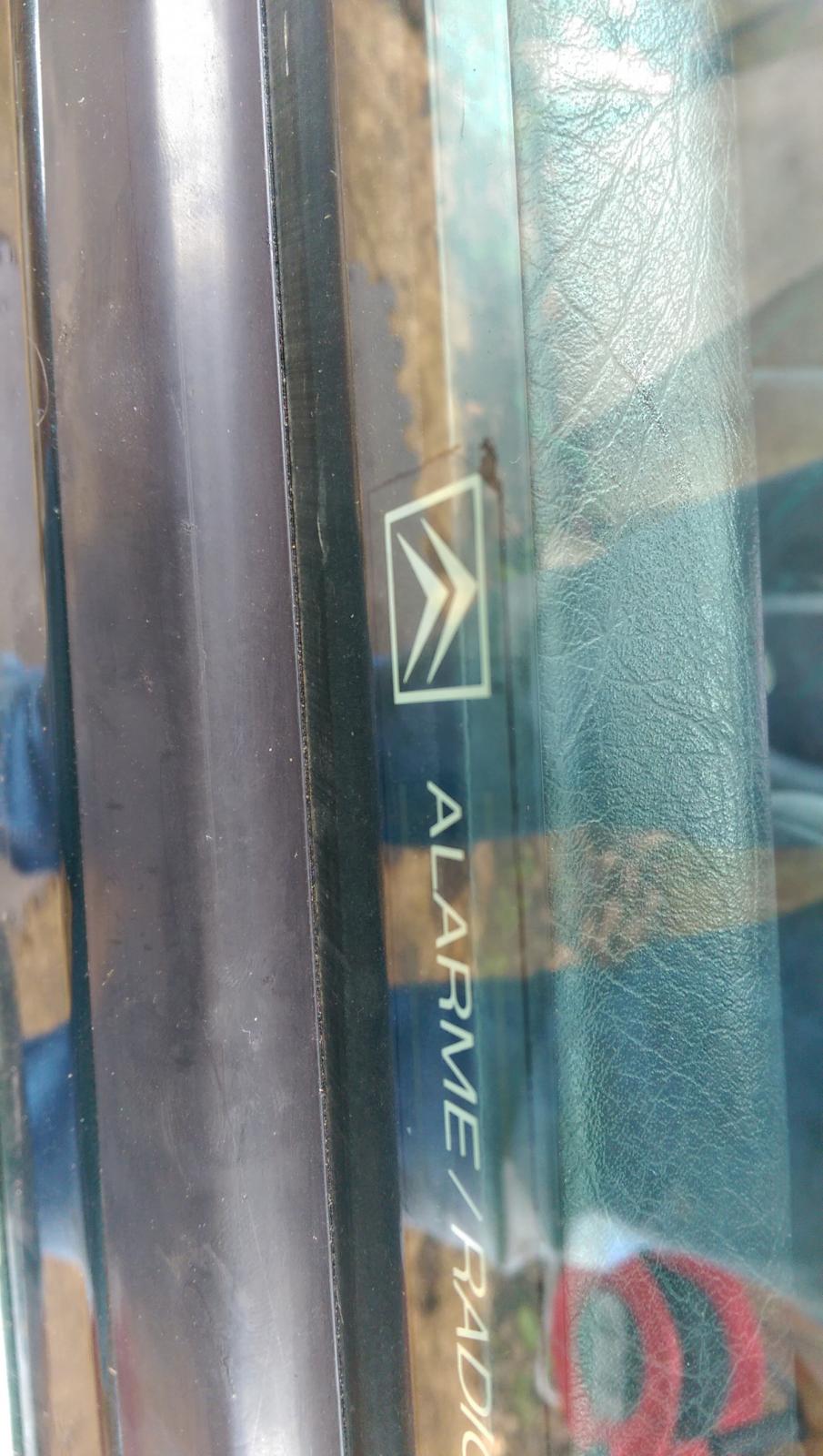

Hole fixed, I decided to have a look at the crap window seal. Removed the outer one, it is fixed onto the top of the door like a door rubber, so lifted off and slid out of the broken end clip that holds it to the body
It was here I noticed that the glass wasn't actually in the runner, no wonder it didn't like going up and down
The top screw thread had snapped off the guide piece, and I couldnt grip the remains inside the door to unscrew it. This being broken meant the top of the guide moves, and the glass comes out
So I got my shit dremel out and ground the head off the screw

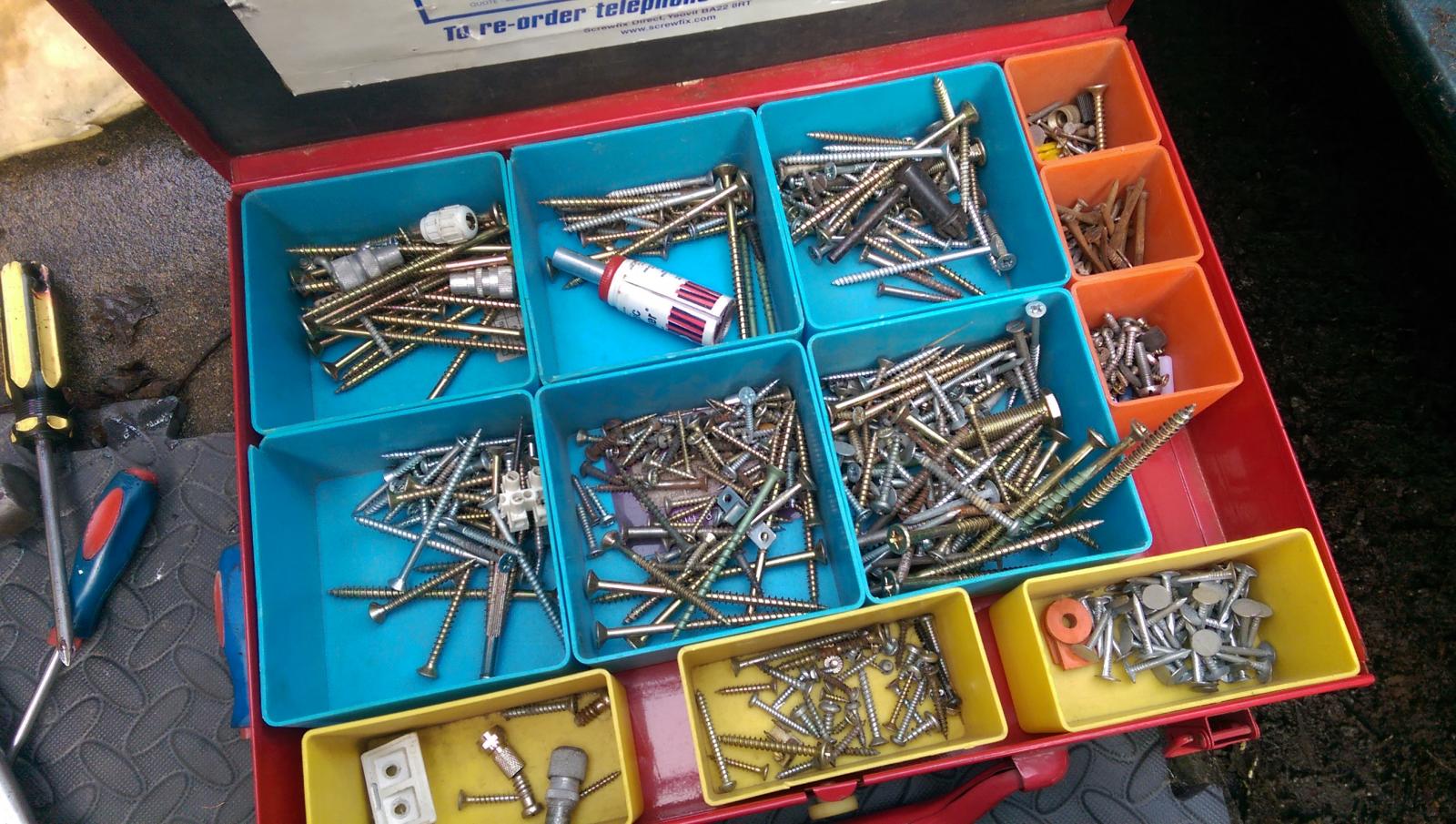

Went and got my box of random screws and found a suitable replacement
and found one long enough to screw into the hole left by the snapped standoff bit, and grip it enough that once all the other screws are tight it doesn't move!
This made the window not jump out

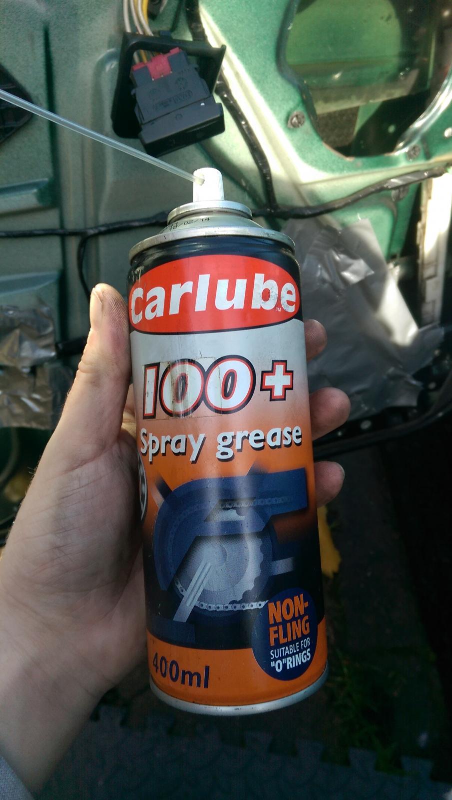

Window running alot happier, I got some lubricants out
and lubricated the centre shaft, and spray greased the cables, door lock and door handle innards, the door check strap and whatever else I could find that moves
The window worked really well now! I could bend the part that touches the glass out on the door rubbers, so spent time fettling it just so, then cleaned up the corrosion that it causing the peice to look shit, cleaned up underneath where it was, ran a thin line of tiger seal along the door where it clips onto so it held on and put it back on
No idea if that was the actual cause of the wet carpets but it looks better now its done!

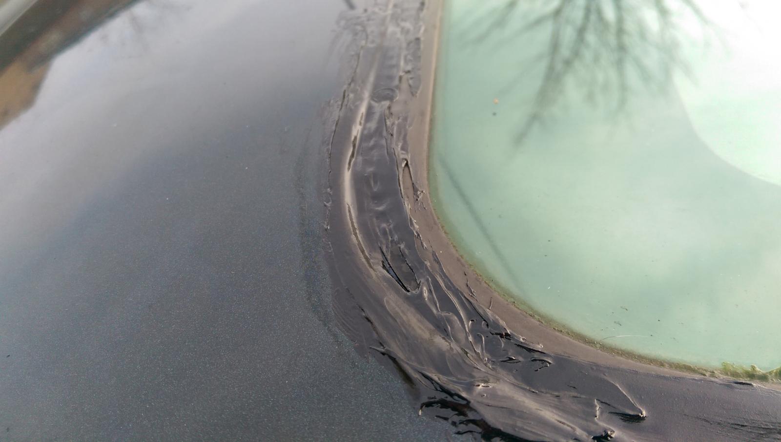

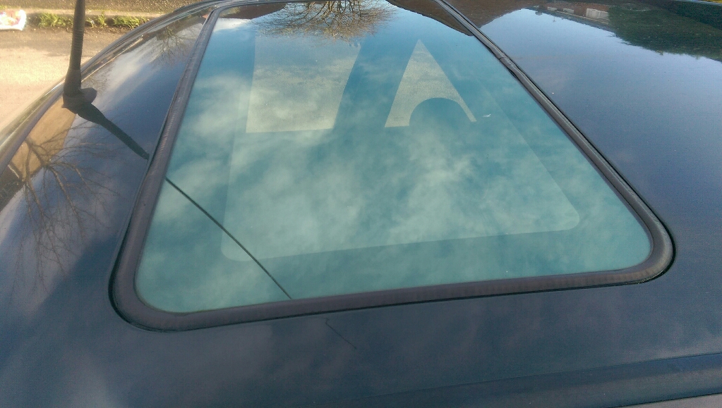

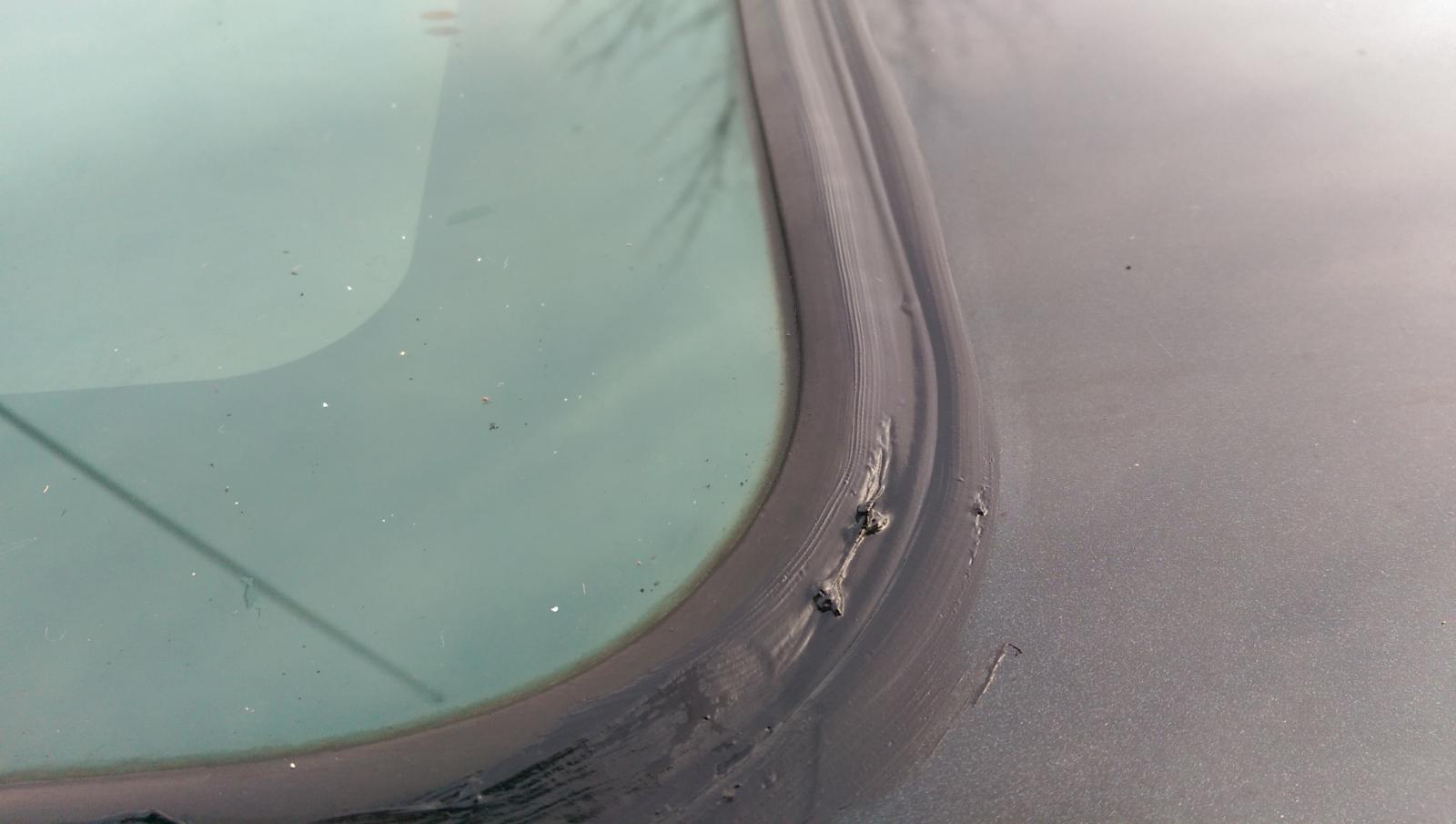

I then sealed the sunroof
The sunroof is up slightly at the front, I can push it down and it pops back up, which may not help so the rear sealed up neatly
but the front doesnt look so neat. The felt seal of the sunroof was very wet and the gunk didnt adhere to it well, so I did as much as I could before it started to peel when I smoothed it, and I'll put another neater layer on when this sets, so the top layer has something to grab onto

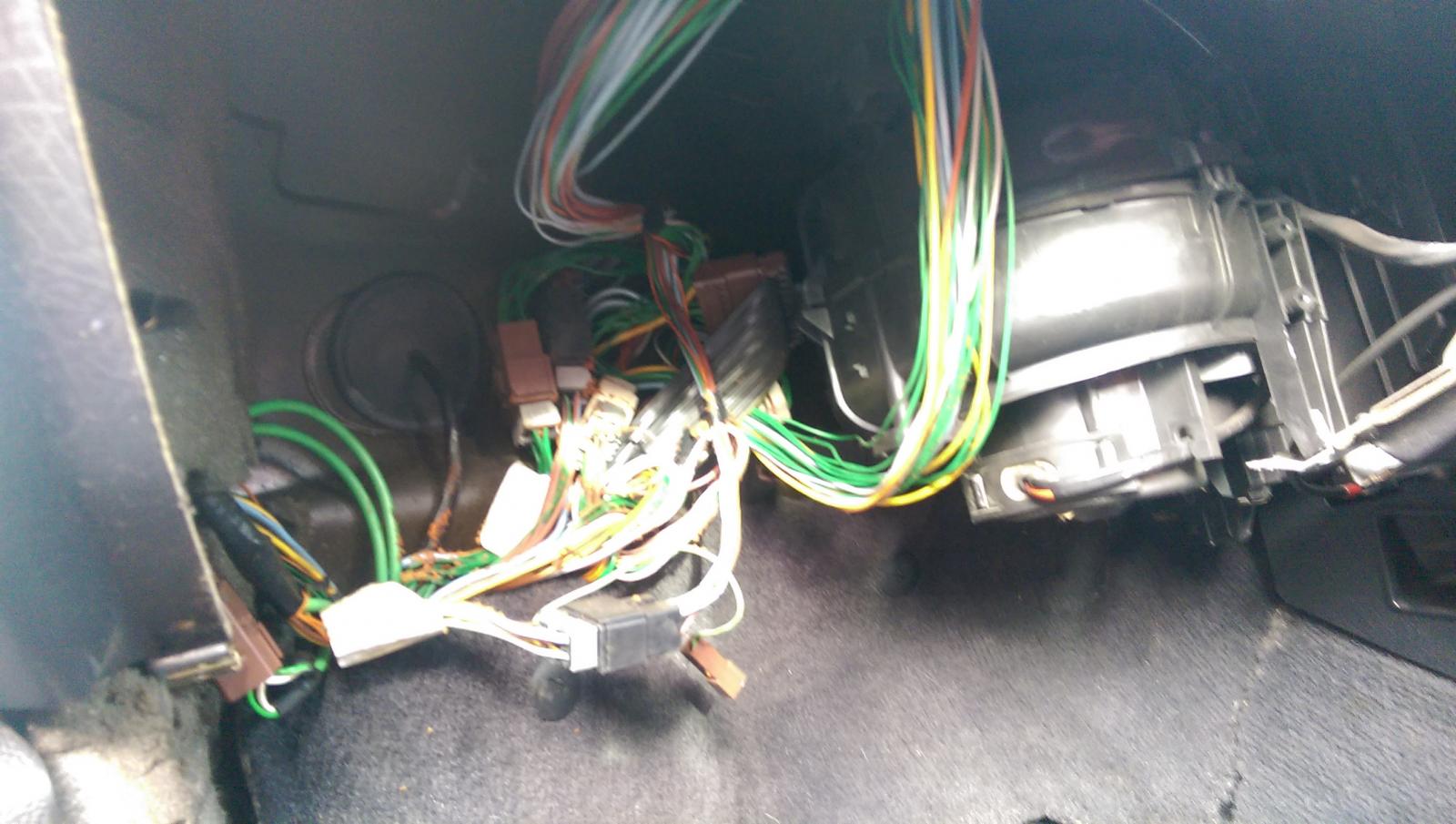

I then took the glovebox out, which enabled me to cable tie the massive nest of wires up out of the way so they dont keep falling into the footwell

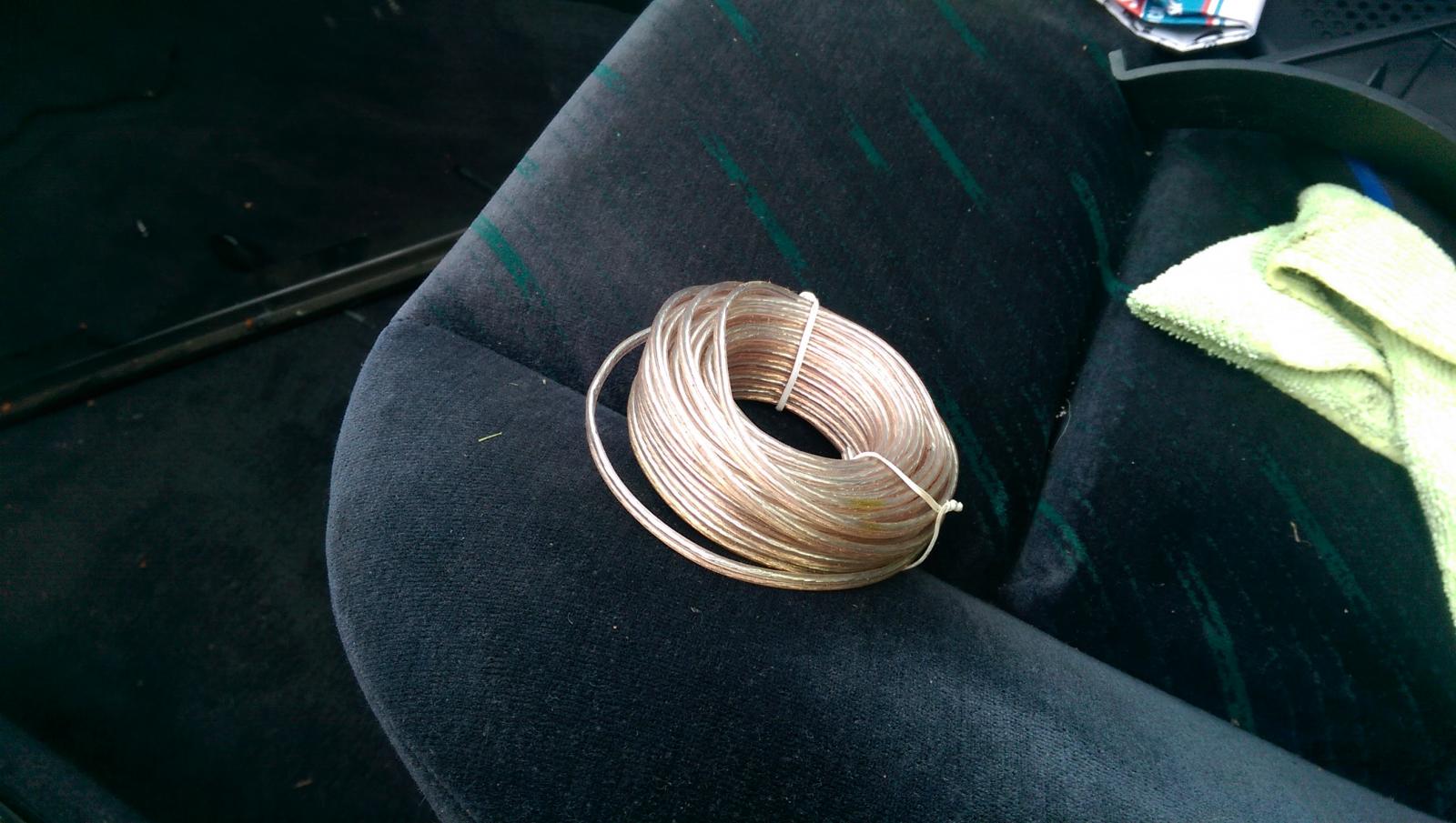

and enable me to start doing something I have wanted to do for ages, which is run new speaker cables. The thin, green, stiff factory wires work, but I want to replace the rear speakers at some point, and new cable may make it sound a bit better, plus the front doors did have speaker wires in for the speakers that were in the holes in the door at one point (speakers were not fitted when I bought the car), so there were holes in bungs for a cable anyway
I found out doing this that the front left and right speakers were wired the wrong way round into the headunit... so fixed that too. It did sound slightly better
Door card back on, and it looks much better! Amy came home at this point though, so I packed up, and will do the drivers side door in the same way at some point, and run a new speaker cable to there. I think I'll have to take the front seats out to do the rear doors though, so will do that when the weather gets a bit nicer.

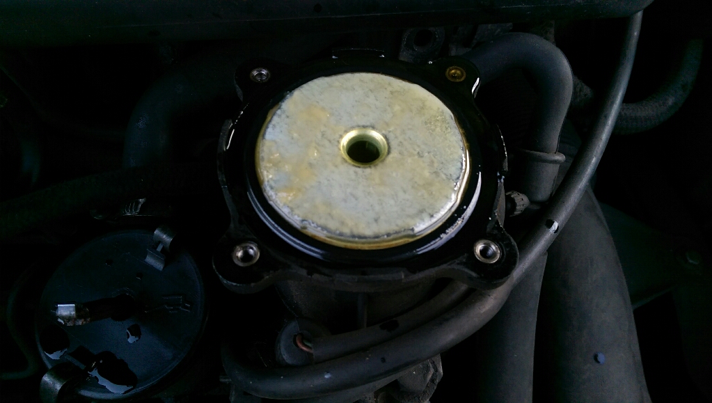

As per the Grumpy thread I am having fuel issues...
Symptoms are:
When the revs drop below 2k they die, and the car dies and is a bastard to restart. This is especially fun whilst doing 40 around a sharp corner, or coming off the M40. Through the use of lots of revs (which I don't like doing) I got it home.

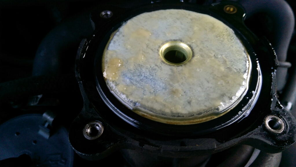

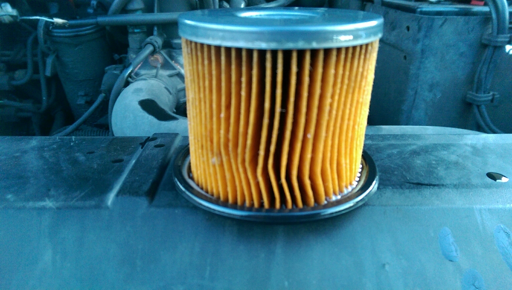

So, the first thing to check is the fuel filter. New just before/after crimbo, I cant remember now...
Oooh look, lard...
But the filter itself wasnt too bad, didn't feel waxy, the deposits you see are from my hands after cleaning the top off

The idle is sitting high as I made it so incase it helped. After refitting the filter I pumped the bulb hard, and it fired after 3-4 seconds of cranking, still more than it ever used to need.
I have tomorrow off to accompany Amy to the hospital, so may have a look at the tank filter. Is this a case of seats out, rubber cover off, unplug stuff, bash the locking ring around and off and lift out? Do I have to remove any pipes/will I need new jubilee clips? I don't have one of those clip release tools, should possibly get one if anyone can link me to the right one...

Yes, chucking diesel in will help a lot, thin the fuel and cancel out the gelling of the oil you have in the tank. Mix it in the tank by ragging it around a few roundabouts or something.
A filter can look perfect but still be clogged, it's always worth keeping a spare especially when XUD fuel filters are pennies.
