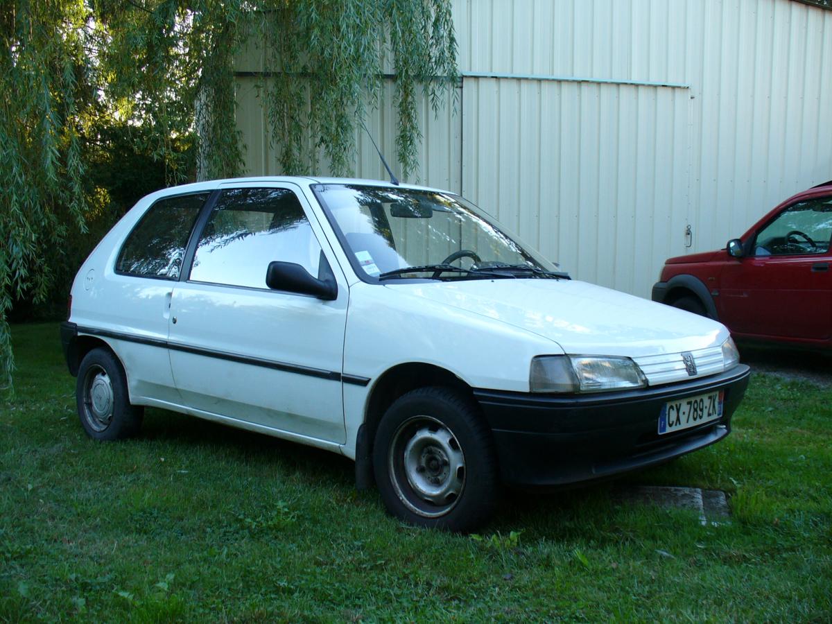

I have had an AX diesel and several 106's, of both 1.4 and 1.5 flavour. The 1.5s seemed to go a little bit better but not enough to be massively noticeable, however both 1.4s shat their head gaskets while the 1.5s took the same abuse in their stride.
The AX is lighter and flimsier, but nips along nicely. I wouldnt discount a 106 though, they are pretty basic too and the slightly better build makes them much more pleasant to live with.
Neither are particularly fast in a straight line, but trot along well enough in traffic and assuming decent tyres, will corner very well indeed. You get the good MPGs by keeping momentum up and never slowing down for corners.

The latest one I had was this little sweetie, which was given to me for nowt. It had been spanked on one side but a new wing and door from the scrappy sorted it, and it was pretty minty inside and out. It even came with a wee notebook started by the original giffer owner in which he detailed every single thing from purchase....servicing, tyres, replacement parts, even each fuel up were all noted with mileage, date and costs.

My 106 and I just returned from a camping trip in the New Forest. It did 435 miles at a reasonable 70/ 75mph and returned 68.1mpg on that tank.

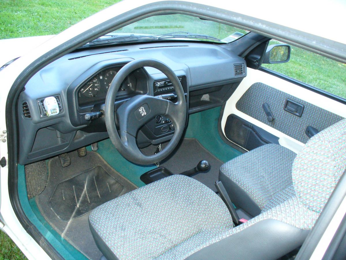

Try sitting in one before going too far down the road of buying one. I absolutely hate the driving position as the pedals seem to be in the middle of the car. 205 is much better in this regard and blue really is your colour. (I look forward to receiving my commission Billy).
I recall you ranting in another post about the driving position now that I think about it, will keep this in mind and might become one of these test pilots I always hear about on ebay.
I think I've now established that the 205 is the better car, however it really depends what comes along cheap first - depending of course on the AX pedal woes as that does sound hateful.
Some get on with it fine. I like a straight driving position though, especially if blatting up motorways.
