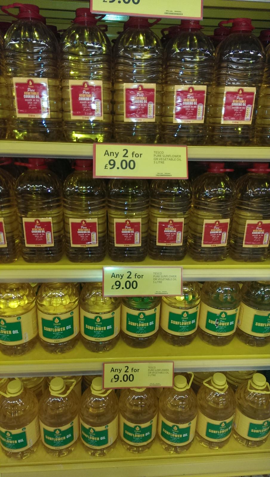

At morrisons again, in the world food aisle. 3 different types all a fiver for 5 litres.
Tesco have the 10 for £10 thing on permanently. If possible, I get the sunflower variety (round bottles) as it seems to cause less problems in cold weather, although that could be my overactive imagination.

Seriously though, soya oil is bad for thickening up and clogging injectors and filters in cold weather - I think the stuff labelled "vegetable oil" is actually a blend of different types, and since making a point of only getting sunflower oil (same price) I've noticed better cold starts.
