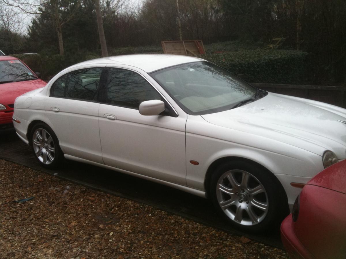

which is the early and which is the late?  Did they do the same thing on the right hand drive one?
is the bottom one available with the V6 diesel engine?
No. Top one is late and that's the only one with the 2.7D. My old boss used to have one, it shat a gearbox (automatic) during the lease period, but it used to do 40mpg no bother.
The top one is the late one, the electronic parking brake gives it away.
