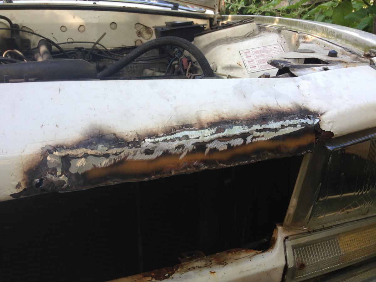

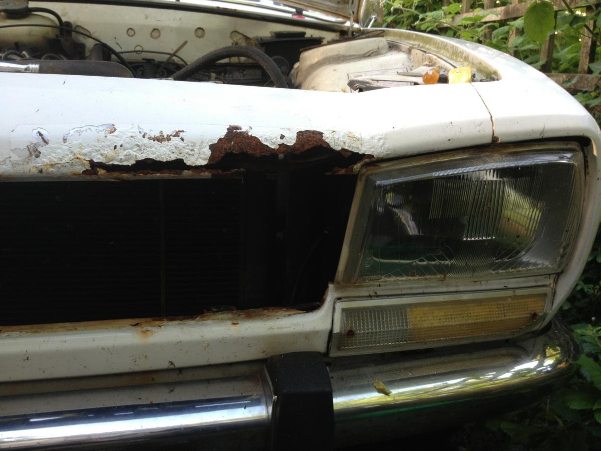

It was inevitable. Sooner or later I had to face up to the fact that there was increasingly less metal in the body than it left the sochaux plant with. Where to start? In the end I decided to start at the front and work back, so letting new steel
Into the disintegrating front panel is the first port of call with the 504's disintegrating body...
  • Like 9
I might be wrong but aren't pattern upper front panels still available for these Nos?.......
wob and potato sack would be more of a period style repair
I think you may need a lancia welding specialist on this...
Good luck the car is worth the hassle
Yes, they are. After having a go at making repair sections and letting in new steel (the remains of a triumph spitfire bonnet in BL 'topaz')......
I decided though this went reasonably well, the tricky curves of that panel and compromised first attempts at welding meant a NOS replacement which simply bolts on made better sense.

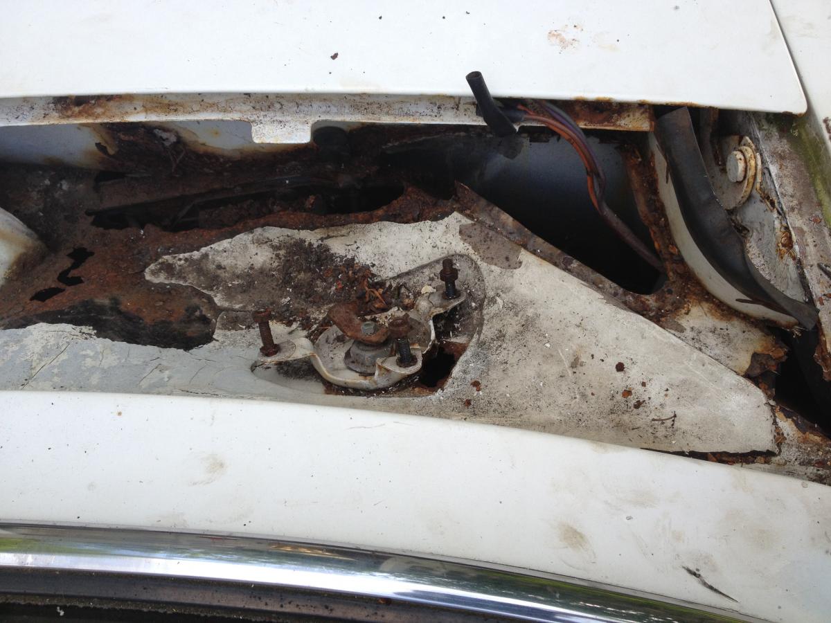

Ive picked off some of the smaller and more accessible holes in the bulkead just to get more practice at fabricating and letting in repairs (yet again more topaz spitfire)....
The other bulkhead repairs will take rather more skill and time.......
Thats going to need the dash out and the pedal box and brake master removing and all of a sudden an immobile rusty heap on the drive.
