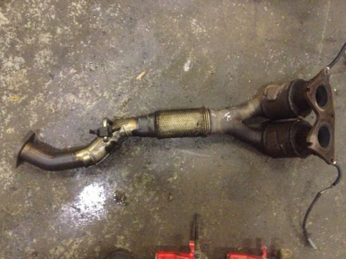

Took it in for mot yesterday,failed on airbag light,blow in exhaust flexible near cats.
numberplate bulbs,
Emissions believed caused by exhaust blow.
Can get replacement flexi pipe.
but airbag light may be a problem.

What were the emissions readings? Usually an exhaust bow will send the Lambda high.

Exhaust is going to be a problem as it is flexible part behind cats that is blowing,nearly £200 new.
Get a repair section and get it welded in.  That's what I did with the Vectra, which was also blowing from a front flexi - new genuine section for that was £330.  Repair flexi was about £22.
Unfortunately flex part is a strnge very flexible section that is square at on end and oval at other so not possible to replace.
Got one off ebay for £90 delivered,Also ordered pedal rubbers etc so should be back for mot in about a week.
