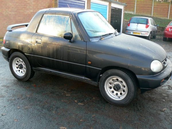

Oh. Two seater. Were they all two seaters? If so, damn good answer by Suzuki to a question absolutely nobody asked.
