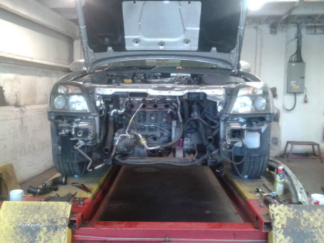

Bumper of first, and discover why the aircon doesn't work (the bottom of the condensor has rotted off).
And then some more extreme stripping occured.
I didn't take many pictures as i was on a roll, but highlight include pouring a pint of treacle out of tbe intercooler and then having to use a gallon of petrol to swill that and all the air ducting clean. A horrible shitty job and a reminder of why i've never really bothered with diesels.

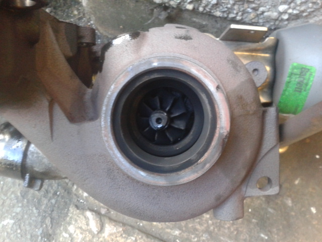

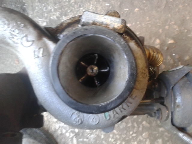

Anyway the result was this, i put my finger in the turbo whilst still attached to the car and found it to be turning freely.....but hang on is it not meant to have nut on the end?post-5712-0-18176600-1492335022_thumb.jpg
Pacman turbos good at eating themselves.
A turbo shouldn't be to expensive for this.
This is when i took the bugger off, my arse started to go i had visions off having to take head of to find piston mashed to death an errant fastener, it wasn't in any of the ducting or intercooler, so the search began.
I don't no how good the image is but the shaft has snapped on the turbo and the exhast side has buried it self in the housing.
What caused this i don't know, it's always had a loud whistly turbo. Even now, the new turbo is the same.
I'm hoping the nut came off jammed the turbo and caused the failure.

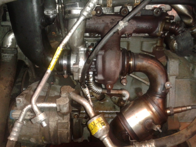

So i spent good friday stripping the turbo of a breaker (dmf fail killed it). I took the lot, turbo, manifold, cat + lambda sensor. Bolted it all up loosely and googled torque settings, found conflicting figures so did it the autoshite way and torqued everything up to fucking tight.
Then before fitting everthing up i unplugged the injectors, cracked off the oil feed pipe to the turbo and span it over to check it had flow going to it, as i'd be royally pissed off if a blocked/split oil line killed the new turbo as well.
Ta-da!

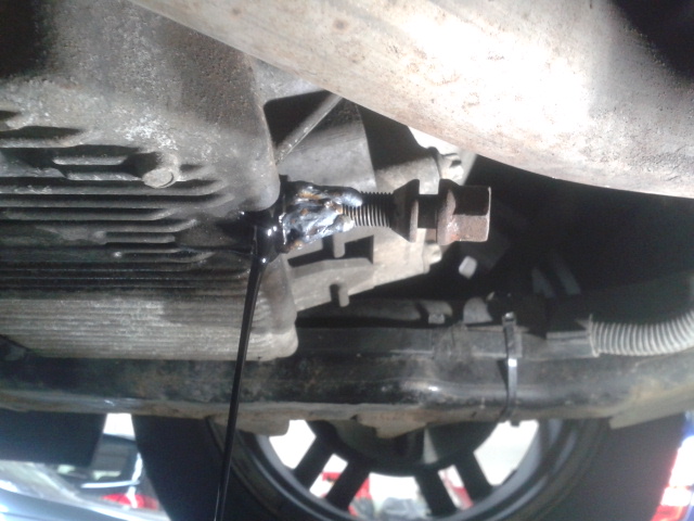

Then i remembered why i'd not done it, these 1.9 cdti's are notorious for seizing their sump plugs, and mine had been rounded off by a previous spanner monkey.
Easy enough, welded on a 17mm bolt and crack it off with a breaker bar.......er, no. The only thing that cracked was the bolt.
Fuck it cranked up the power on the mighty mig and used a wheel bolt and scaff bar with the thought at the front of my mind that i'd peel the ally sump off.
Success!
