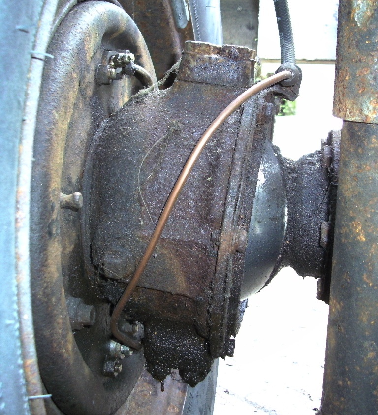

If it's the front that's troublesome, some people have re-plumbed the pipe work so that the bleed nipple is at the top. I'll find a picture if you want.

All the brakes have been adjusted. Its a silly Idea having the bleed nipple at the bottom :(
I suppose all I need to do is join the flex to the bottom cylinder, then put the nipple at the top... It could work. or a can of petrol and a lighter...

Hopefully the owner of these pics won't mind me sharing.

I might just change the brake pipes to support a nipple at the top.

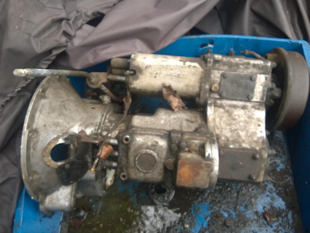

One of our diesel fitters at work is looking for a series 3 gearbox.
If you know of one, or indeed have a spare one yourself that you want to part with, give me a shout please.

I have a series 3 gearbox available right now.  Come and get it!     The main box is said to work, but there is a reported problem with the high to low switching,   Details of fault unknown.  Make me an offer?

I will do some price research and have a think, discounting for the reported fault.  This box was on a 1976 petrol  (no overdrive) and had done about 88,000 miles before it was taken off because of difficulty selecting high and low ratios.
Series 3 boxes are synchro.
The Hi Lo problem will probably be rusty selector shafts in the transfer box.
Easily fixed by taking the tin hats off the front of the transfer box. The shafts come through the casing and can rust through lack of use. Clean up and work them free.
