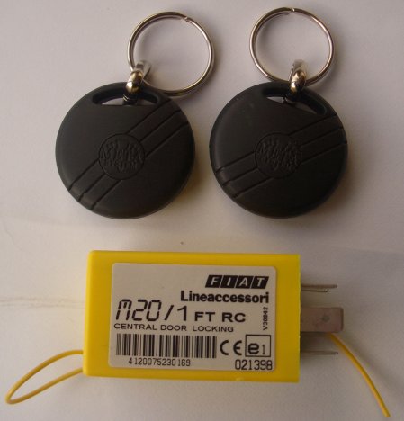

Barry Cade Posted April 4, 2012 Posted April 4, 2012 If anyone has a Fiat with key central locking, pop down to your local scrappies, and pick up the relay and keyfob from a scrap car with remote locking and plug in the new relay in place of your original central locking relay. Now you have remote locking works with Seicento, Punto Mk1 and probably more...
Lankytim Posted April 4, 2012 Posted April 4, 2012 Humm, this sounds daft but could that work with any car with central locking controlled by a relay?

Lankytim Posted April 5, 2012 Posted April 5, 2012 I can't find any of those fancy fiat central locking relays for sale online...... May check the local scrappies tomorrrow. I'm sure that it could be adapted to fit anything with a bit of crimping and connector action. Maybe.
