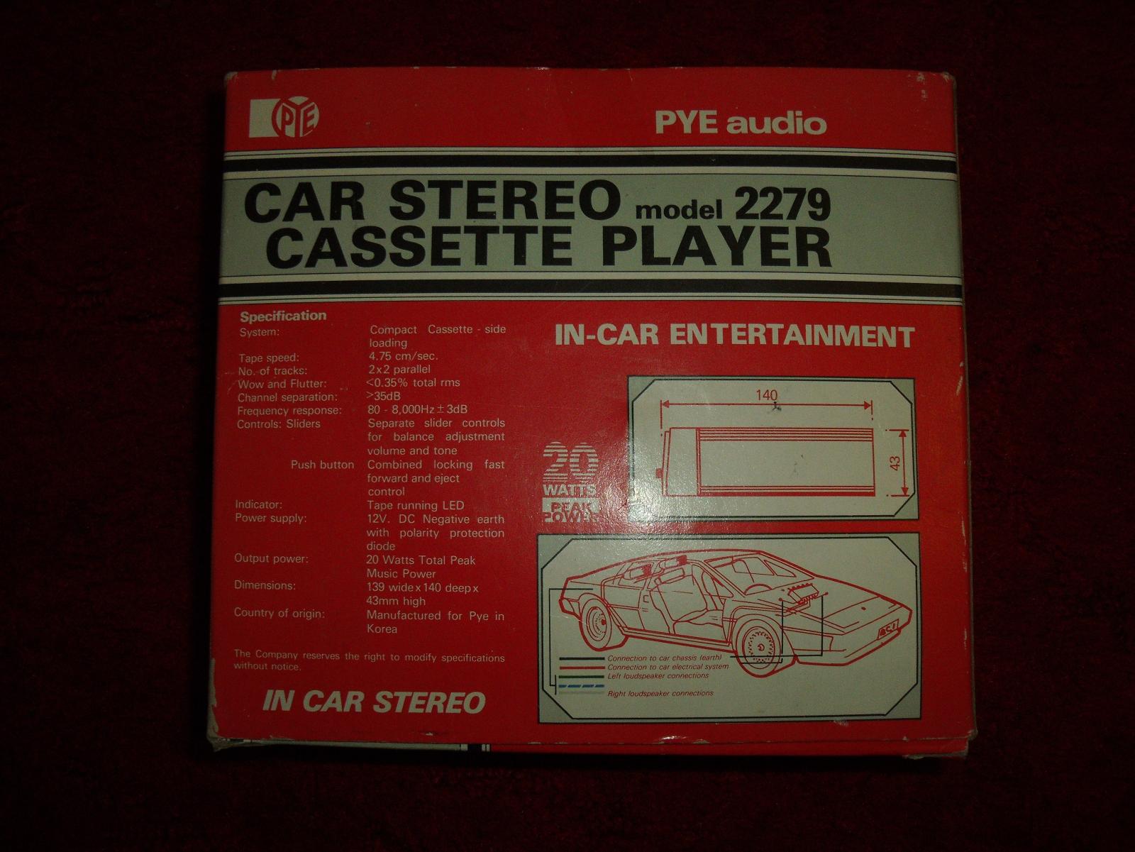

Eddie Honda Posted February 3, 2017 Posted February 3, 2017 Mmmm PYES! Look at the back of the box - note outline of other wedge shaped vehicle usage. I've got a BNIB 2279. Bought only because I had fond memories of having one before in my old Wolseley 16/60 auto (later being transferred to Reliant Rebel no 1) passenger: I wanna here that song again. me: [ejects tape, flips it over and has to fast forward to find the right place using skill and judgement if not track 1] Edit to add: It was also fitted in my Mk1 Austin 1100, with gaffer tape to the bottom of the case to insulate it from the metal strip on the under-dash parcel shelf, because positive earth car. Joey spud, Vince70, Craig the Princess and 1 other 4

Eddie Honda Posted February 3, 2017 Posted February 3, 2017 the PYE tape deck (not sure what model but it has an impressive* 10Watt output!) 10W Peak, 0.00000001W RMS. It's a 2278, the little brother of my one,

meshking Posted February 6, 2017 Posted February 6, 2017 10W Peak, 0.00000001W RMS. It's a 2278, the little brother of my one, Awww, that brings back memories. My first car had one of those fitted. The car was a yellow and black 2CV charleston, which is still kicking about in the club. The tape deck was useless, you couldn't hear it on the move and when you stopped you wouldn't want to hear it through its single speaker mounted on the front parcel shelf.
