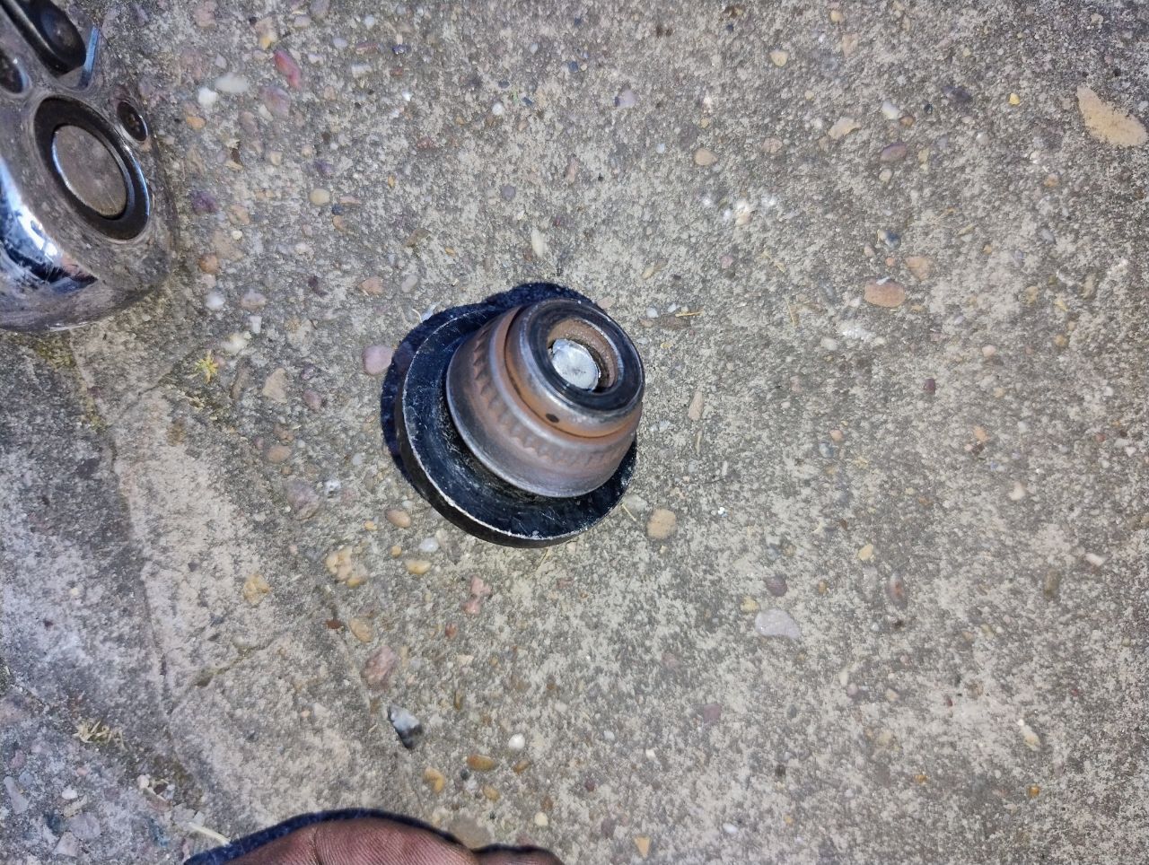

I've bought a few bits for him as an early Christmas present and finished off my drive shaft bolt as a temporary measure.
It ultimately would have needed abs ring which I failed to do, haldex repair, exhaust repair and 2 tyres, quite a few other bits.
In time and money it would have cost me too much as I'm not blessed with time and car mojo at the minute.
Got an Adam to replace Big Joe.
Drive shaft bolt misery while pissed up. Extractored while hungover.
Driveshaft didn't budge and car also needs a timing belt and waterpunp.
When it snapped I was in a rage and pissed up and rung car take back.
