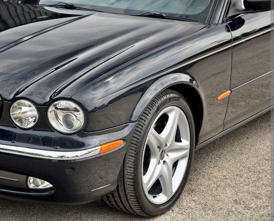

When the new Jaguar X350 XJ8 was launched in 2003 it did not sell in the numbers predicted - and Jaguar facelifted the design twice to improve sales.

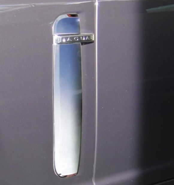

The X358 2007 second facelift acquired dummy wing vents - something not seen on a Jaguar saloon before.

odd that they were dummy trim panels.  Sir William would never had condoned such a thing !
I cannot imagine sitting in the golf club bar bragging about my new car's dummy wing vents :whacky055:   .. mind you that may be because I don't play golf, nor do I frequent Golf club bars.  :eek:

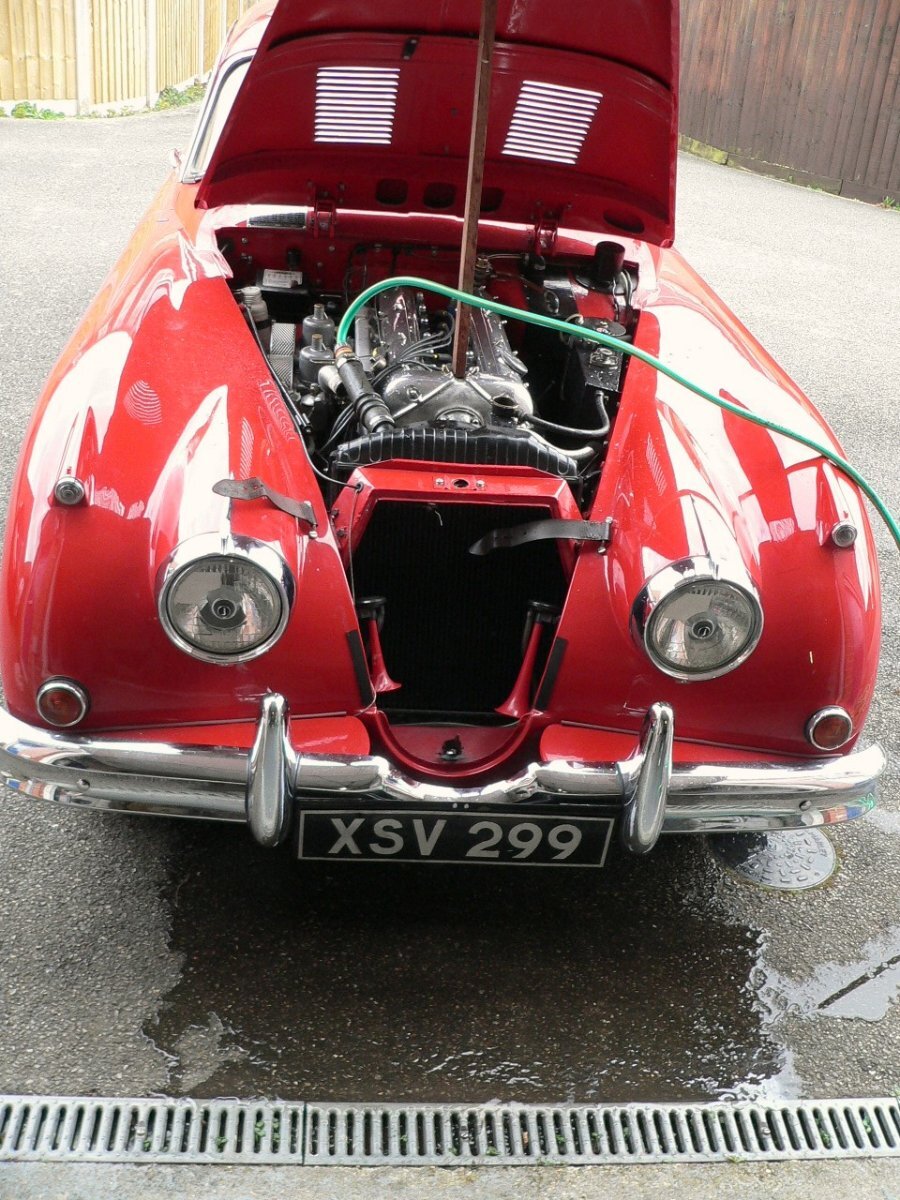

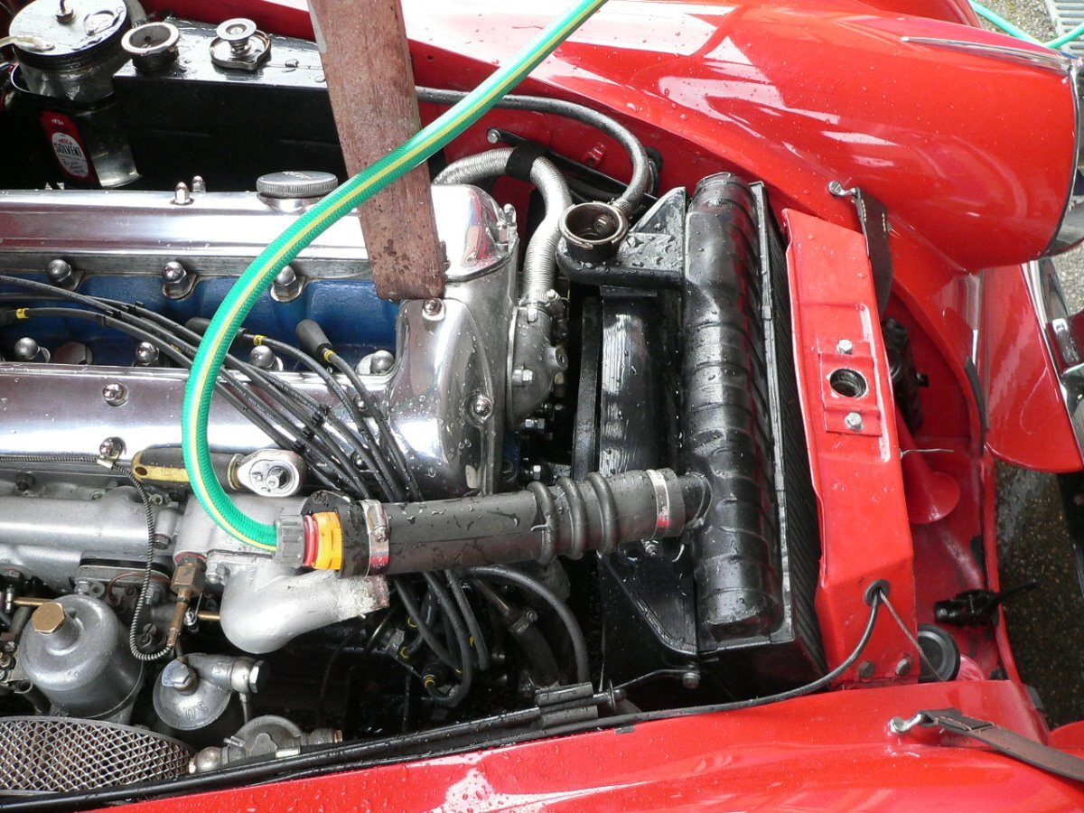

^ First job was to drain and flushing the radiator.  I didn't want to remove it, to shake it out ..that'll come soon enough but on another occasion.
P1070572.thumb.JPG.b20596a7cb704a06d54e140e192ef32a.JPG   P1070560.thumb.JPG.0896b2d0ccf5701773557430bef306e0.JPG

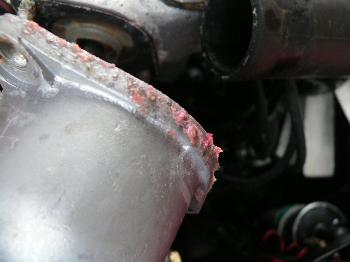

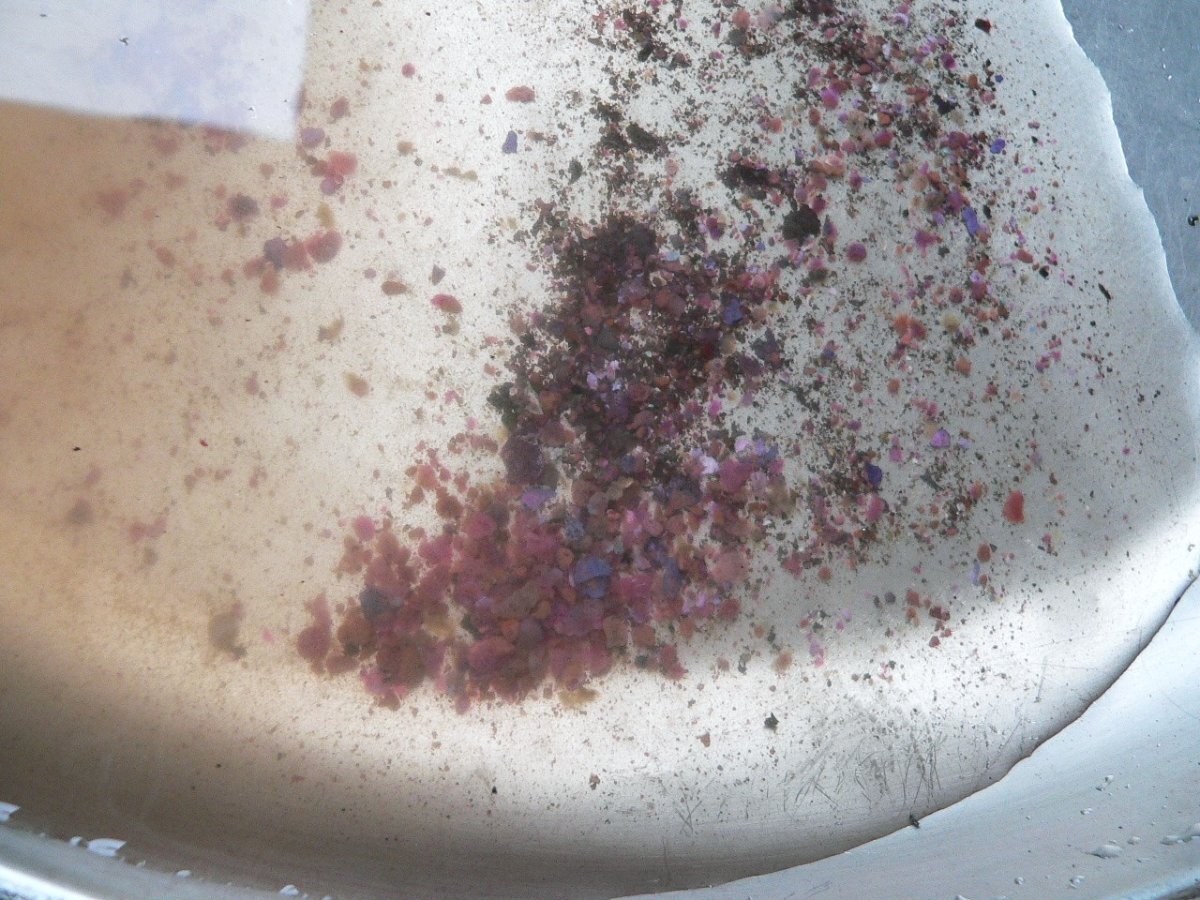

^ after the initial draining of the pink antifreeze coolant, I emptied the stainless steel tray, under the car, and just used the hope pipe in through the top hose to flush the radiator a bit.  This is what came out, pink and blue and black bits.  I'd guess the darkest particles are rust from the engine but the more colourful bits are unfamiliar to me.  There's also pink encrustations around the thermostat cover.  I don't know what's happening there.

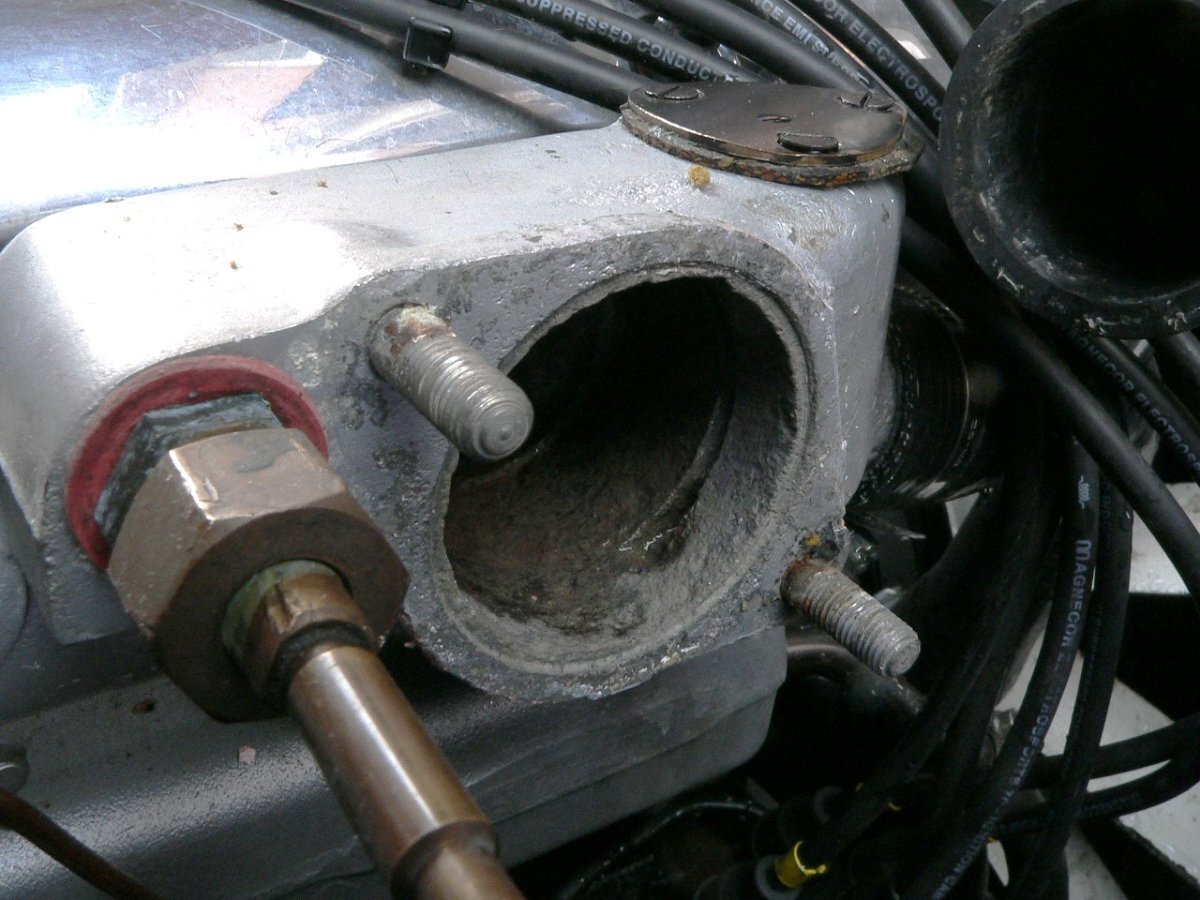

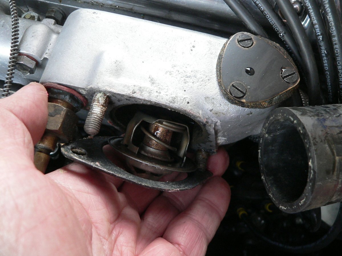

Can't find it now, but I seem to recall reading about / discussing the original sleeve type thermostats here on the TR Register forum, and how ; as the thermostat opens, its sleeve advances to restrict the slot in the housing, which leads to the radiator's by-pass hose.  In doing so, the hot engine coolant is directed through the radiator to be cooled.  I'd pulled Carmen's thermostat ..and it was not of the sleeve type  . . .and there was no restriction to prevent the coolant following the bypass route rather than going through the radiator.

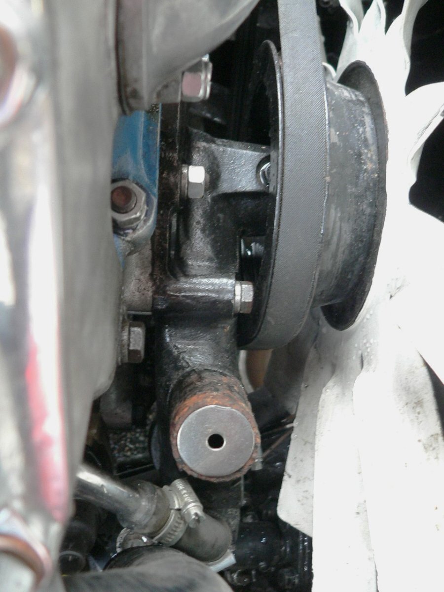

Following Joel's suggestion I did much the same . . .

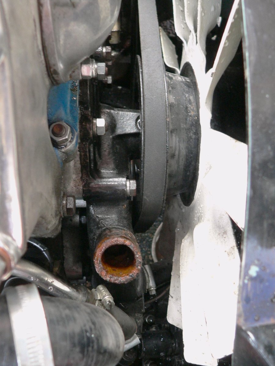

P1070569.thumb.JPG.bee9324d804506f28f1820c73d0da111.JPG   P1070570.thumb.JPG.427ca37f366aa59bfb161e4feafa3dd0.JPG
^ a 6mm hole through a stainless steel 30mm outside diameter penny washer was very suitable to be "placed in the bottom of the by-pass hose"  ^^ it's just loosely resting on the water-pump's spigot, and when the rubber hose is refitted, that washer cannot go anywhere ..so it doesn't need any fastening or adhesive.   Joel used similar but with a 1/8" hole, but I thought I'd give this a try.
I'd be glad to hear your thoughts re. this 'mod' ?

With the restrictive washer in the bypass hose, the cold start was normal, and I think the warm up was quicker (to when the thermostat opens).
Before restarting the car I've tried to bleed air out of the car heater's matrix by lifting up its top hose ..and I've easily pumped water through the matrix.  But in trying the car around the block - the heater still doesn't work. !
I've expressed my concern before, that this car is mechanically noisy.  I couldn't hear clearly when I bought the car because the engine was running too fast, the carburettors / the engine was unbalanced (rear carb was far too rich), the axillary cold start was hissing, and there were no air filters to stifle the sound of the intake roar. Furthermore the fan belt wasn't running true, the coil was bouncing all over the place on its home made bracket, and the cooling fan was catching on the radiator shroud, and the bonnet trim was loose.  One by one I've been working through those, and finally the cacophony of extraneous sounds are lesser and more distinct.  And working in those confines I noted excessive slack, of the wrong kind, in the water pump's bearing.
A good amount of the engine noise is I believe excessive tappet clearances (a larger than standard spec gap is liked by racing types).  I'll need a shim set before I open up the rocker covers, but I'd like to reset the tappet clearances sooner rather than later.  And it now seems that a noticeable amount of noise must have been the water pump's bearing (it sounded as if the cooling fan was still catching / loose / out of balance and reverberating / a blade was perhaps cracked ?).  But this is very encouraging .. because (having eliminated the cooling fan from the list of suspects) I feared the timing chain & its hydraulic tensioner must be the issue.  Hopefully though, it's just that the water pump's bearings. All being well, that'll be sorted soon.
As it is, the water pump now sounds quieter and the sound of a rattly bearing race is more clearly defined. I might only reason ; the lesser noise is because the restrictive washer I fitted - prevents the coolant from flushing around n' around ..and the pump now has some resistance to work against (drawing the engine's coolant through the radiator core).
