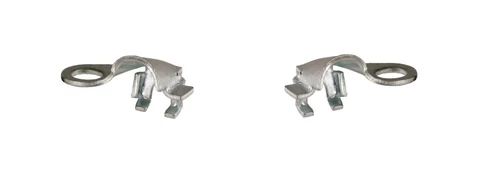

On another note, it seems the guide tubes I need are a bit weird. It looks like they bolt on, rather than just being a slide-in tube. Here is what my backplate looks like:
and here's the backplate of another car someone's breaking in the US, showing the guide tube bolted in using the bolt you can see below the handbrake cable in my pic above:
Mystery solved - the missing parts are Beetle Handbrake Cable Support Brackets, p/n 113-609-637+638, available for a tenner the pair on Ebay:
https://www.ebay.co.uk/itm/186330864381
Beetle Handbrake Cable Support Brackets Pair 1958-1979 - Picture 1 of 1
Result!!!
Result!!!
I can't recall who it was up thread that gave the cross reference codes, well the start codes, but they must've saved you a fortune on parts or at the very least given leads on alternative sources.
