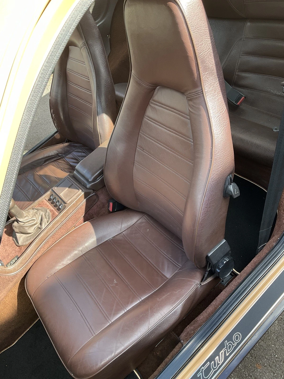

Managed to pick up a nice brown leather interior:
Picture 1 of 3
Snag is it's in Retford.
Anyone heading vaguely south west from there at some point soon who might have room for front and rear seats please?

Seats home and ready to go in:
They're really nice and will do a lot for the interior, and my arse.

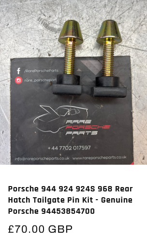

A plague upon the pilfering bastard who robbed loads of bits off my car. I've found another two things they've nicked:
the opposite catch to this one on the NS of the car is missing, as is the plastic plug / screw thing that goes above it:
Cheers for that. Plus they're pretty elusive in the parts PDF.
You know what, that looks an awful lot like it's the same as another car we've talked about in this thread...
Classic Volkswagen Beetle 1869 On Back Seat Latches Genuine OEM | eBay UK

You're right! It's p/n 111867330A I need, which is the RH latch.
Let me know if you turn one up and I'll send you some ££ for it, especially if you've still got the chunky screws 😉
