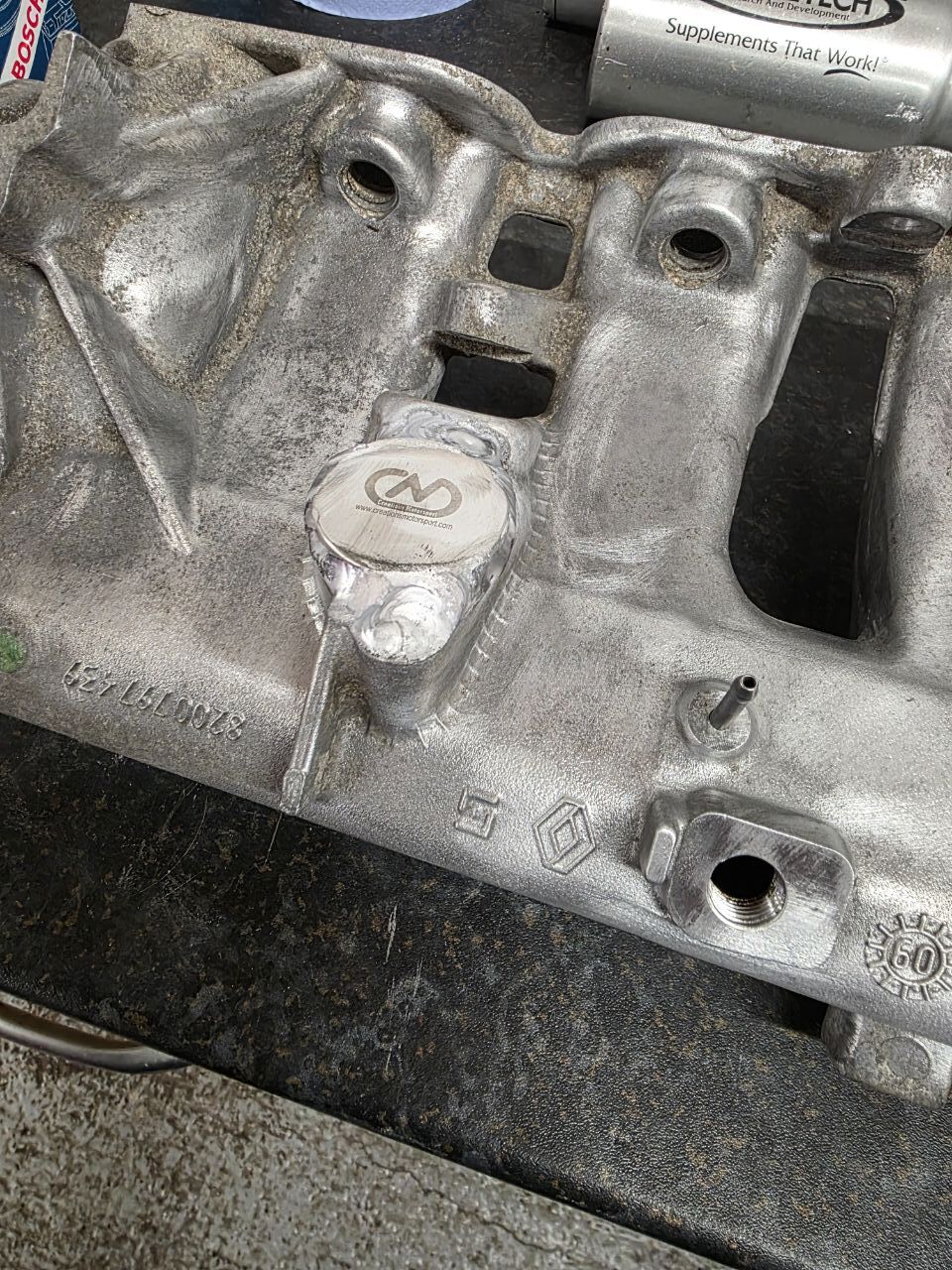

Also more prep to my modified inlet manifold for my megane engined Kangoo. Ive removed a few unecessary bits of casting for brackets and plugged the hole for the breather with a bung.20260223_143244.jpg.2693351103824256a2e487708fb5ab11.jpg 20260223_143247.jpg.08c65ada00dab2d8b041c022c40beae3.jpg
The bung is more or less interference fit, but not chancing that at 2bar of boost, dropping it off at the welders tomorrow to be tig welded.

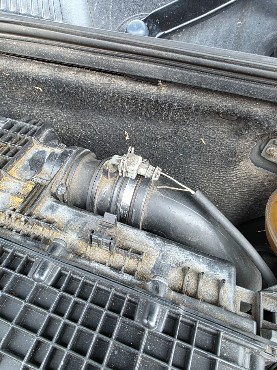

Noted iat fault whilst scanning which is a new one to me. Cleared all and iat straight back up.
Extended dtc data says
20260223_215032.jpg.e600f0dedf8cc90fa10fd50b2bf9a34b.jpg20260223_215017.jpg.7242ead86e675557942306d0508edaa2.jpg
Noted external air temp stuck at 25deg on live data so assumed related to pre turbo sensor as main iat sensor was reading ok and overall it was driving ok.
This week has been pretty hectic so no time to look, had a spare hour today so on it.
Engine cover off and looking at wiring to iat sensor, one side looked dodgy yet intact. Flicked it with minimal effort and it snapped off, could see corrosion on the wire so clearly the issue.20260226_144836.jpg.ee8e3c0218dfc459761170320668c3fa.jpg
Connector depinned, wiring stripped and new connector crimped on/refitted.
Checked live data and sensor readings moving as expected and not stuck on 25deg.20260226_150203.jpg.e2b0a6c5e4e927827f27aee7a95f4afa.jpg
Fault cleared and no return.20260226_145820.jpg.27669e566c8b7803ed5f6f8c3c44bf8a.jpg
Issues resolved in 10 mins, easy fix. Ive said it before and ill say it again, temp sensors rarely fail on these old renaults so always check the basics before spending any money. 90% of the issues are related to wiring.

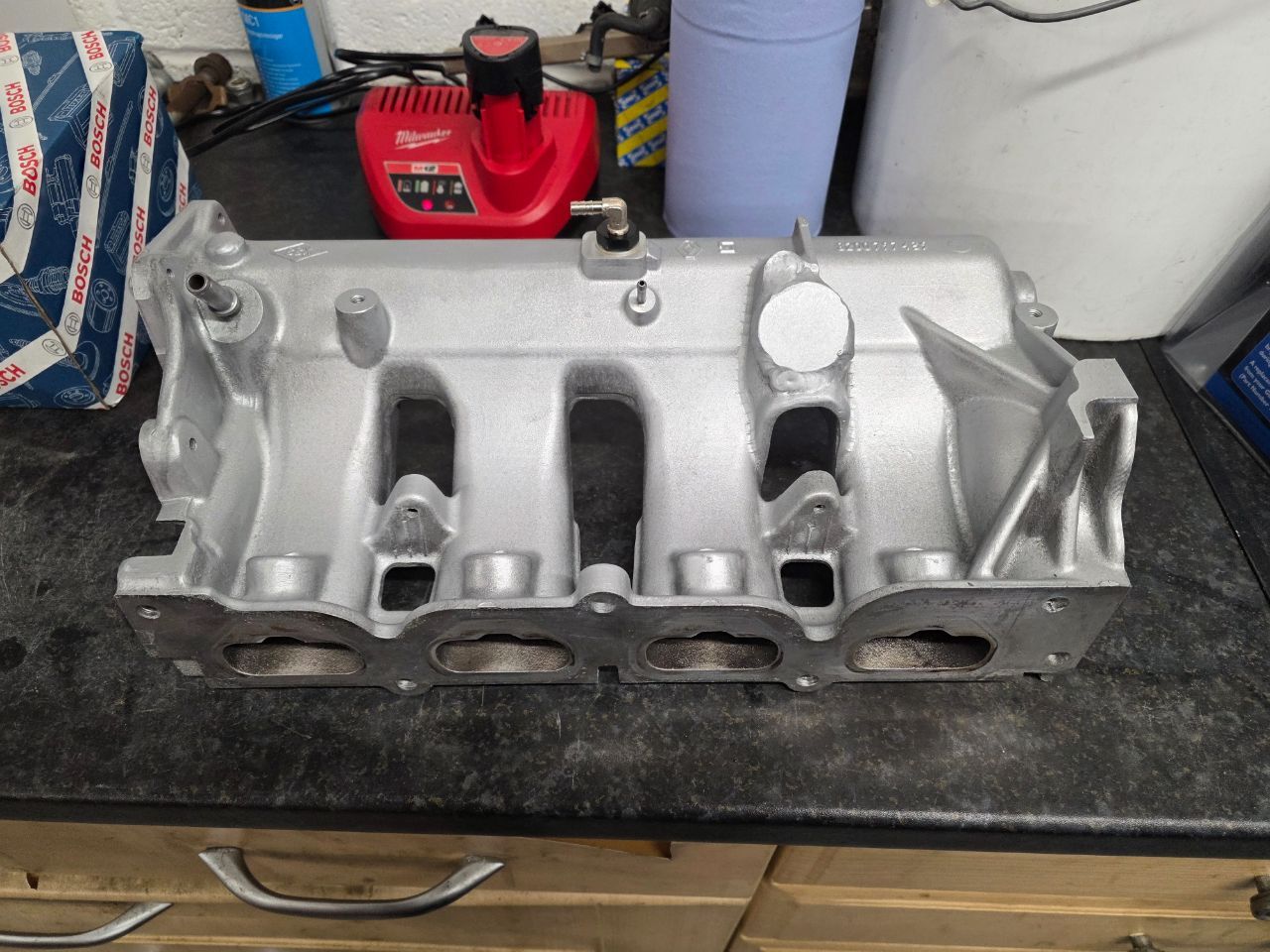

Kangoo compact update.
More mods done to the inlet manifold in preperation for ecu master black ecu upgrade.
Removed a couple of brackets that wont be used again to make the inlet look slightly better and tapped the oem map sensor hole to suit an adaptor for a takeoff for the new ecu. Also removed the electronic breather crap, plugged with a bung and welded.
20260226_141643.jpg.b04d42f70b02a6a8b936e739339e20a4.jpg20260226_140939.jpg.cacee1fc5afd8cdd0bb7c5794d18908d.jpg20260226_140944.jpg.14cc7203777c493cf1432901bef1c158.jpg20260226_141646.jpg.5f182baa6c533ad1619254074b35038e.jpg

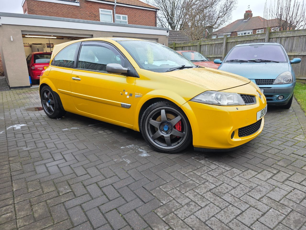

Got it out today for pre mot checks.
Plastics look mega.
Main reason for getting it out today was for mot pre checks. Being honest, it was checked after Cliosport festival Anglesey trackday in 2024 and its done hardly no miles since so didnt expect any issues, and all looks OK. Still solid in the right places for a 29 year old van.
920kg and it flys up on the jack.
With mot pre checks done, i started doing some pre dyno checks. Its booked in EfiParts for a map tweak later this month. Been meaning to do it for 6 years but never get round to it.
Anyway quick smoke test on the boost cct, to confirm no more inlet leaks. All good, no leaks.
Will get some road miles on it this week after mot, then look at oil change and brake fluid flush.

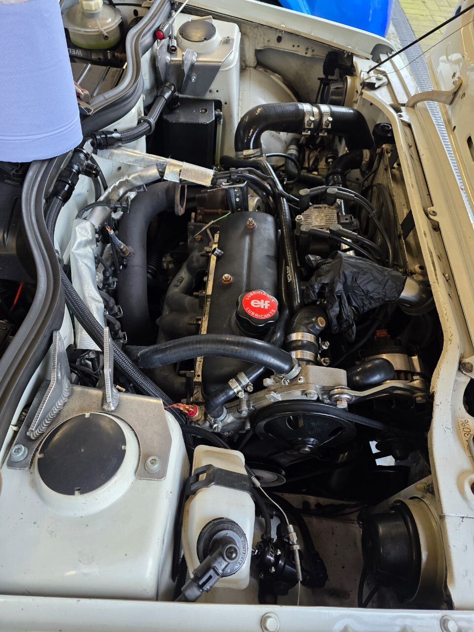

Megane 250 inlet modifications done. I removed another unused bracket on the front, cut the clearance required for cam sensor on 197 head and started to remove some of the oem renault casting marks. I was going to remove all the casting marks and smooth the lot, but stopped as its time consuming and not adding value to the setup i.e. going to add horsepower.
Give it a thorough clean up with brake cleaner and a stiff brush inside to remove any swarf. Pressure washed it out to finish. Masked up the ports, coat of vht aluminium and lacquer and ill call it done. Never be pretty but looks better than the stock 250 inlet.
Cam sensor clearance below, as 197 cam sensor is fitted in the head vs 250 fitted in the cam cover.
Bosch motorsport throttle body fitted.
Much better than oem rs250, original is 45mm and this is 54mm so should help with pressure differential pre and post throttle.20260301_165617.jpg.623ec874ee8d22056a63bc7f00fca520.jpg
Need to look at fitting the turbo setup soon.
