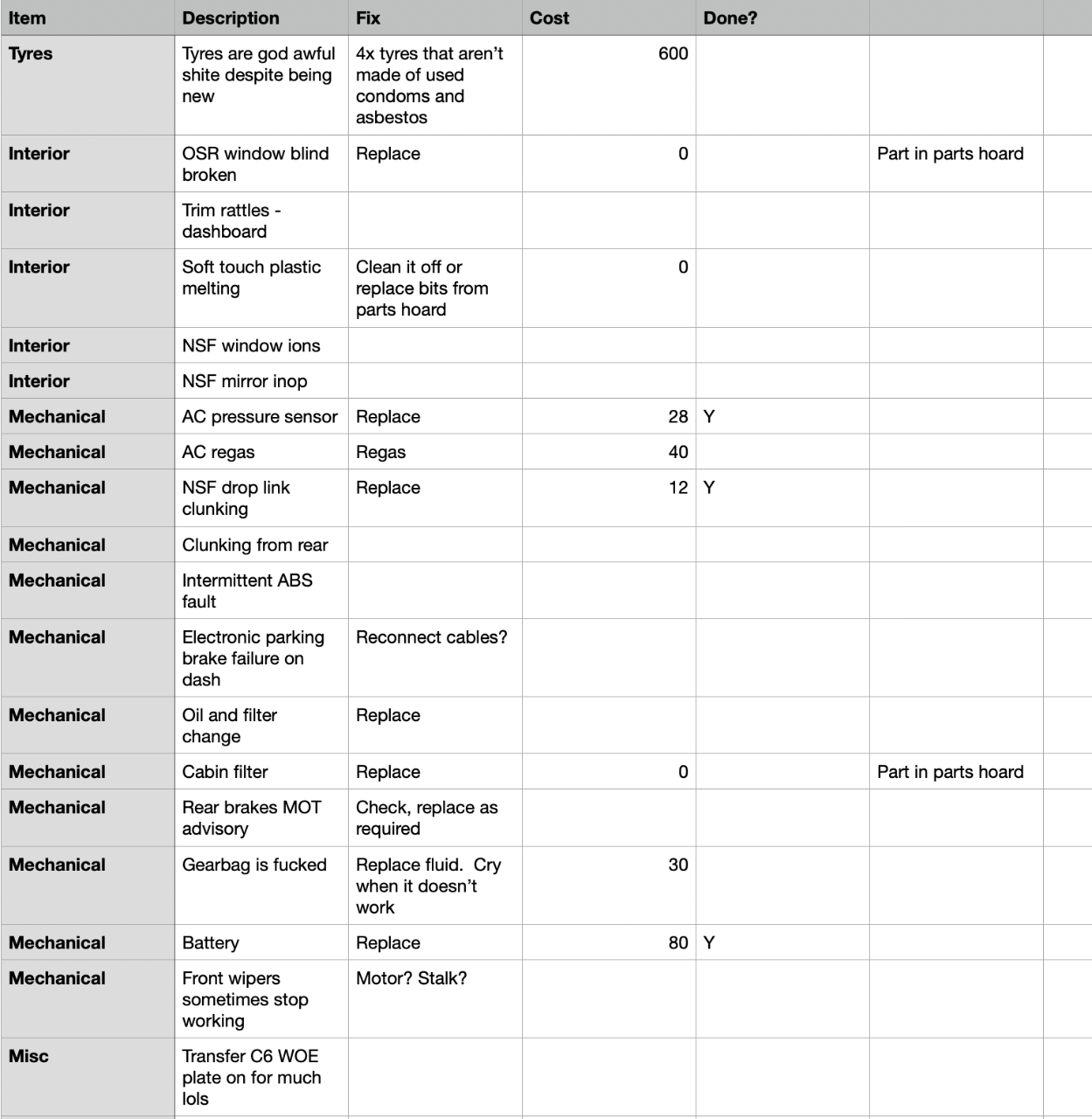

SiC Posted June 10, 2025 Posted June 10, 2025 PAS whine is a bit of a character of these. Probably worth changing the fluid though. Trim rattles ... 00s era cheap shitbox Renault 😄
Kiltox Posted June 10, 2025 Author Posted June 10, 2025 Just now, SiC said: PAS whine is a bit of a character of these. Probably worth changing the fluid though. Trim rattles ... 00s era cheap shitbox Renault 😄 It’s really bad, I’m pretty sure the pump is dying. SiC 1
Kiltox Posted June 10, 2025 Author Posted June 10, 2025 oh, I've left the line in about the rear brakes from the Clio - thankfully those appear to be fine at the moment, but you never know, Shatis, innit.
SiC Posted June 11, 2025 Posted June 11, 2025 Wipers I had similar on my Laguna II. If the body computer doesn't detect the wiper park switch when off after a few wipes, it disables the wipers entirely for that drive session. A really fucking annoying failure mode when out and about. Would have made more sense to just stop them after a time out, no matter where they were on the screen and allow the switch to to make them continue - like most other cars. If it's the switch then the body computer signal on live data should show if it's being registered. Kiltox 1
Kiltox Posted June 11, 2025 Author Posted June 11, 2025 10 minutes ago, SiC said: Wipers I had similar on my Laguna II. If the body computer doesn't detect the wiper park switch when off after a few wipes, it disables the wipers entirely for that drive session. A really fucking annoying failure mode when out and about. Would have made more sense to just stop them after a time out, no matter where they were on the screen and allow the switch to to make them continue - like most other cars. If it's the switch then the body computer signal on live data should show if it's being registered. There’s an entire linkage assembly in the parts hoard - is the switch removable?
SiC Posted June 11, 2025 Posted June 11, 2025 Just now, Kiltox said: There’s an entire linkage assembly in the parts hoard - is the switch removable? Dunno, almost certainly part of the motor. I replaced the whole linkage and motor assembly as Laguna II motor/wiper assemblies were easy to get hold of and cheap as chips. I guess less so for a Vel Satis. Wouldn't be surprised if the motor is identical to what is used on a Laguna though. Kiltox 1
SiC Posted June 11, 2025 Posted June 11, 2025 Does it have a sunroof? Laguna iirc was prone to drains blocking up and dumping water over the body computer. Which it really didn't like and gave weird electrical faults.
Kiltox Posted June 11, 2025 Author Posted June 11, 2025 1 minute ago, SiC said: Dunno, almost certainly part of the motor. I replaced the whole linkage and motor assembly as Laguna II motor/wiper assemblies were easy to get hold of and cheap as chips. I guess less so for a Vel Satis. Wouldn't be surprised if the motor is identical to what is used on a Laguna though. I guess given I’ve already got one I can skip that hurdle. SiC 1
beko1987 Posted June 11, 2025 Posted June 11, 2025 Can you take the arms off and see is just the linkage plays nice? Could be the blades dragging on the screen exacerbatingthe symptoms of something being a bit worn/fucked? If it still fucks about then it could be a smoll microswitch full of shite? I found the linkage assembly fairly easy to dismantle and lightly grease each joint and pivot on the qq but it won't help if it's all quite worn out. I'd imagine you'd need the arms off to get the scuttle plastics off anyway regardless 🤷
Kiltox Posted June 11, 2025 Author Posted June 11, 2025 8 minutes ago, beko1987 said: Can you take the arms off and see is just the linkage plays nice? Could be the blades dragging on the screen exacerbatingthe symptoms of something being a bit worn/fucked? If it still fucks about then it could be a smoll microswitch full of shite? I found the linkage assembly fairly easy to dismantle and lightly grease each joint and pivot on the qq but it won't help if it's all quite worn out. I'd imagine you'd need the arms off to get the scuttle plastics off anyway regardless 🤷 The wipers work perfectly fine when they work, and stop working completely when they don’t - ie they stay parked and flicking the stalk does nothing. I think @SiC’s prediction about the park switch sounds very plausible. No sunroof. It first did it in the pissing rain on the way home but has done it in long spells of dry weather too, which makes me wonder about the body computer in water theory. Probably worth checking regardless. beko1987 and yes oui si 2

Kiltox Posted June 11, 2025 Author Posted June 11, 2025 Seems that both of my fine 2002 vintage Renaults have some issues with their water. Have had to top both up quite a bit, it doesn’t appear to be pissing out of either but I assume there’s some kind of leak!
