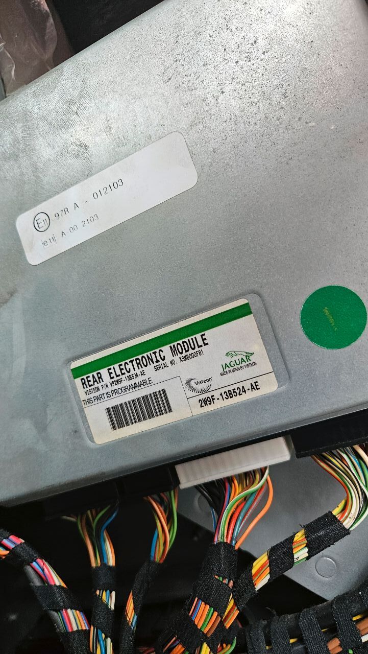

Popped over to @Jikovron at Reed Retro Motorworks to try and help with the electrical side of the Jag issues with the lights. Bought my laptop and SDD, but thought we would go through the basics first. So whilst Ron changed the rear toe arms on the BMW, I got to work stripping the jag apart.
Here she is sitting amongst the largest collection of BL steel I've seen in a while ( @motorpunk worth popping over before your GBCJ book event!)
Started stripping down the interior to check the module and the fusebox....
Not many wires back here....yeah right!
Rear Electronic Module code, Always handy to keep for any possible swaps.
Whats that I spy through the slatted vents??
A lot of wiring running all over the place in the car, and a massive earth lead that gets hidden between it all.
All looked reasonably ok, though I wasn't keen on that little rust coloured mark I could see through the vents in the fusebox, so stripped it down... and yeah, not good! Large rust stain running down to one of the relays/chips. The fusebox has an odd 'sandwiched PCB' layout, with two PCBs about 8mm apart seemingly soldered through both with components and wiring. The many pins around the outside were in mostly good condition, but there were some nasty sections covered in green corrosion. So a replacement fusebox and spare rear electronics module were ordered from AutoReserve Jaguar so we could try swapping one or both to fix the issue.
Ron swapped the fusebox over last night (though not before the Jag decided it wanted to keep setting the alarm off whenever the battery was connected..) and gave it a test run......
https://streamable.com/5qlh4o
Sucess! Turns out it was the fusebox causing the issue, as @DirtyDaily predicted. Only issue now is I still have an air suspension fault error. Car sits fine, rear OS may go down about half an inch over about a month of sitting, but that I wouldnt think would set it off. I did notice one of the front sensors was cable-tied in place, and the warning first came on after a reasonably quick change of direction and braking, so wonder if thats shifted a little. Shouldn't affect the MOT as far as I know though??

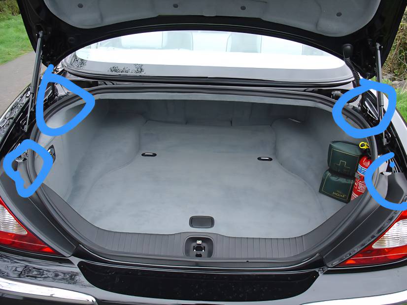

I would suggest checking around the boot lid ledge where there are seems as these are known for leaking sometimes. Also arounf where the lights meet the body, i think one of my old ones let moisture through there also. Awful description so picture for clarity. May be why there was corrosion? May not have been damp still due to the exceptionally warm dry weather weve had.dsc01467.jpg
The seal is pretty damaged on the top where the boot floor 'clips in' to hold it up @DirtyDaily. So might be getting in and around. Looks bone dry in there though. Could just be down to it sitting for about 2-3 years in total and not being aired out with driving etc.
